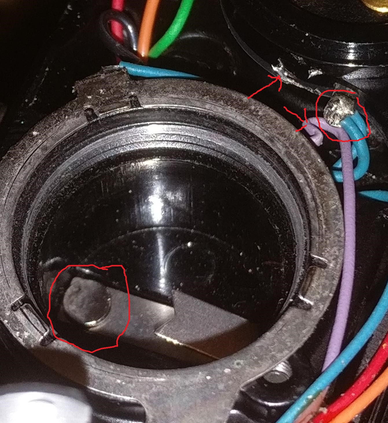

I took off the base plate. This is what I see:
Fe bottom https://imgur.com/gallery/35m6pBp
35m6pBp
It seems good looking, doesnt it?

Possible problems I see:
1. solder on the side of the motor drive socket. sloppy work from someone being in there before.
2. possible cold solder joint of the blue wires at the motor drive socket.
3. purple wire kinked, possibly broken internally.
4. center contact of the battery compartment where its braded to the contact strip is a potential failure point.
1 strand of a strainded wire will show continuity on an ohm meter but it will not carry enough current to operate the electronics.
The motor drive socket/contacts disconnect the camera battery from the circuit and powers the camera from the motor drive batteries. The contacts look lightly corroded from age and may be causing insufficient current from the battery from reaching the shutter circuit.

About the wiring, what would you do, Shutterfinger?
Thank you all for the support! It's magic
This is where I would start. I would flush the motor drive socket with electrical contact cleaner or disassemble it, clean the contacts and springs then reassemble it if it can be disassembled.
Next I would use a 25 watt soldering iron and remove the suspected bad solder then resolder the connection.
As for the kinked wire if the kink is close to the end I would trim the wire back just past the kink and resolder it to its terminal otherwise straighten the wire or replace it.
If you have never soldered before heat the wire and contact with the iron until they will melt the solder, apply the solder, remove the iron and allow the connection to cool without touching or moving it. Too hot will melt/burn the wire insulation. Only use rosin core solder on electrical connections.
