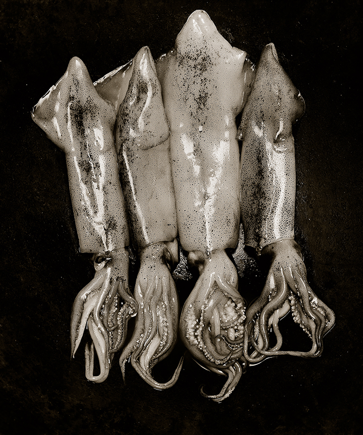

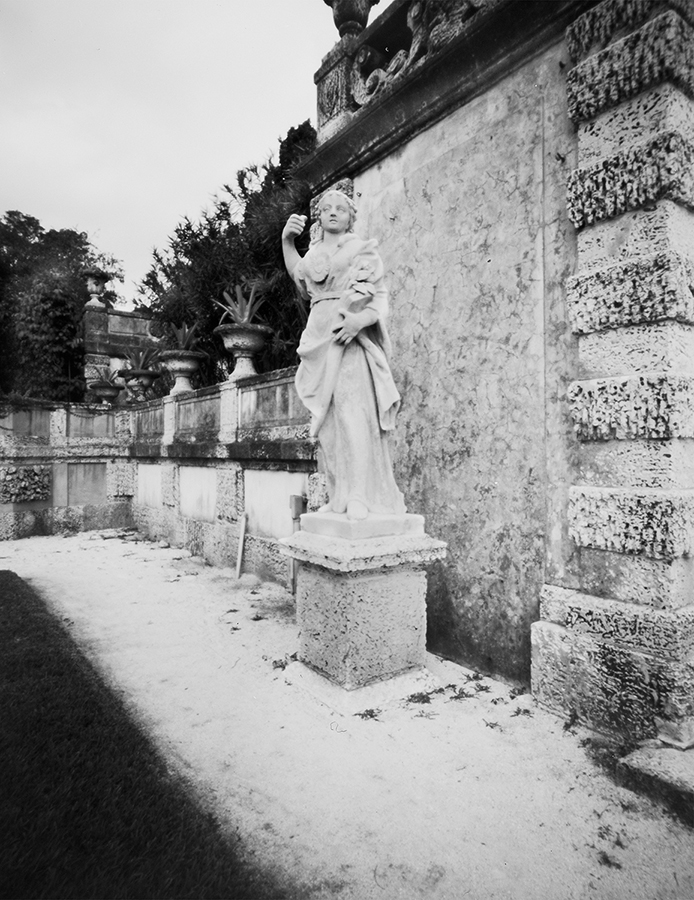

Why not try Ilford HP5. It's faster and you could probably push it a stop (time). I've used it for 4x5 for pinhole usually contact prints in pt/pd. All three on HP5 developed in Id11. Incident readings from Gossen Ultra Pro with the pinhole times from a dial calculator.
PT/PD PRINT SCAN Titan pinhole
NEGATIVE SCAN Titan pinhole
PT/PD PRINT FROM CAMERA NEGATIVE Toyo 4x5
Nice squid. That was my junior high dissection project.

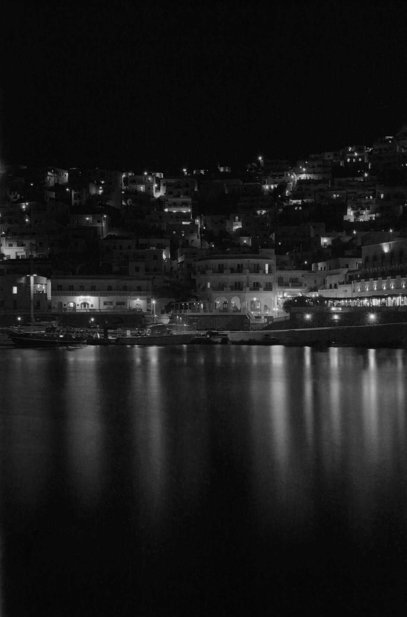

This shot at f/22 needed 10 minutes... it's on HP5+. I gave it 2 and it was thin. At 45 it would have been okay but you'd lose the deep blacks.
