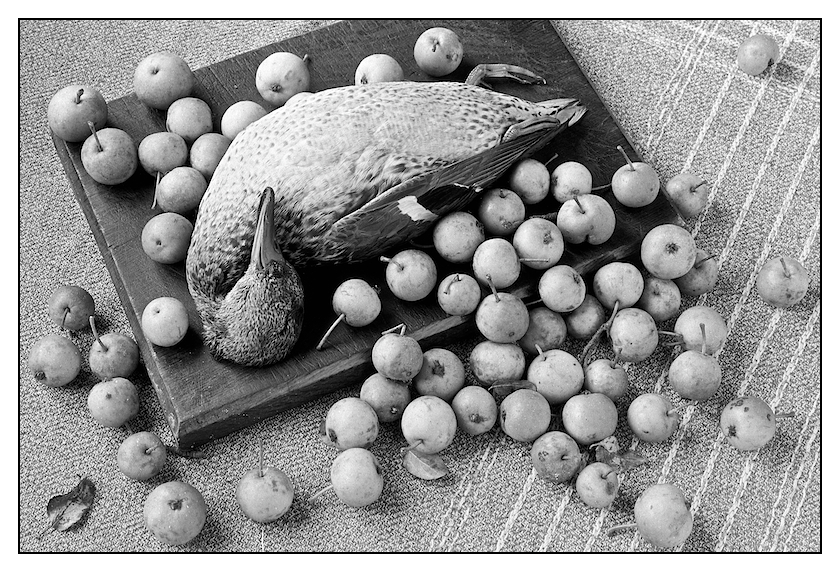

FP4 has been around since 1955. I took the picture posted above ("Duck killed by falling apples") about 30 years ago with some memorable Ilford advertising of the 1960s in mind - and because I happened to have a dead duck.:smile: Although sharper, finer-grained films are now available, I feel FP4 can still offer beautiful tonality with inconsequential grain size. Presumably that is also why Ilford haven't retired it.

You don't need to suggest anything, thank you. I've been around the block. The fact that a lot of older work is now being reinterpreted in excessively large scale for sake of effect doesn't necessarily mean that's what the original photographer would have wanted. Some did that kind of presentation in their own time, most didn't. I find a lot of it today just lemming mentality - following what others are doing at moment. But that's been the character of public art for millennia. Somebody builds a big marble coliseum for gladiator shows, and the next city over thinks they need an even bigger one. Same with medieval cathedrals. Now photos. I have every right to critique what I perceive as mostly a mere fad. Note that I stated "mostly", not exclusively. I remember when 8x10 color contact prints were the predictable museum fad instead, back in the 70's, whether done well or not (mostly not - many were miserably printed; but that itself seems to have been the let-it-all-hang-out "artsy" route at the time).

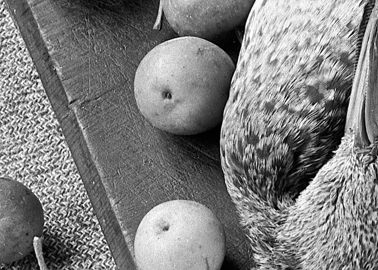

Juan, this is FP4+ in Perceptol, available window light. I'm afraid it's a edge-sharpened scan of the 35mm negative. The white specks visible in the detail are a dust problem in the scanner.
Gotta say, that is an absolutely gorgeous photo.
The tonality, the composition, the motif.
Reminds me of Roman still life mosaics and paintings of food, in it’s 2 1/2D ness.
