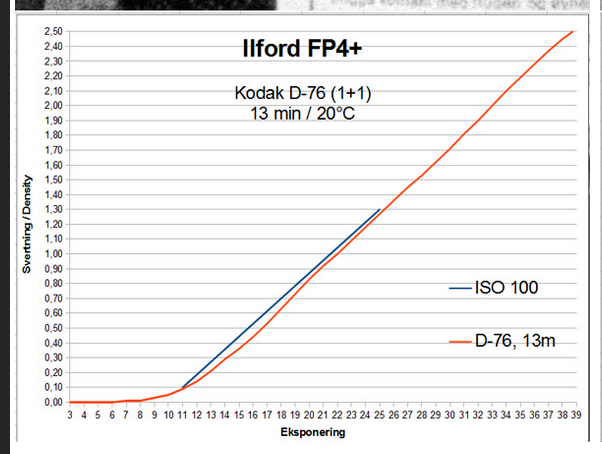

Here is the D-logE curve measured by the folks at fotoimport.no.
Compressed highlights ???
This can be found at https://fotoimport.no/fkd76, but by default you will see curves for TMax100, which is why I inserted the actual curve for FP4. Just to have the proper context, I reproduce the comment:
About the curve
The X-axis shows the density of film. The Y-axis shows the exposure, one step is 1/2 f-stop.
The blue straight curve start with the sensitivity point (D-max 0.1) and ends at D-max 1.3 over 7 f-stops. This is the part of the curve that are used printing on normal grade photographic paper. More information in the text block about test procedure.
So we have 14 f-stops of clean, straight curve. Compressed highlights...
