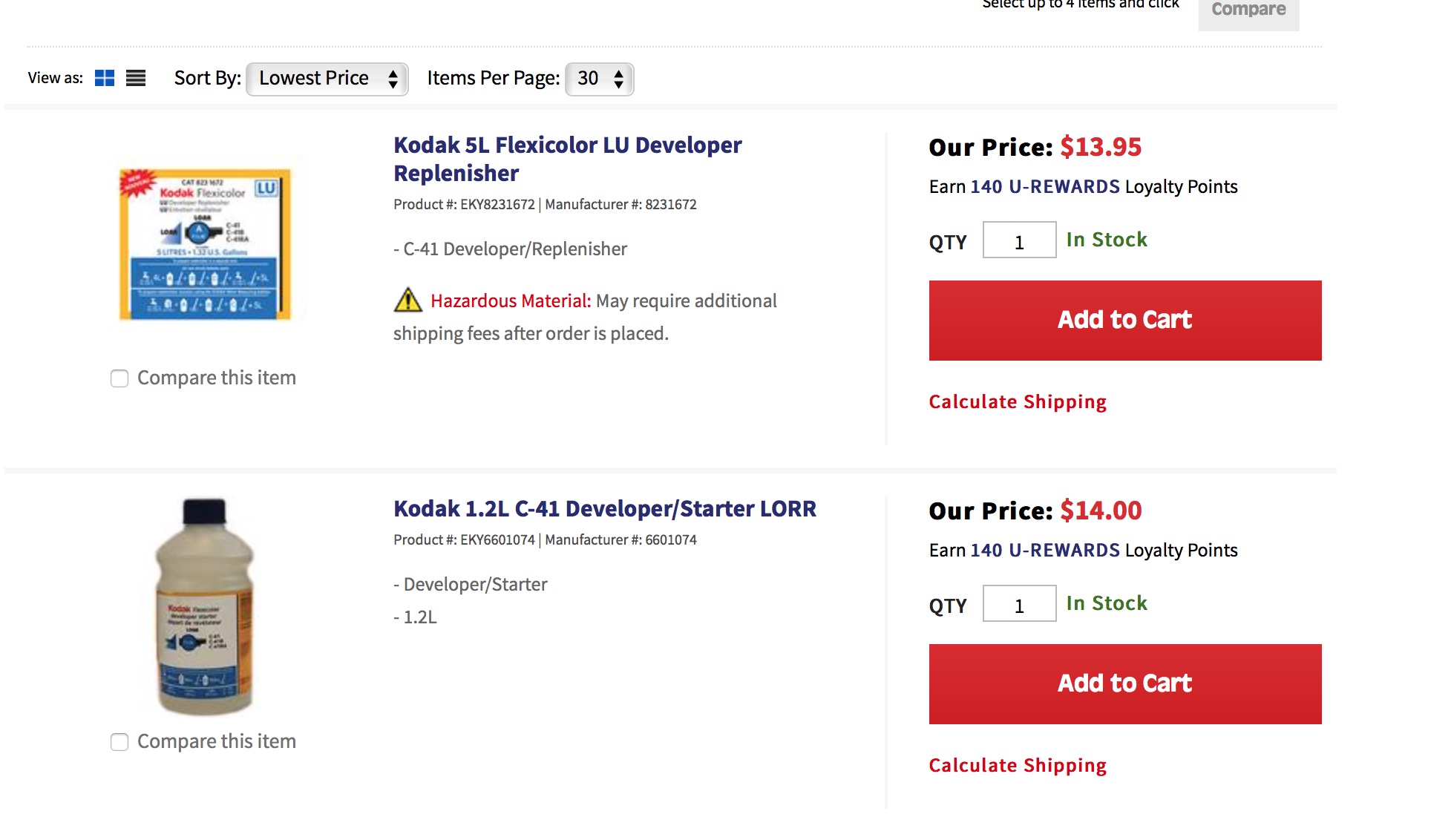

I am curious what developer you guys use from Unique. I have everything else covered, but need more developer. Do I just need to buy the developer? Or starter too? Forgive the basic question, but I have never mixed color chems.
Is this all I need? https://www.uniquephoto.com/product/kodak-c-41-entwickler-flxclr-devr-rplr-3667805
I think it's this.
Developer starter and Developer replenisher.
If you already have the starter then just get the developer replenisher.

I concur with @rpavich:
Kodak 5L Flexicolor LU Developer Replenisher
and Kodak 1.2L C-41 Developer/Starter LORR
Look at Kodak's Z100 for comprehensive information on which chemicals match which process based on your expected volume, or lack thereof, like me. I concluded LORR and C41 non-B non-RA was sensible for my color film needs. Whereas for RA4 printing, LORR seems to fit a higher-volume RT.
