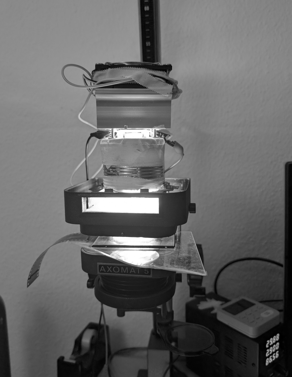

Hi all,
long time "lurker" here, I guess it's finally time to post something... It's gonna be a long post. What prompted me was the other thread about Svinotypes, but, though related in principle, I think my stuff fits better here.
Over the last couple weeks I wound up finding a way to UV-enlarge regular film negatives using cuprous chloride (CuCl). It's still WIP, there are many degrees of freedom and I'm not a chemist either, so please take everything I write with a grain of salt. Also I've only ever made a handful of 10x15cm prints so far... Here is the first one, before I figured out contrast control (silver toned):

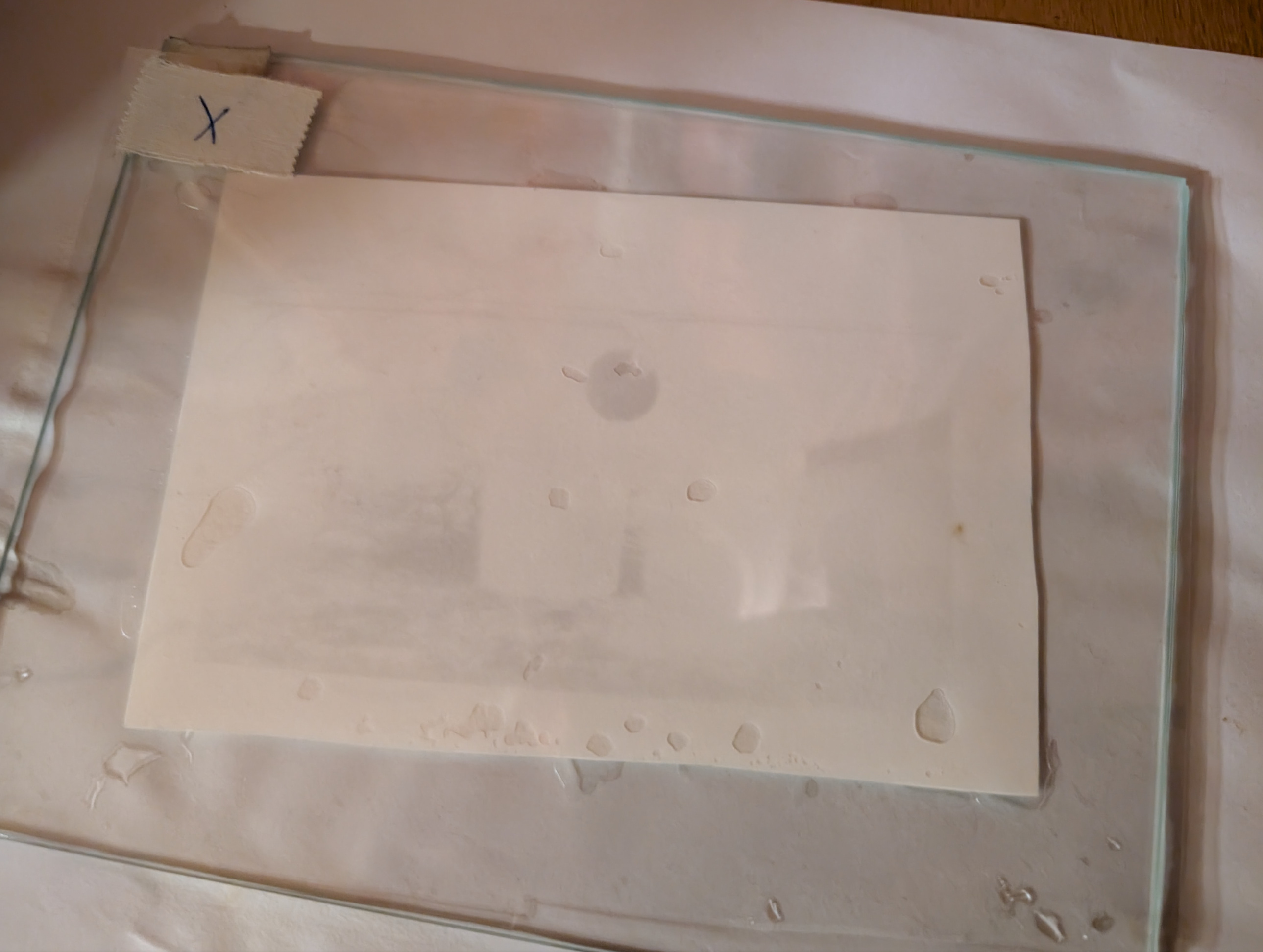

And here is how another print looks just after exposure (the air bubbles don't hurt much unless they get really big):
The key aspects:
CuCl, when wet, is directly sensitive to UV (the threshold should be around 390nm as per the band gap voltage). Let's call this "primary" exposure. Broadly speaking, this results in a disproportionation reaction: 2 Cu(1+) -> Cu(0) + Cu(2+).
After CuCl has been exposed to some UV, the spectral sensitivity broadens towards longer wavelengths. Let's call this "secondary" exposure. (For details check out B.Carlsson : "The photochemical disproportionation reaction in the system CuCl(s)-H2O(l)")
Now, if we expose using a mix of light that does some primary exposure and a lot of secondary exposure, the light sensitivity in strongly exposed areas will be higher than in the weakly exposed ones. In an idealized case this leads to a quadratic response curve, rather than linear. This principle is how we get sufficient contrast out of a silver gelatin negative. In fact, the contrast will be too high usually, so it has to be brought down by post-exposure flashing with orange light (which will further expose the image linearly in proportion to the underlying primary exposure).

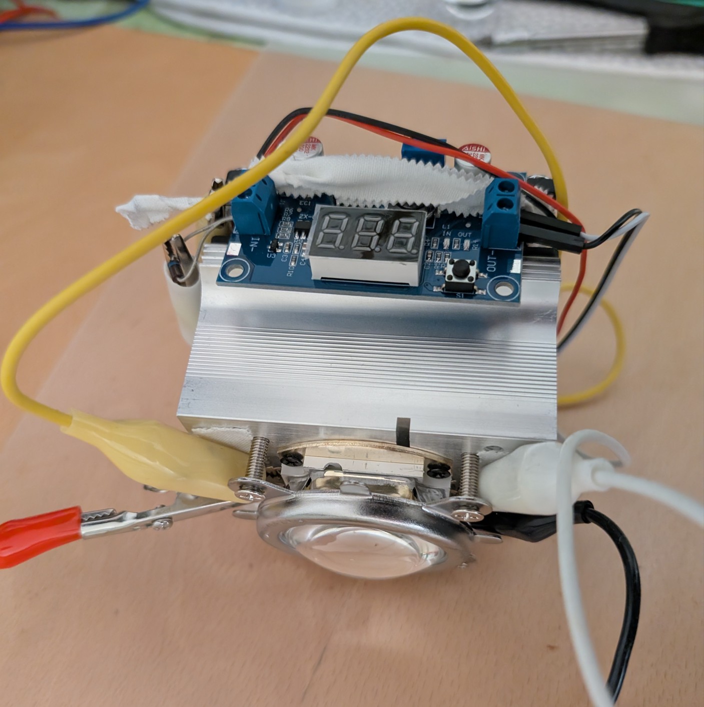

A 395nm LED works well for exposing, but blue (460nm) and white ("6000K") LEDs also kind of work, at half the speed at the same power.
The (under-the-negative-) speed is 30-60x faster than cyanotype (with a 395nm LED). With my UV enlarger with a 100W LED, this means I can expose e.g. for 4 minutes at f8 rather than 30 minutes at f2.8.
If you have very high contrast / digital negatives, you can probably add another zero to the factor, but then you need to increase the amount of orange light flashing, and sensitivity to ambient light increases.
Generally, the image should be faintly visible after exposure is complete. You cannot "print out" an image it seems, in my attempts it always faded in the fixer whilst a developed image is largely stable.
The developer is ascorbate at around PH 4 (as you increase PH, the developer gets faster but CuCl will decompose into CuOH). I think it mostly does "physical development", since I could not get CuBr, which is more light sensitive but far less soluble than CuCl, to develop.
You soak the paper in the developer already before exposure and keep it sandwiched between e.g. a glass plate and a laser printer transparency sheet to protect it from air until development is complete.
Developing takes about 20-60 minutes depending on exposure amount and room temperature.
Fixing can be done with regular rapid fixer, though I added some extra bisulfite to mine since the concentrate was past it's official shelf life. I have yet to check if increasing the PH will increase copper stability.
The copper image itself is very unstable (will already fade a bit during washing/fixing) and needs toning. What works reliably is silver toning with old fixer, this gives a neutral black image.
Sulfur toning looks promising, I haven't made any really presentable prints with it yet but my tests show no fading so far, at least. The resultant image is from yellow to dark brown, can be almost black.
So far the only paper I have used is "Herlitz Aquarellblock", student tier 150gsm watercolor paper.

The recipes:
As stated above, these probably aren't optimal yet.
Sensitizer:
10g CuSO4.5H2O
2.5 NaCl
10g Fructose (or 14g Agave syrup)
Water to 100ml
Developer - "Buffer" solution:
20g NH4HCO3
80ml 10% Acetic acid (vinegar)
Water to 1l (1000ml)
Developer (for 1 10x15 print):
10ml buffer solution
0.8g Ascorbic Acid
Fixer:
Commercial paper strength rapid fixer. I've been using it one-shot so far.
Silver (Black) toner:
Old fixer with silver in it. Pretty trivial to use as it will not produce stain with improperly fixed prints. If toning is incomplete, the shadows will turn yellow after 1-2 weeks.
Sulfur toner:
Wear gloves and eye protection when mixing and handling this!
Work in a well ventilated area! This will emit some hydrogen sulfide, especially if the PH of the working solution gets too low.
Do not store this in a PET bottle, it will start to leak eventually.
Actually I ballparked the amounts for mine. What should work:
80ml Water
20g NaOH
10g Flower of Sulfur
Water to 100ml
The sulfur takes about two weeks to dissolve into the caustic lye at room temperature.
Mix 1+50 with (warm to hot) water and pour onto a thoroughly fixed and washed print, tone for about 5 minutes. Have not figured out an optimal washing routine yet, the thing is that in principle the toner will spit out sulfur if diluted too much, so an alkaline wash may be necessary first.
The process:
Coat the paper with the sensitizer, I use 3ml for a 625cm2 (DIN-A4) sheet. It is not light sensitive yet.
Let it dry completely. The color should be pale green.
Optional but recommended: Heat the dried paper, sandwiched between copier paper, for one minute with a clothes iron at temperature setting 1.5 of 3. This will shift the color to a very pale beige if done right. Getting the movement right to avoid overheating takes some practice, basically it's moving the iron in circles whilst also rotating it.
This pre-converts most of the CuSO4 to CuCl. The developer would later also convert the sensitizer to CuCl but I think this way gets us a slightly higher DMax, since the wet conversion takes a couple of miliseconds, allowing some sensitizer to travel out of the paper or to deeper parts of the paper before converting. This was a massive issue back when I was using plain AA solution, the buffered version reacts much faster.
Make a puddle of sensitizer on a large glass plate, place the paper face down, move around until covered.
Brush sensitizer on the back side (or make a puddle, bend the transparent cover sheet and use that to cover the back side).
Flip the paper, pour on some more sensitizer, move the puddle around for at least 20 seconds across the entire paper (I use the bent cover sheet), otherwise you may get uneven development.
Place down the cover sheet on the paper, gently squeeze so there is an even layer of sensitizer everywhere.

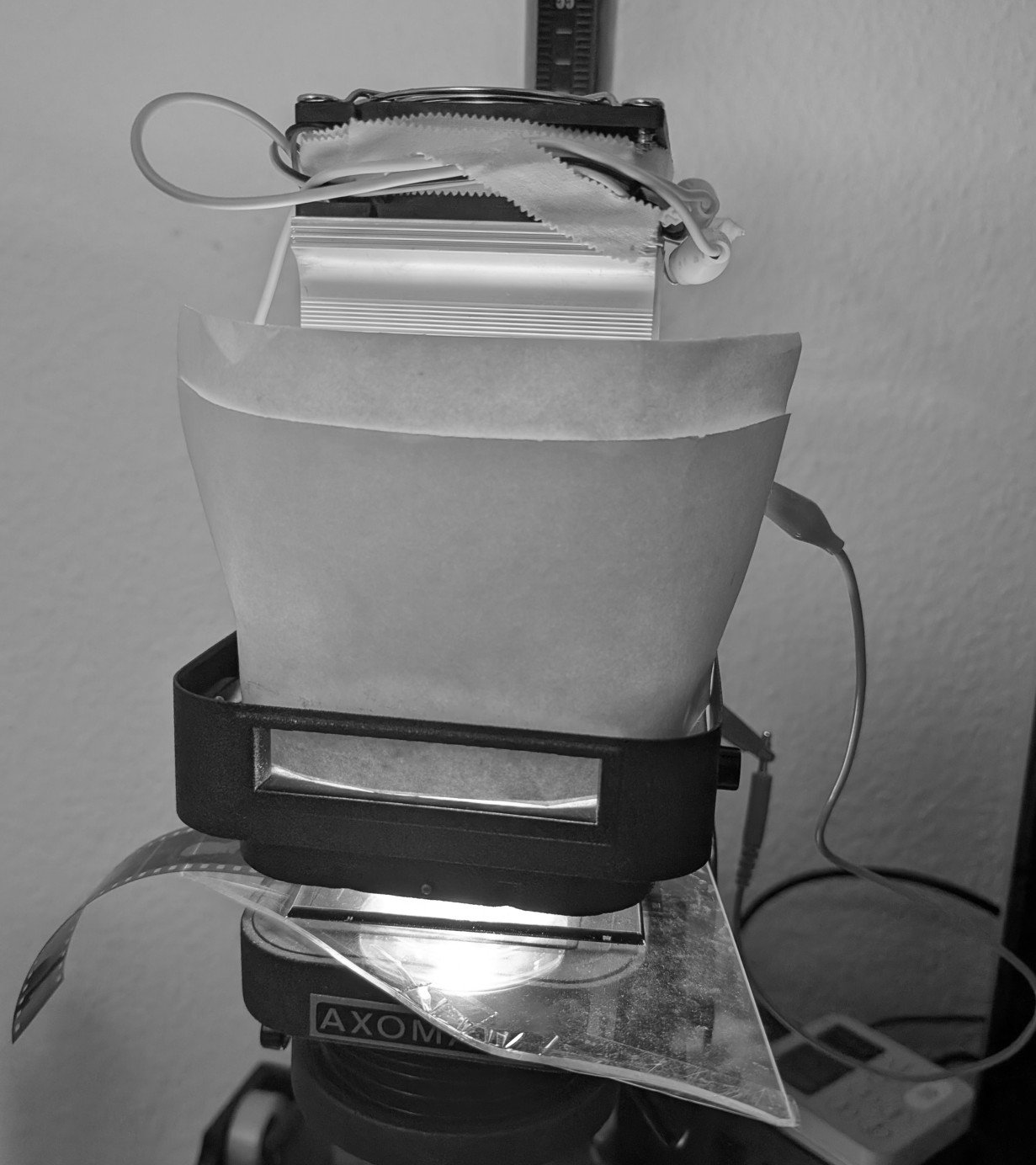

Expose under negative, as stated above the speed is 30-60x faster than cyanotype with a 395nm LED source.
When contact printing, make sure to avoid any contamination of the negative with the developer, which will readily spill out from the sides.

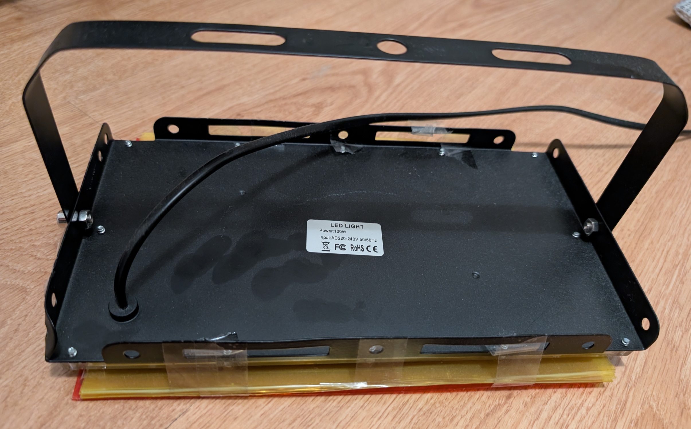

Flash with yellow to orange light quantum satis, you will have to figure out the right amount by trying (this is quite time consuming in the beginning, since you only see the final result after an hour).
I use a white LED floodlight and a stack of 6 yellow and 2 red gel filters. Unfiltered white light will cause fogging.
Cover the sandwich with e.g. old newspaper to avoid further exposure.
Let it develop for 20-60 minutes, take a peek from time to time
Rinse, briefly fix, silver tone, wash, dry, or
Rinse, fix, wash, sulfur tone, wash, dry.
That's all, for now. Have fun!

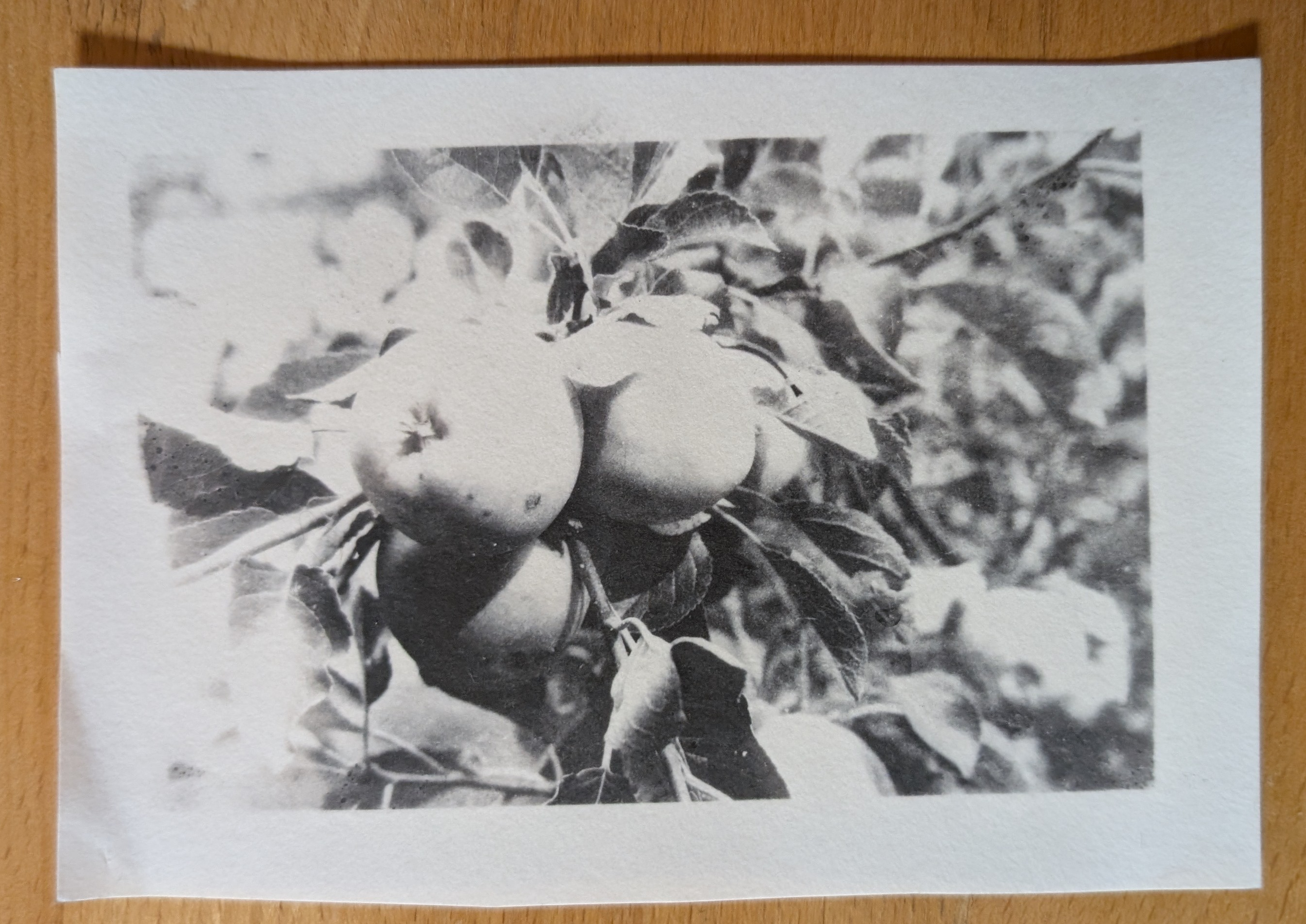

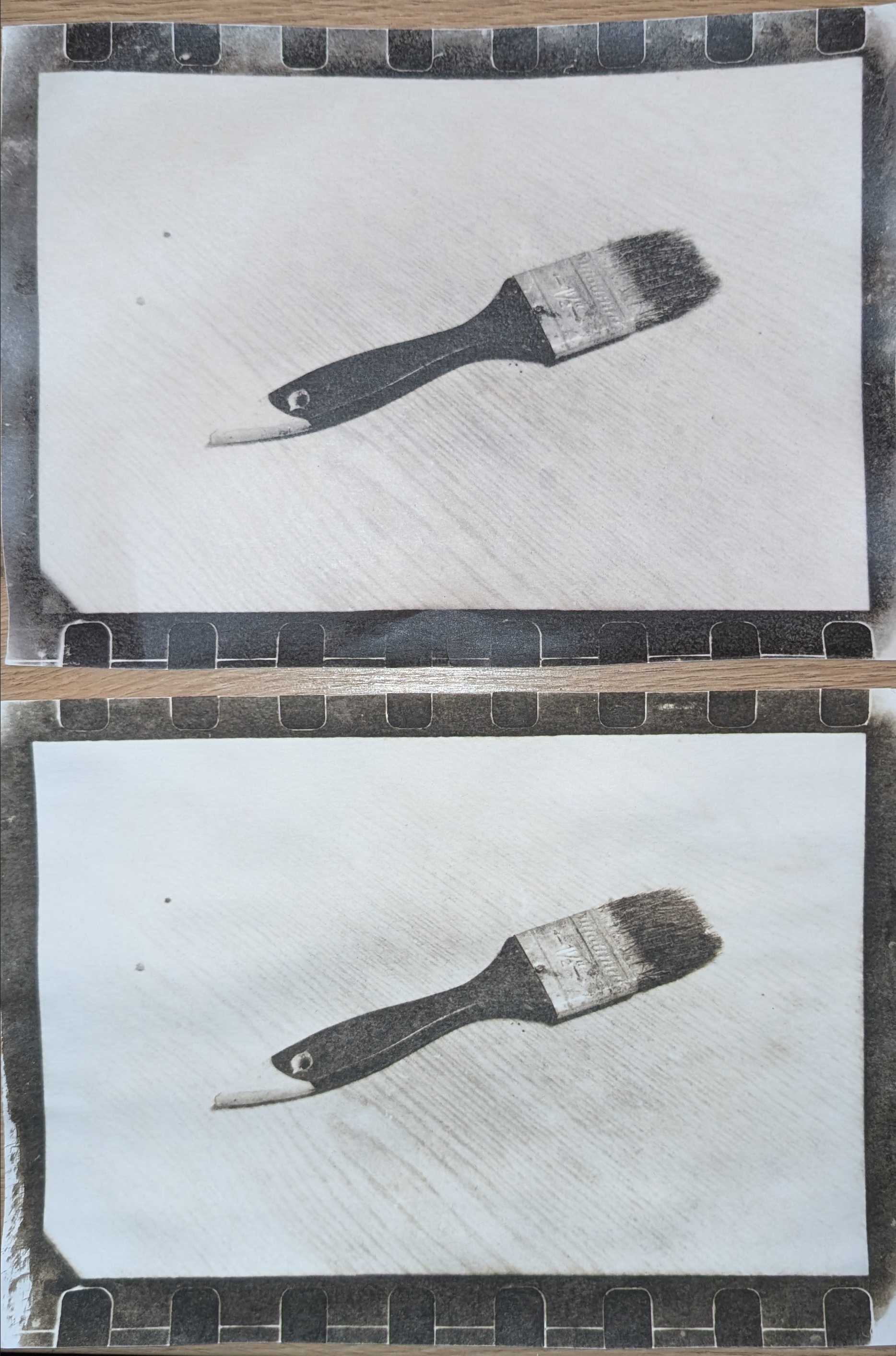

That's a good result! Congratulations!
It's a pity that the Copper image is unstable. But I like the fact that it can be toned with ordinary used fixer.
If the end goal is to get a Copper Sulfide image, Bromide variant of Cuprotype is arguably simpler, at least for contact printing. One might be able to get a silver image also from it by treating with Silver Nitrate.

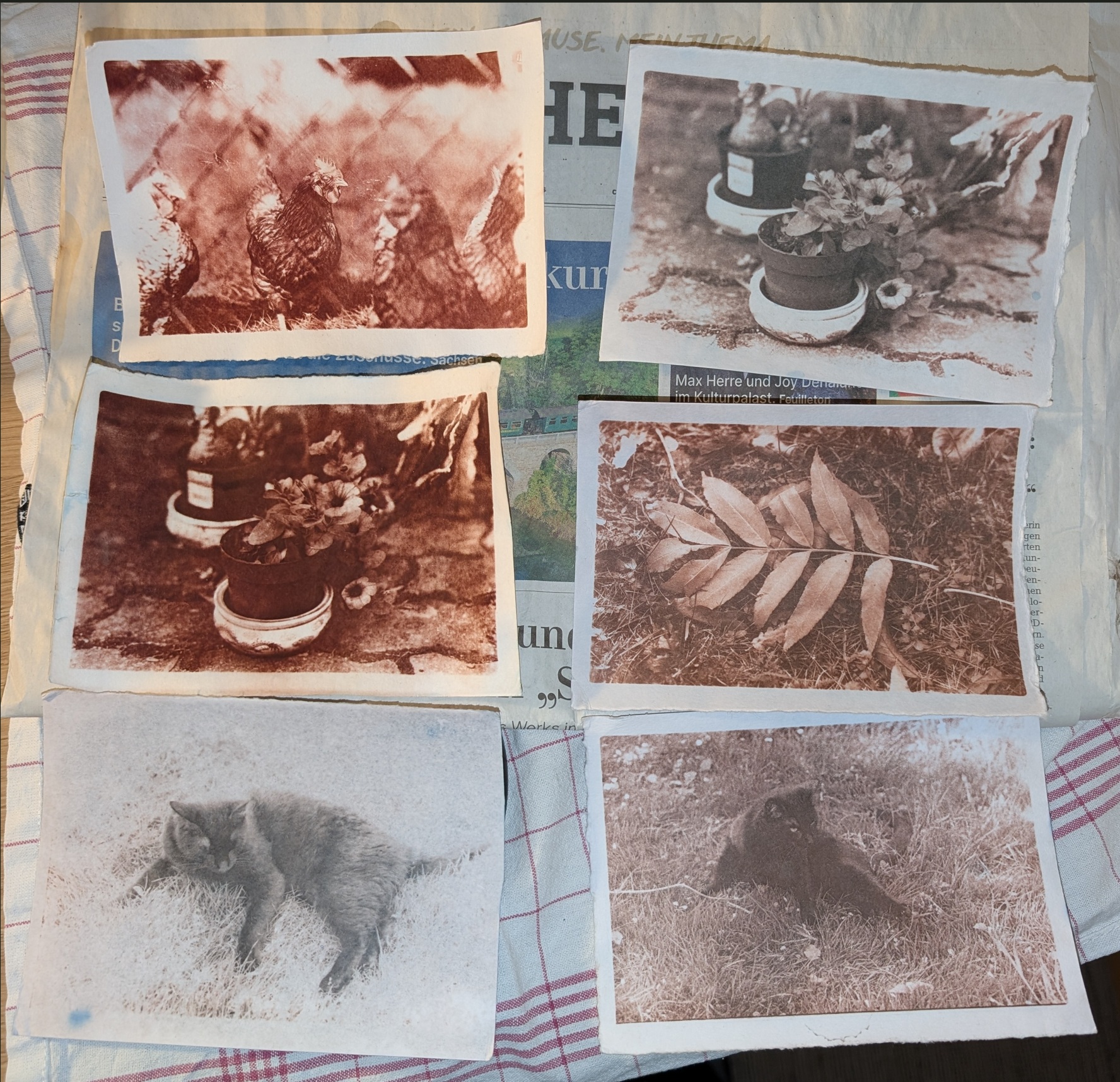

I have been experimenting quite a bit more and, most importantly, got ferricyanide toning to work which can give quite a range of brown to bluish-gray hues. The flip side is that the exact hue is sort of random for each print.
For this, I soak the still wet, fully fixed and washed print with a small amount of 5-10% KFerriCN solution, put it into a covered tray and leave it for at least 3 hours or over night. This gives a pink to brown image. The long toning time is far from optimal, but all my attempts at speeding it up led to a significant reduction in dmax.
After thorough washing, this can be further toned with a dilute, acidified Ferric Chloride solution, e.g. 2ml 10% FeCl3, 3ml 10% Sulfamic Acid, 50ml water. Afterwards it may be necessary to use ~1.5% citric acid to clear out iron stains. Some papers retain too much Ferrocyanide (with an O) and give a blue stain even with very long washes.
The resulting color is typically chocolate brown but can vary greatly from almost no change to bluish-gray, depending on paper, sizing, whether the paper was allowed to dry before toning, perhaps also how long the wash was, whether the sizing is hardened... Maybe also the phase of the moon or whether the seconds hand is pointing upwards or downwards :smile:
Here are some test prints:
The print on the right is shown before and after FeCl3 toning, it's still wet in the second picture and became somewhat dull after drying, I since found out that this can be avoided with agar sizing.

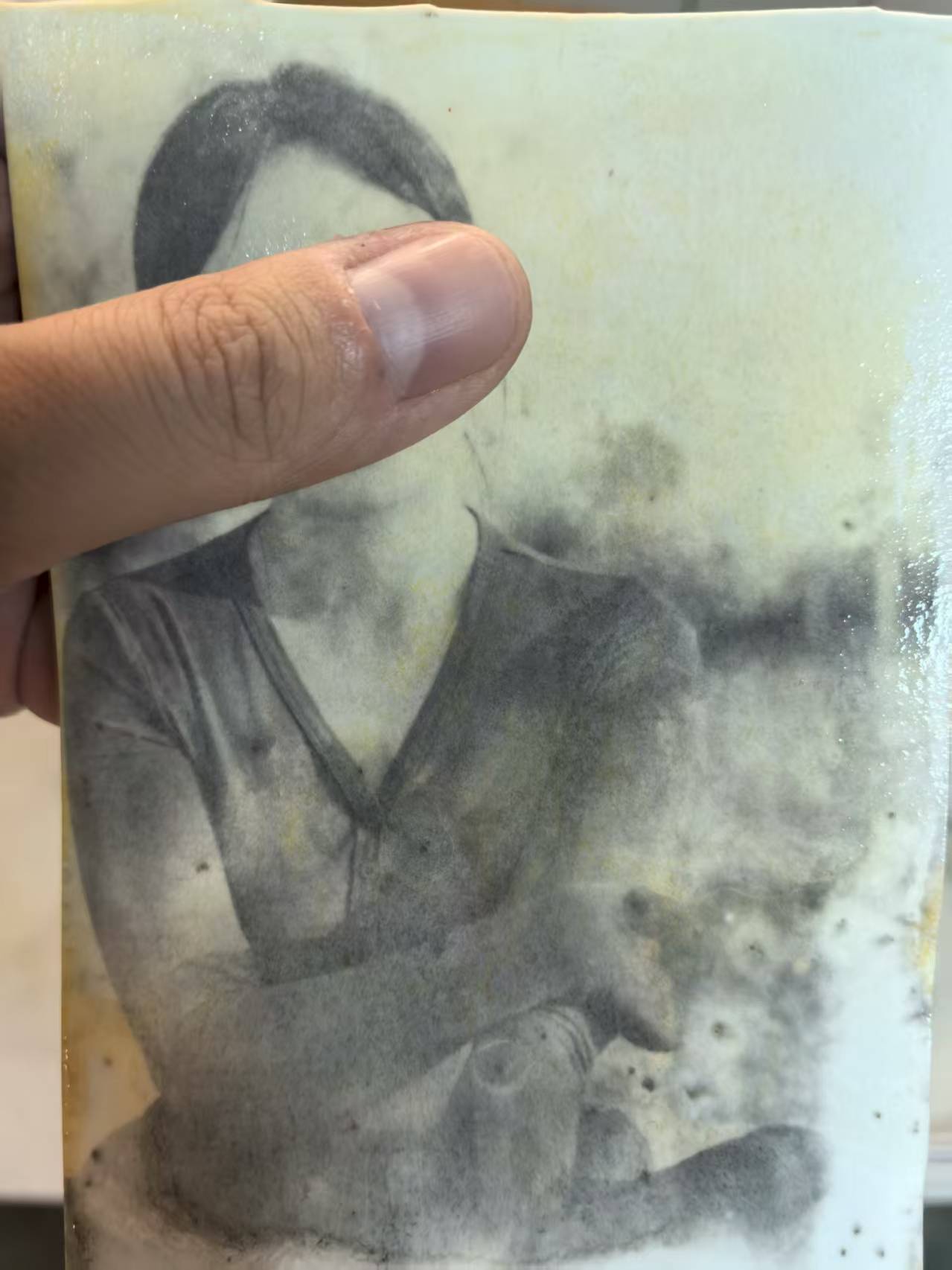

Here’s my 10-minute result after just a plain water rinse — no fixer, no toning!
Congrats, thats really good as a starting point! Sadly those directly printed-out images do fade in the fixer, exposing less and letting it develop instead seems to be the only way (and gives higher dmax, anyways).

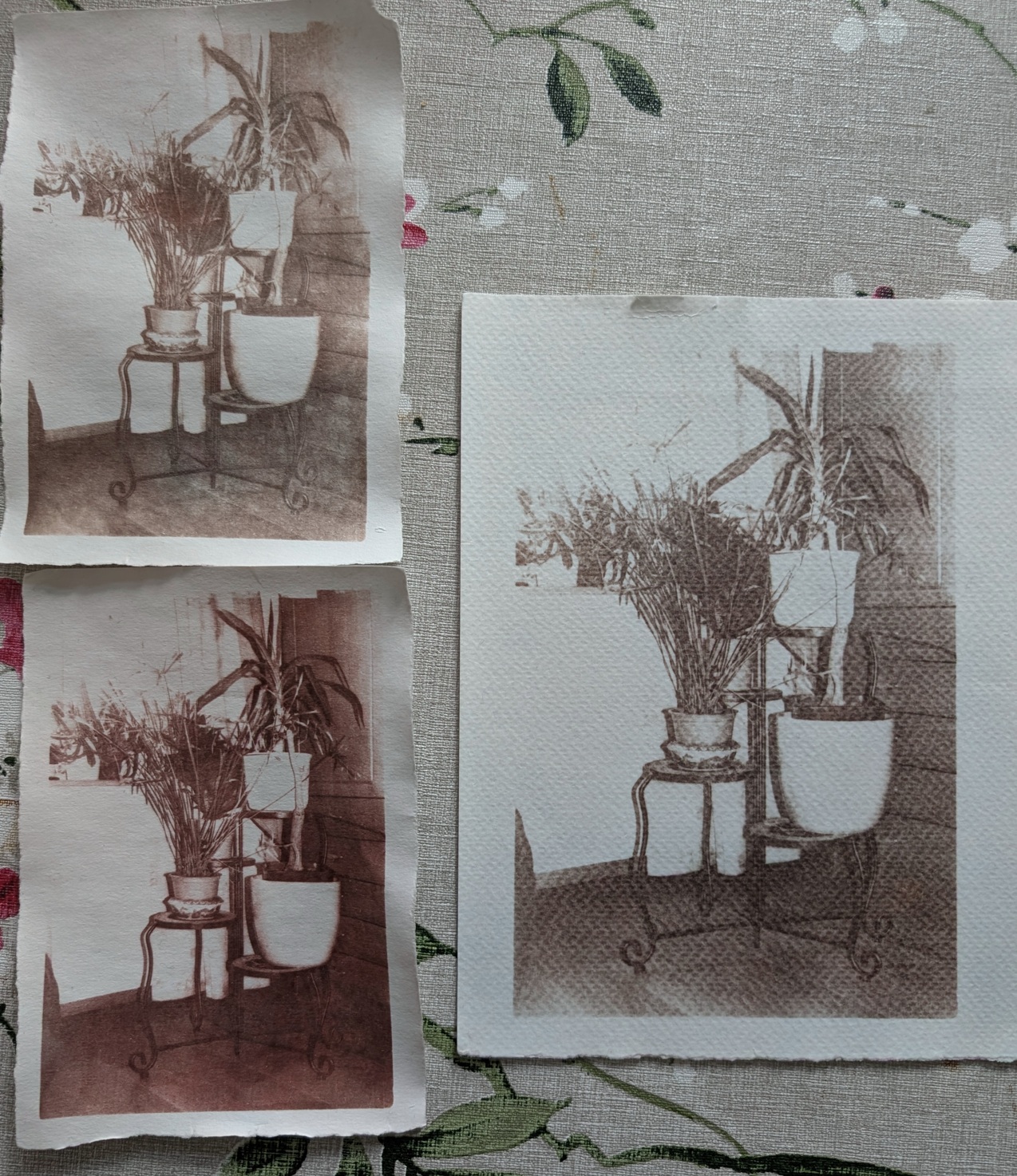

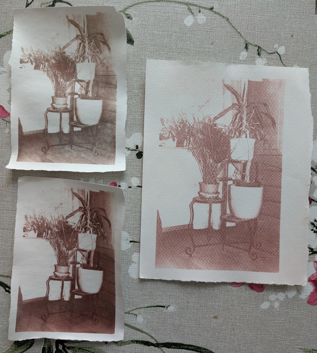

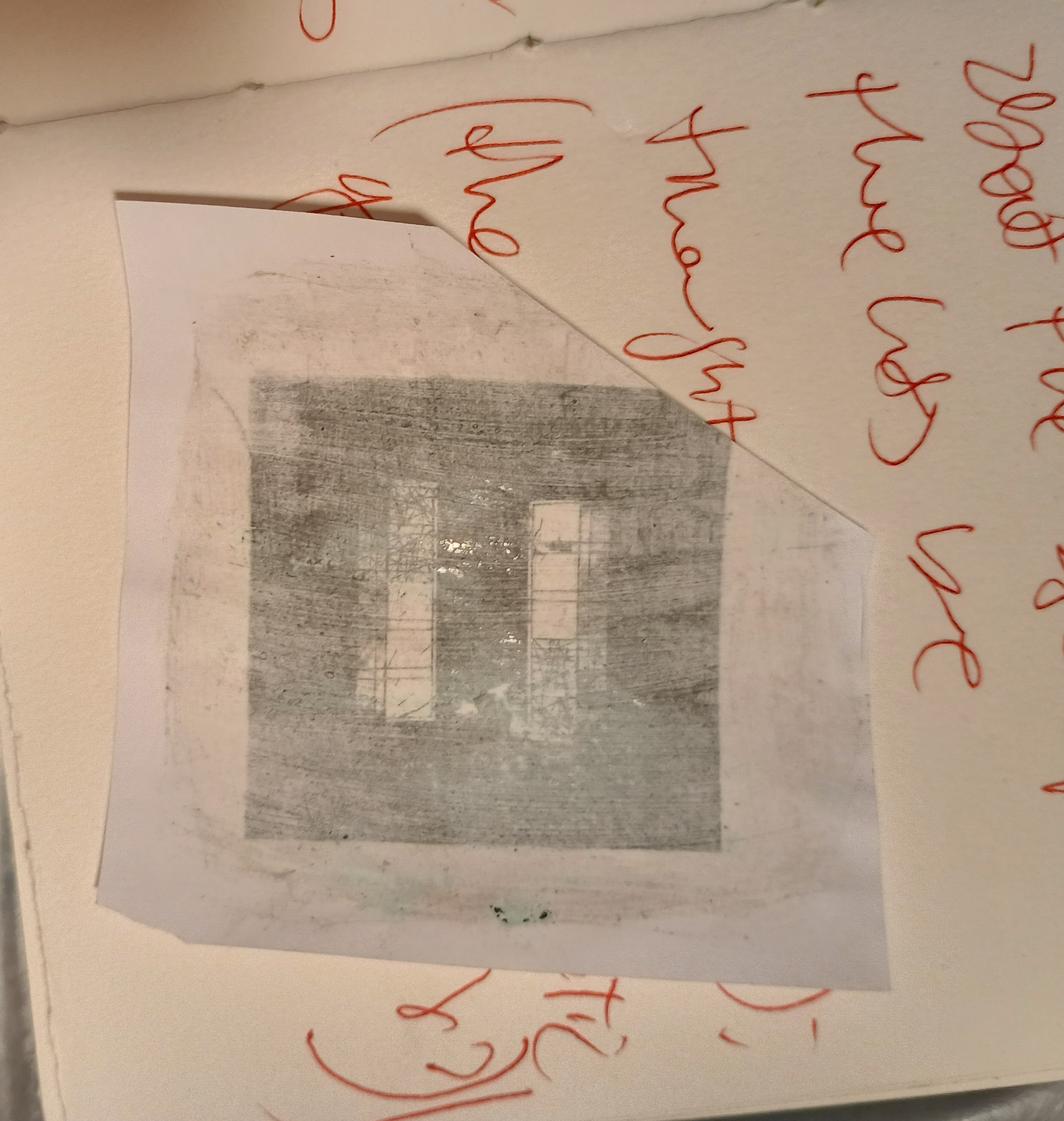

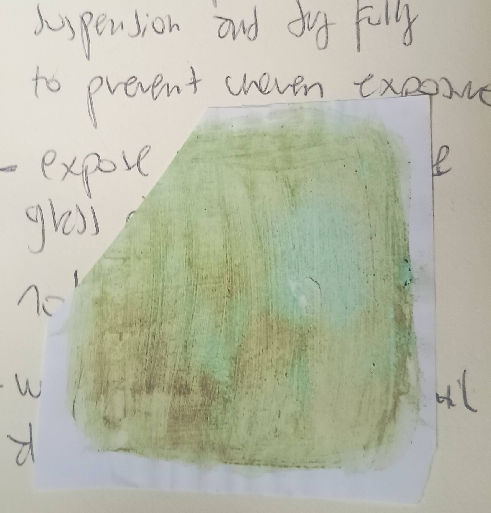

I am getting similar results, though my process is different, and it is still a work in progress as well. I thought I might share my route so we can compare both:
I start by preparing a standard Svinotype sensitiser. Working in subdued light, I add a saturated solution of NaCl until no more white precipitate appears. This is CuCl. The precipitate is decanted, washed, and decanted again. It is then dispersed in thick gelatin, brush coated, and dried. Contact exposures can be made under sunlight and exposure seems to hapen very quickly.
I am still trying to standarize the procedure into a recipe I can share, and I'm also trying to perfect the coating, density, fixing and toning of the image. I also want to experiment with developing it with Rude Rodinal! The picture I added shows a print I made this afternoon, which has just been saved into a notebook, without any post processing. The mettallic copper image is stable enough to not disappear immediately, and no fogging occurs under subdued light.
I will sure be taking inspiration from your process on how to tone and fix the image. Best regards and cheers!

I think the best thing Quinn offers is the possibility to use pyrogallol in a D-1 formulation. Definitely trying it out since it's readily available.
Yet they talk about using rapid fixers, both Anton and I have been using it too. I am suspicious about it because it doesn't seem to attack the cuprous halides but the image almost instantly fades. I think this is due to it containing ammonia as well as thiosulphate. I will be getting thiosulphate alone to try a more classic fixer formula.

It's surprising you got an image, dry CuCl is light insensitive, unless there is something like ascorbate or citrate present. Maybe you didn't fully dry it? When seasoning with the ascorbate/citrate it becomes air sensitive, I never got it to dry without oxidizing (accordingly in the patents they always dry it under exclusion of oxygen).
I strongly recommend you read the following patents US4904576A, US5236813A, US4427762A. The first one describes some experiments close to what you try to do, the third one talks about more alternative, "complexing" developers.
Any kind of thiosulphate fixer will reliably dissolve the halides, also Cu2O.
I saw that too, it is normal if you just blast it with light. The copper grains are just too small I guess... You need to develop to get a more stable image (which then still needs toning).
There are two kinds of development, physical development where you plate out more copper on the grains, and "complexing" (idk of an official name) development where a slightly alkaline solution of a complexing agent, e.g. citrate or glutamate, triggers disproportionation of the exposed grains into Cu(II) and Cu(0). Both kinds yield more stable images.
Make sure to use neutral to alkaline fixer, both rapid and normal one works.

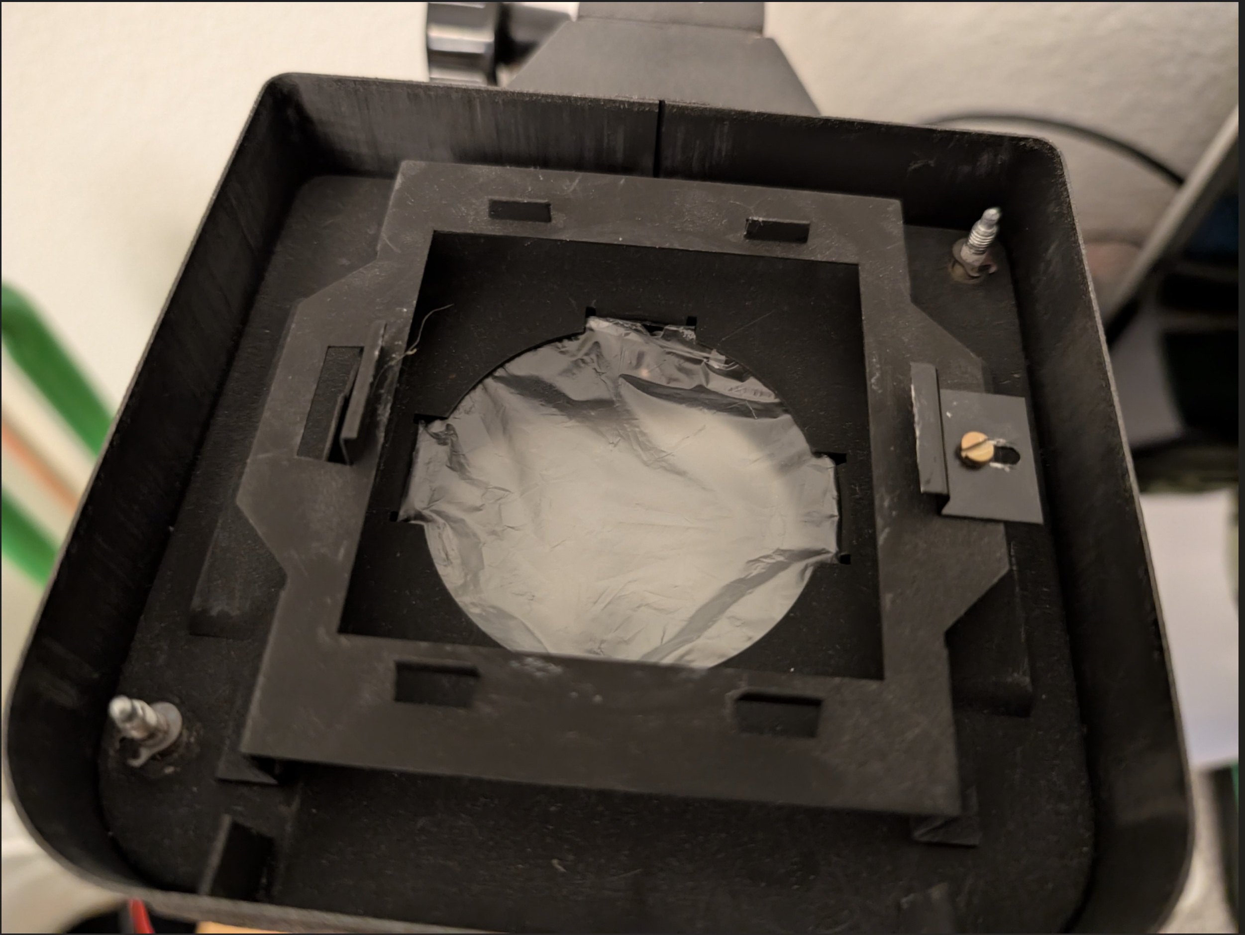

Enlarger Setup
I'm using a Meopta Axomat with the lamp housing + cold mirror removed.
The light source is a 100W cold white COB LED + 120° lens (90° works too, 60° is too narrow) mounted on a purpose made cooler. It is kept in position by a holder fashioned from a tin can. The tape prevents scratches and electrical shorts.
As a diffuser I put a piece of foil from those thin, translucent garbage bags above the condenser.
The main power source is a 60V/5A lab bench PSU, the fan is driven by a buck converter that leeches off the LED supply. The actual power I run the LED with is ~85W.
A glass negative carrier is mandatory, I improvised it with two glass plates as I could not find an original one for this model.
I switched to white light from UV due to ease of focusing and eye safety concerns, the exposure time is ~2x longer though.
(Photos are BW since my phone did not handle the multiple light sources too well)
Flashing setup
An allegedly 100w white led floodlight covered with ~5 yellow and 1 red gels.

Ferricyanide toning
Toning does proceed faster at lower pH after all, in my initial experiments I simply used too low ferricyanide concentrations. DO THIS AT YOUR OWN PERIL, NEVER HEAT MIXTURES OF ACID AND FERRICYANIDE, NEVER USE CONCENTRATED STRONG ACIDS, OR YOU MAY RELEASE HCN. https://www.photrio.com/forum/threads/how-safe-is-potassium-ferricyanide.45916/
The optimum seems to be unbuffered acetic acid. With stronger acids (i tried only sulfamic) the dmax is considerably lower so don't bother.
Recipe: Freshly mix equal amounts of ~10% K3FeCN6 and 25% acetic, use about 10-20ul/cm2 (micro-liters per square cm) (6-12ml/A4). Toning time at RT is about 20 min, much longer if there is a lot of buffer in the paper. The copper metal image must be fixed and washed thoroughly or there will be staining.
Washing after toning takes a long time.
Iron second toner for ferricyanide toning
To raise the pH and still reduce staining instead of sulfamic acid I now use "powdered lactic acid" which is actually a 2:1 mix of lactic acid and calcium lactate.
Recipe: maybe 50ml Water, 1 knife tip of lactic acid powder, 1ml of 10% FeCl3 solution. The process window is huge. Tone the thoroughly (>30min, 4 changes of water) washed ferricyanide toned image for about 10 minutes.
Washing temperature seems to affect tone.
If there is free ferr[i,o]cyanide left it will produce a blue stain, with some papers complete removal seems to be impossible.
If the paper was unbuffered there seems to be no (yellow) iron staining to begin with, otherwise the stain can be largely removed with citric acid (when it's still fresh, less so after drying).
Polysulfide toner
Seems to require larger copper particles (= less exposure, more development) to give dark tones. I've come to like it, the stench can be kept minimal by using very cold water for toning and washing.
Toning time: I give it about 10 minutes though there is no visible change after 1 minute already.
Like with ferricyanide, the copper metal image must be fixed and washed thoroughly or there will be staining.
It's sulfur dissolved in NaOH solution, I forgot the exact ratio, the batch is the same as in the first post. Working dilution is ~1+50, using about 1ml of stock solution for an A4 sheet.
Silver toner
Again nothing in the recipe has changed since my first post but I guess I should mention it again for completeness. It is old, silver bearing fixer. The copper metal print should be fixed first but thorough washing is not necessary.
I think it works better with smaller copper particles (= more exposure, less development).
Here is a directly polysulfide toned image (bottom), and an image toned first with silver then with polysulfide (though the latter did not seem to change anything here). The mottling comes from the starch sizing but it is much less visible irl

Oh, it really does... The image above is the same print I showed you but today as opposed to December last year.
