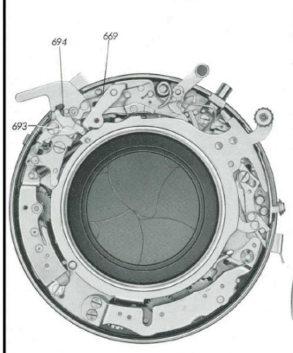

The lens is likely in a CN-1210-051 shutter. If the glass is good CLA the shutter otherwise replace the lens and CLA the replacement's shutter.
This is what you can expect to see when you remove the lens cells and face plate:
That looks pretty scary! When you say difficulty of 9/10, is that for a full CLA? Other replies hinted at quick and dirty cures...are those worth trying on this shutter do you think?
Nope
I had a sticky shutter on my Speed Graphic. I sent it off to Carol Flutot. She's very knowledgeable and I thought reasonably priced. She sent it back with a paper denoting the actual shutter speeds.
+1 for post 32. Solvent flush and oil or graphite is a bandaid on a 3 stitch cut, it will help for the short term but may cause more wear than normal on the shutter.
Not just that... there’s a 98.7% chance that it will make a Compur shutter worse in the short term.
