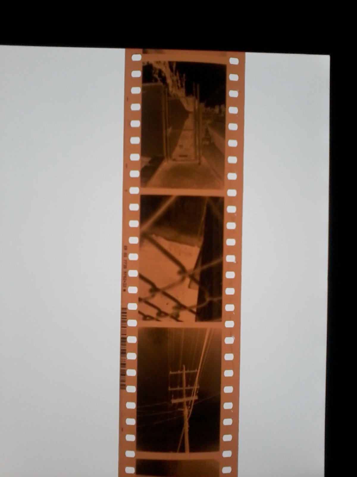

I did something similiar, I developed a few rolls of Kodak 50D in b&w chems using a dilution & time of a similiar speed film/developer combo, in this case Ilford Pan F+ 50 in Kodak HC110
My routine was:
1: Develop rolls in Legacypro L110 (similiar to Kodak HC110), used Dilution E (1:47) and time of 5m 30s
2: Stop bath (distilled white vinegar & distilled water mix)
3: Used Photographers Formulary TF-5 fixer
4: Rinse film using Ilford method, then soak in Photoflo for 30 seconds
Overall, they came out fine. Most came out overexposed (my fault, the lightmeter I was using at the time was off) and on some parts I didnt get the remjet fully off.
