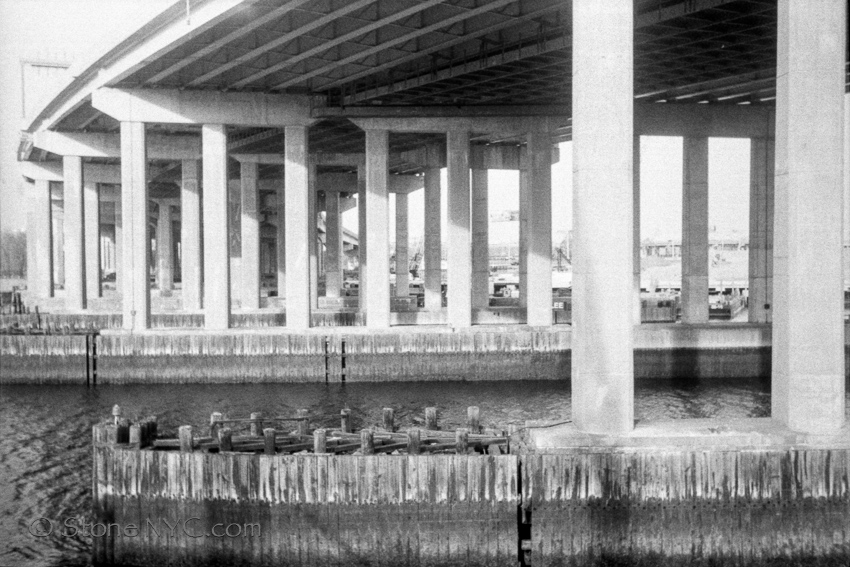

They look nice Stone, especially in tonality, sharpness is less than in B&W straight.
I cross processed a fuji superia 200 -lighted at 200- for 1 hour in 1:100 rodinal, Pictures where taken with an Olympus XA2. The vintage look they have is the only reason why I would use this process so I cross back to straight black and white.
Kees.
View attachment 67217View attachment 67218
Not bad at all, hmm maybe I'll try at one stop instead of two and see what happens, yes it's the vintage look that is the reason. I agree.
I really like the first one a lot.
~Stone
Mamiya: 7 II, RZ67 Pro II / Canon: 1V, AE-1, 5DmkII / Kodak: No 1 Pocket Autographic, No 1A Pocket Autographic | Sent w/ iPhone using Tapatalk

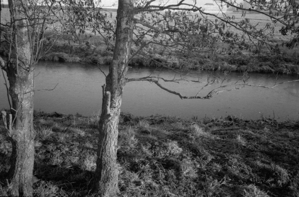

New Question ... these are 4 un-cropped images, scanned, does anyone know if the sprocket shadow is due to the old camera I'm using, or is this an effect of stand developing? (I've never used the Zeiss Ikon Contina Matic II before this test and never stand developed either).
Thanks...
View attachment 63685View attachment 63686View attachment 63687View attachment 63688
Love the tones and grain in the first one. I have some Agfa portrait 160 220 I think I'll try this way. One with coffee and one with Rodinal.

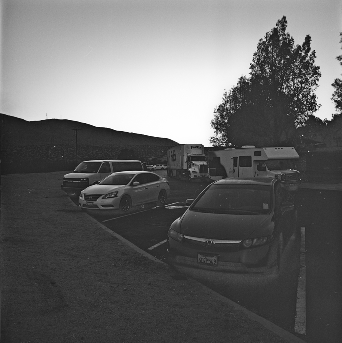

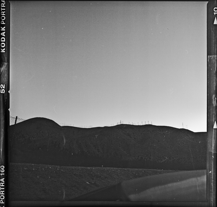

Hi everyone, I've read this thread before, but this is my first time actually trying it (a couple years later). I've been in nursing school the last couple years, but I just graduated and now I've got some free time to play with photography again.
Right now, I've got a Portra 160 color film shot @ 160 that's in the tank, stand developing for 3hours in 1:100 Rodinal 20C. If I understood the thread correctly, when stand developing color films in BW chemicals you should push the film 2 stops, (so instead of developing the box speed at 1hour, I will be developing for 3hours total) if it wasn't already shot 2 stops under before development.
I'll be back from the gym to agitate half way and will let you guys know if anything turns out.
Geoff.

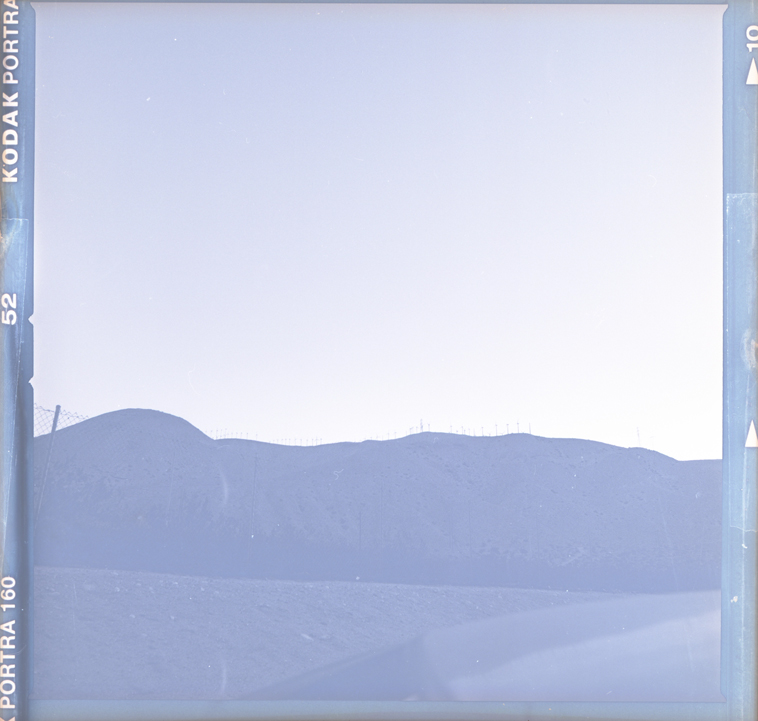

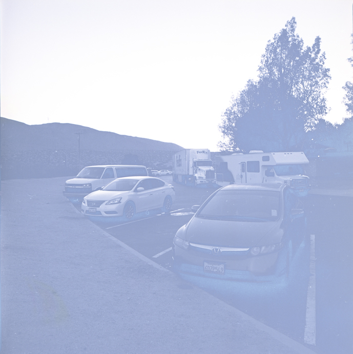

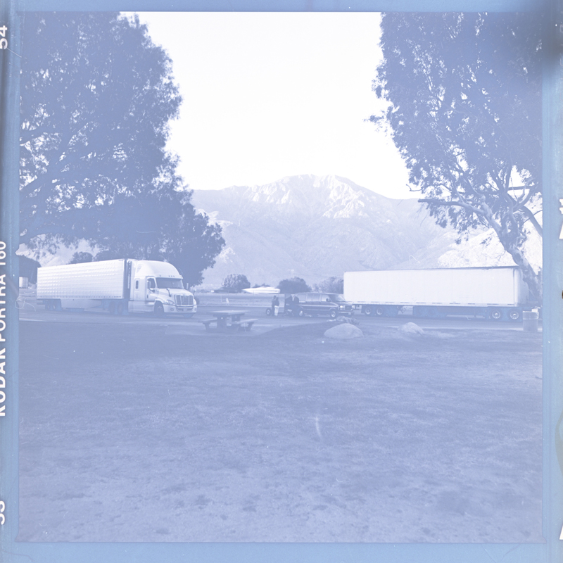

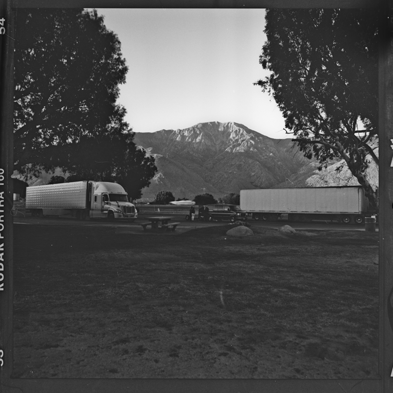

Thank you for your help! Yes, this has been my experience too! My film came out very thin and washed out with low contrast, loss of shadow detail plus halo-effects, but the midtones were okay.
I will try your tips next time I plan to cross process.
I think not compensating for the EI by two stops under for the stand development is what ruined the film -because I have successfully cross processed Portra 160 before with the normal development process.
These are the scans alternating edited and the unedited -scanned in color:
Originally, I did 1:100 for 3 hours with 3x3 agitations, but next time I have film that's already shot at box speed, I will try a 1:50 solution for 1 hour with 1 or 2 agitations.
I think maybe increasing my developing dilution or decreasing my development time will help with the contrast and film density.
Side note: yes my developer is still new, I have only had it a couple months. I use it as a one shot (no reusing), and ive only done two or three rolls with the original bottle, so its still fresh.
