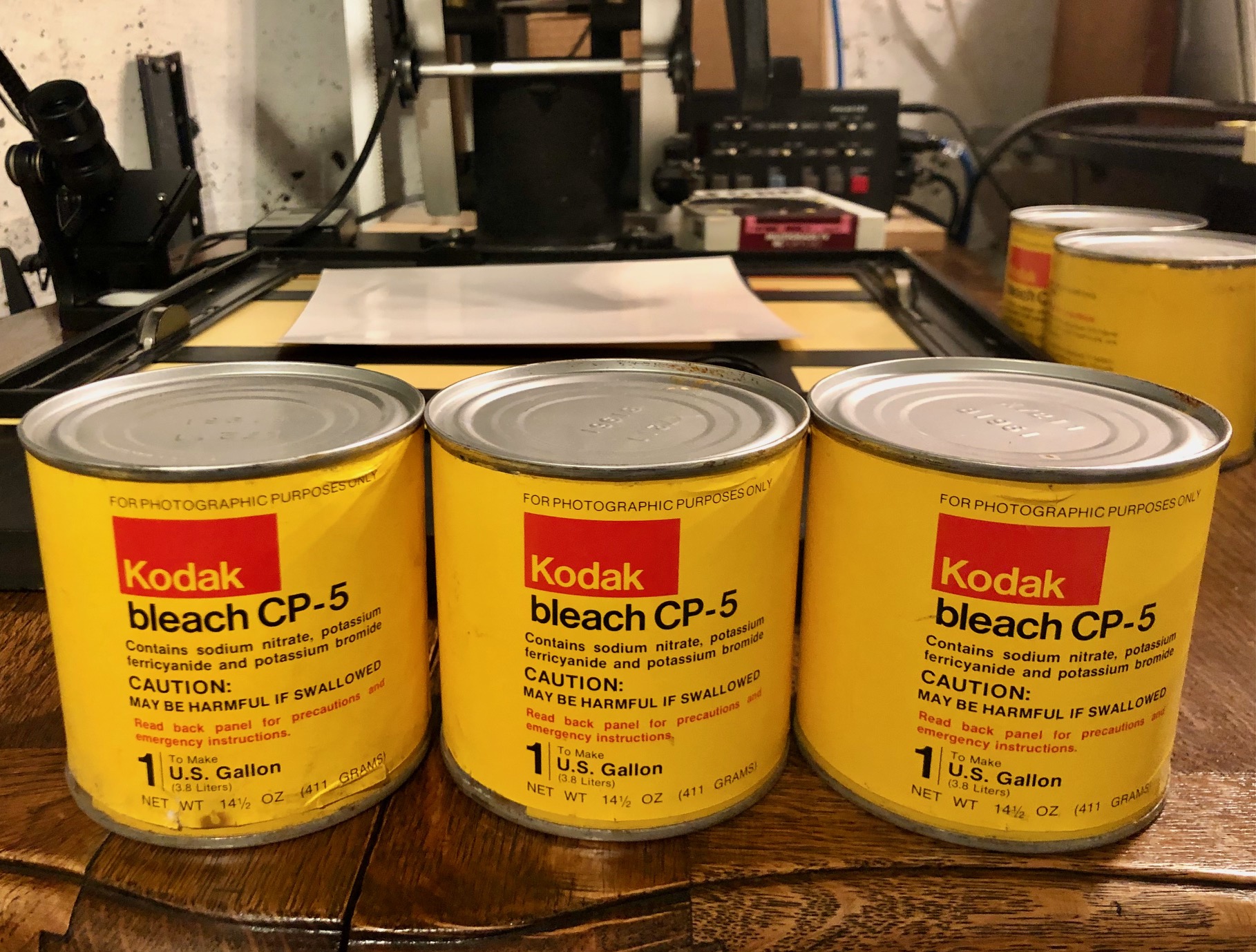

I came across these cans of Kodak CP-5 bleach, containing
- sodium nitrate
- pot ferricyanide
- pot bromide
Proportions unknown. The Cookbook doesn't mention this combo, although I may have missed it.
I think I remember that the CP series of chemicals are/were for colour processing (and usually machine processing?).
Anyone know if this combo would be useful for some B&W bleaching, as for pre sepia, etc.?
The quantity is a bit much, having to mix up a gallon's worth.
Thanks!
Looks like it. I'd give it a try. I don't think the additional nitrate is going to be much of a problem, and the pot. ferri. vs. KBr ratio isn't very critical usually.
Quite a bit more I suspect, because this bleach will likely be quite concentrated and fast if it's intended for color processing. You'll probably have to dilute it back a lot more for decent control over the extend of bleaching.
What is the sodium nitrate for?
I don't know for sure, but I think it's for forming silver nitrate alongside the silver bromide. Given how soluble silver nitrate is, I wonder if this is suitable for B&W at all. I think it might actually solubilize most of the silver and is not a normal rehalogenating bleach. This would make sense for a color process.
Don't think so. I'm not a chemist, but it seems to me that energetically this would be opposite to what can be expected in a mixture like this. Perhaps one of the resident chemists can go into this?
My guess it's there for buffering purposes, possibly to manage pH in the bleach bath in the face of carry-over from a preceding acidic stop bath.
I'm gonna find out, because I just ordered a can. It was cheap.
I find it interesting that it's the first ingredient listed and wonder if it makes up the bulk of what's in the can.
If that were true:
* Why is it a bleach and not a blix?
* Why would we bother with much more problematic blix formulas that are inherently unstable?
* Why would there be any potassium bromide in it if it doesn't have to rehalogenate?
You see, it doesn't add up.

I did not say it's a blix. I said that I think you will get some developed silver turned into silver nitrate and dissolved into solution. What the full implication is of that, I cannot say. But I would not expect it to be a fully rehalogenating bleach.
FWIW, there's some ammonium nitrate in E6 bleaches and it's supposedly there to limit corrosion in metal parts. This CP-5 bleach was used in colour paper processing.
Alright, 'silver removal bath' then :wink:
Again, the assumption you're making is that metallic silver, silver ferricyanide or silver halides will form silver nitrate in the presence of nitrates in solution. Since I'm not a chemist, I can't verify this assumption, but it doesn't sound right to me. For instance, when making silver nitrate, you generally dissolve it in nitric acid. If nitrate would be capable of the same trick, making silver nitrate would be a whole lot safer than it is now.
@Anon Ymous That makes sense. But color bleaches are full bleaches, meant to remove all silver. Better suited to reversal than what the OP asked for B&W paper work.
It's a rehalogenating bleach and it doesn't remove any silver. It converts it to AgBr, which can be removed by fixer. In order to remove metallic silver in a single step, a blix is required. With the exception of RA4, all other colour processes have separate bleach and fixing baths. Some simplified amateur kits come with blixes though.

I'll give it a go, of course, will test on some reject prints at original dilution and then higher dilution.
For anyone interested, he still has quite a few cans for sale:
Also, quite a collection of interesting photo things among his other items.
First: the contents of the can are pretty much a solid clump. A bit hard to deal with.
Second: a teaspoon of this in 500ml of water does .... nothing that I can see to rc Ilford paper. I'll test more some other time.
