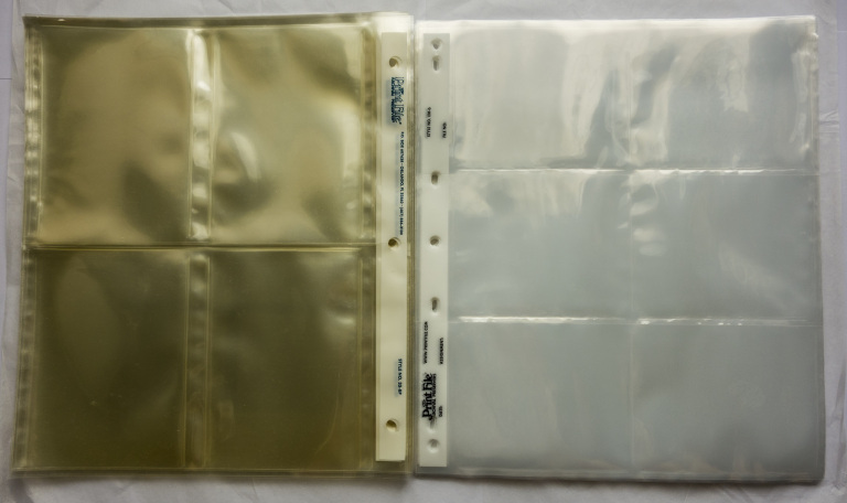

Dunno, but the PrintFile's plastic is not archival...at least what they used 20 years ago.
20 years comparison.

I wonder what attacked that print file page to turn it brown like that.
My TMX and TMY from school in 1994 are perfectly preserved in their Print-file sleeves.
I'm not convinced that the fact that a negative or slide storage sheet turning brown is, by itself, an indication that the negatives stored in it are negatively affected (not effected).
