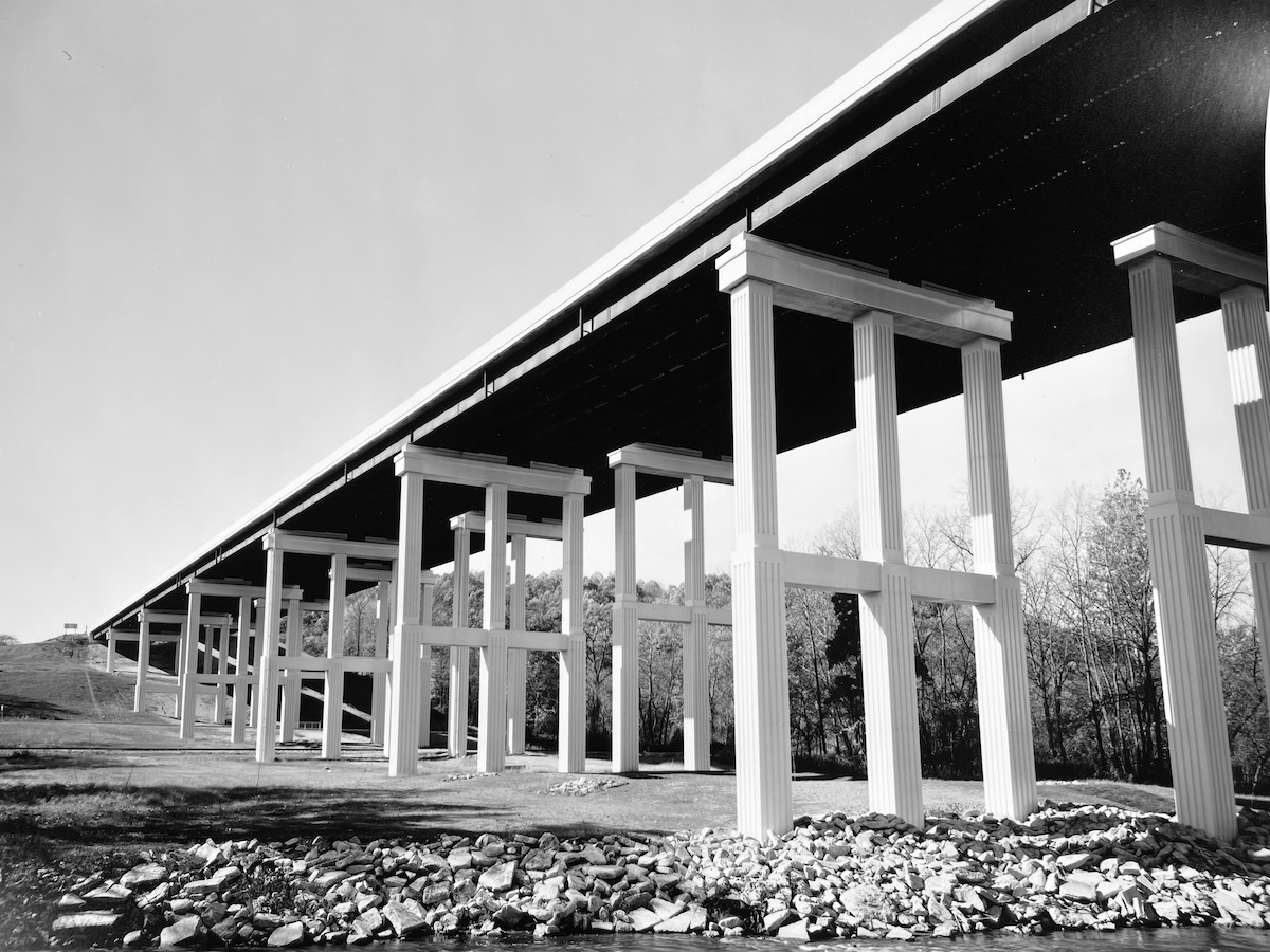

I did this print a while back. I was using a 210mm Symmar-S on my 8x10 camera. That lens does not offer any movement on 8x10 format, so I had to tip the camera up to make this image.

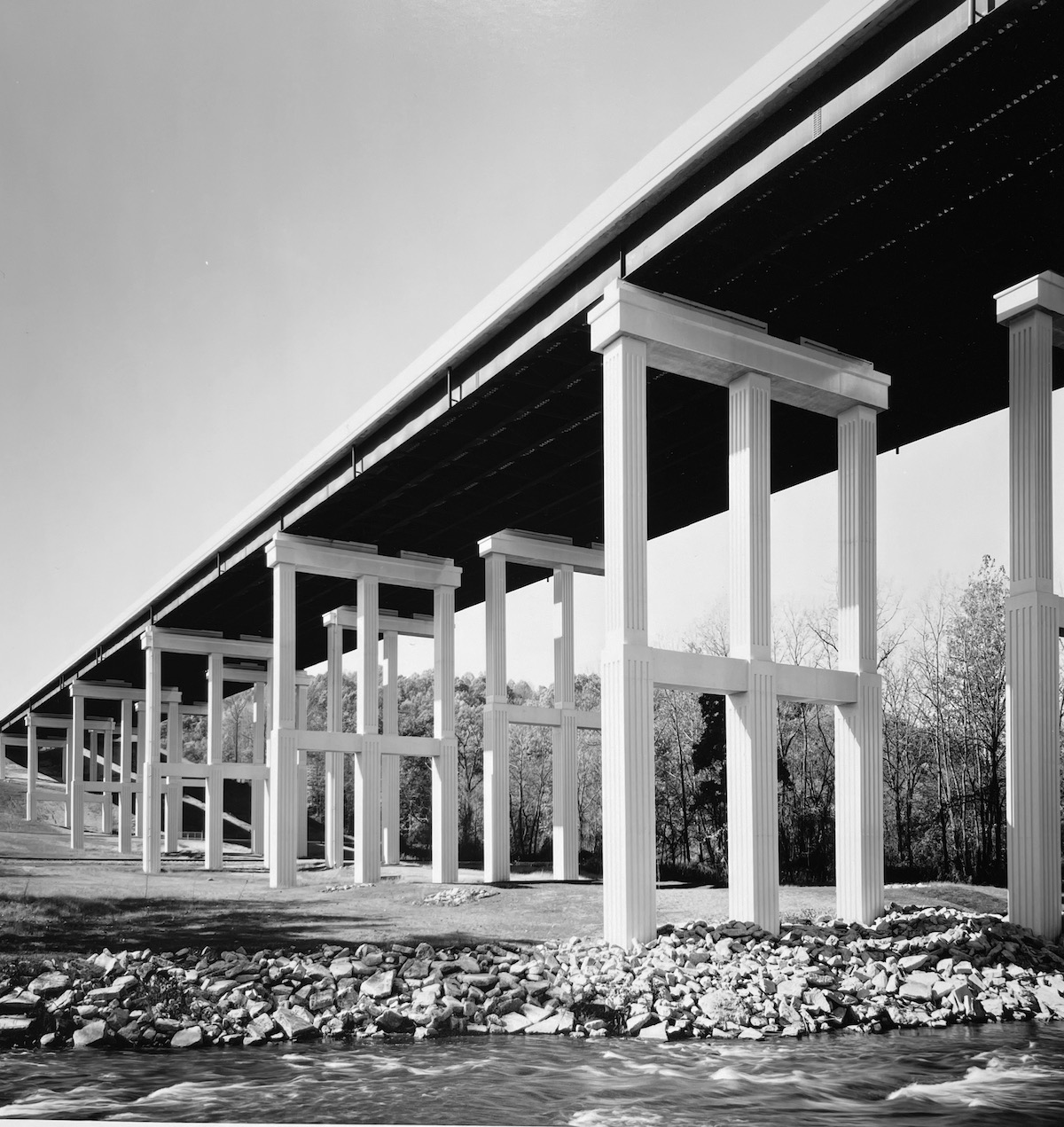

Back in the darkroom I setup the enlarger like below, and made the second image. One nice thing about this is the sky gets less exposure while printing, so one does not have the image falloff darkness that would accompany a wide field lens with no center filter.
There are four movements of the enlarger involved.
Tilt of the negative (whole head)
Tilt of the baseboard
Tilt of the lensboard
Shift of the lensboard to re-center the image circle
I've done some of that before with good success -- and not much paper loss -- but nothing so elaborate.
