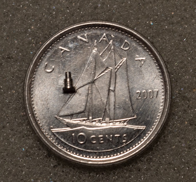

After I took the shutter speed rings off and turned it over to remove the aperture control ring a very tiny stepped shaft fell out, so I have no idea where it came from. It's 0.090" long and the larger diameter is 0.040" and the smaller is 0.027.

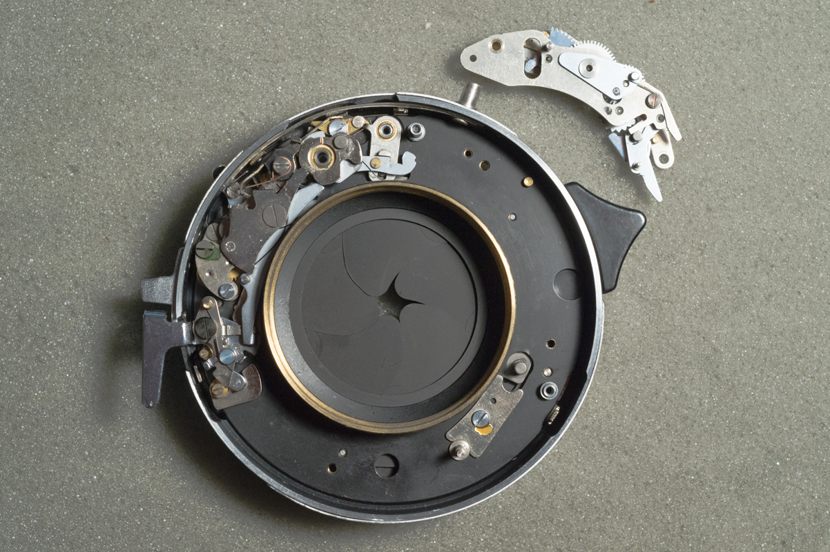

Pictures of the shaft and the shutter with the speed ring off will help me figure where the shaft goes.
Look at the bottom side of the cover/face plate, does it have machined recesses? Yes- they mate with various pins/lever tops and have to be aligned correctly. The center lock ring screws down and if too tight will cause the shutter to run slowly, too lose and the face plate will move with the speed ring. No-different design than I'm familiar with.

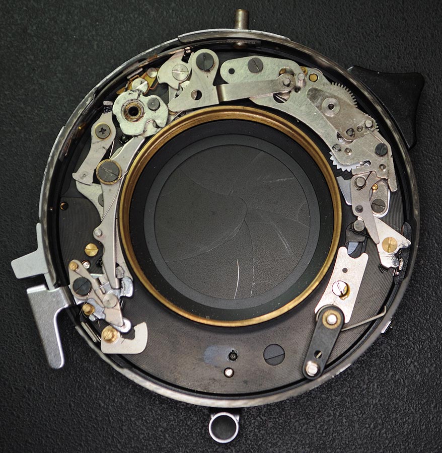

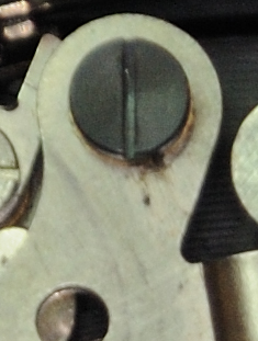

I have a second lens, identical to the one with the bad shutter, and I was looking closely at it after I posted. Turns out I had the shutter blades in backwards - they wouldn't fully open. I've fixed that now, and comes to the next problem. The shutter open and closes smoothly by hand, but once I add the mechanism to connect to the opening lever it doesn't operate fully. Looks like the spring pressure is insufficient to move the shutter fully open or closed. I'm sure I have it installed incorrectly, but I can't figure out what I've done wrong. It's the copper/bronze coloured spring wrapped around the screw head at 12 O'clock:

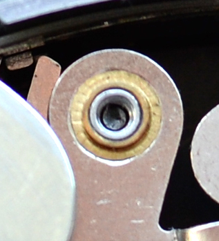

Here is the shaft:

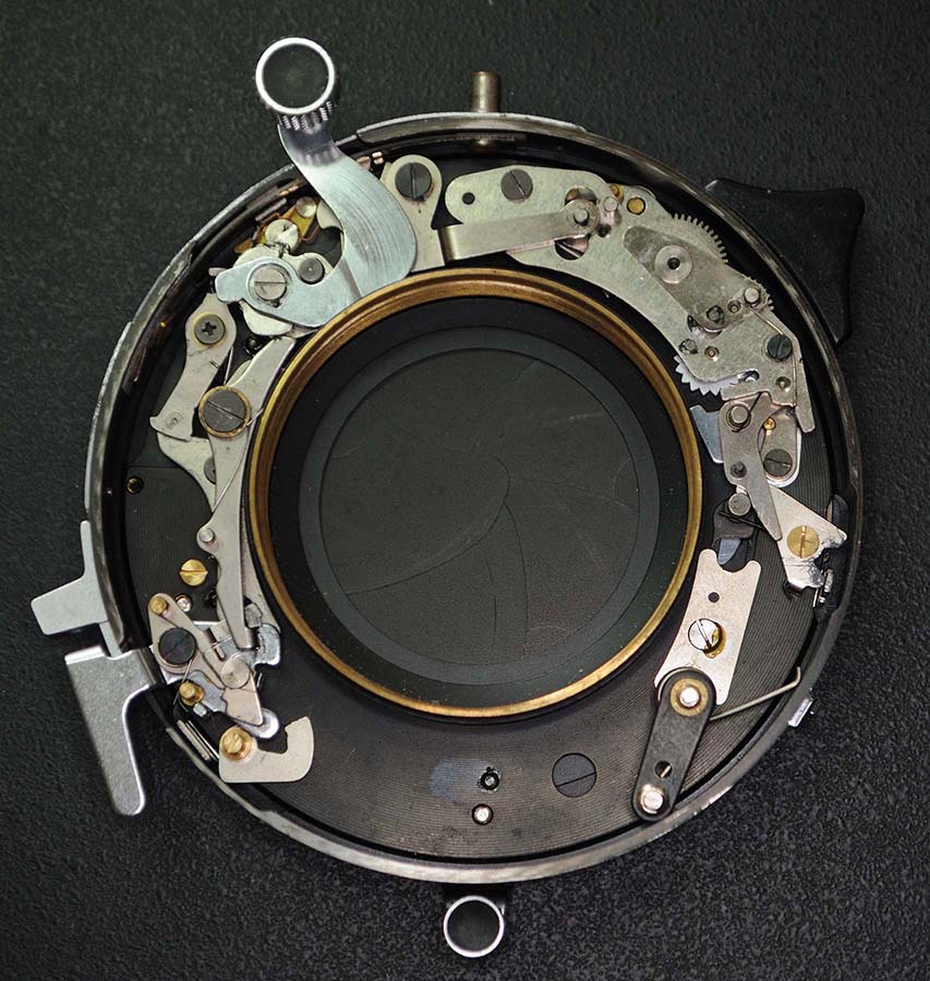

And as you requested, an overall view of the shutter although with the slow speed mechanism removed:
I have scaled down all these photos to make them fit the forum, I can make them bigger easily.
Yes, the underside of the black shutter speed plate has 2 radial slots in it - one is aligned with the 1 second speed, the other about 110 degrees clockwise when looking at the speeds.
Shutter opening springs usually apply 3 to 5 grams of pressure to the blade mechanism to open the blades. If the blades do not open fully then there is something in the controller path preventing them from opening or the spring or actuator is not set properly. Some shutters open springs can be adjusted to apply sufficient pressure to open the blades. The blade controller should move with the weight of a 1/4 inch long down feather applied to it regardless of starting position.
In the last photo I can open and close the shutter using the post at about 4 o'clock and the blades move easily and smoothly. That's what makes me think something in the spring position isn't right, as it doesn't want to open or close fully under the spring pressure.
I did further study of my disassembly photos and I now have the shutter blades opening and closing smoothly with the preview lever. There is an additional spring I hadn't put back when I was testing it at first.

I'm assuming that has something to do with the tiny stepped shaft that fell out when I took the speed ring off. The head is flat and there are no threads, so it looks like a press fit - somewhere!
Do I need to take the front cover and speed ring off my black face #1, take a picture and post it?

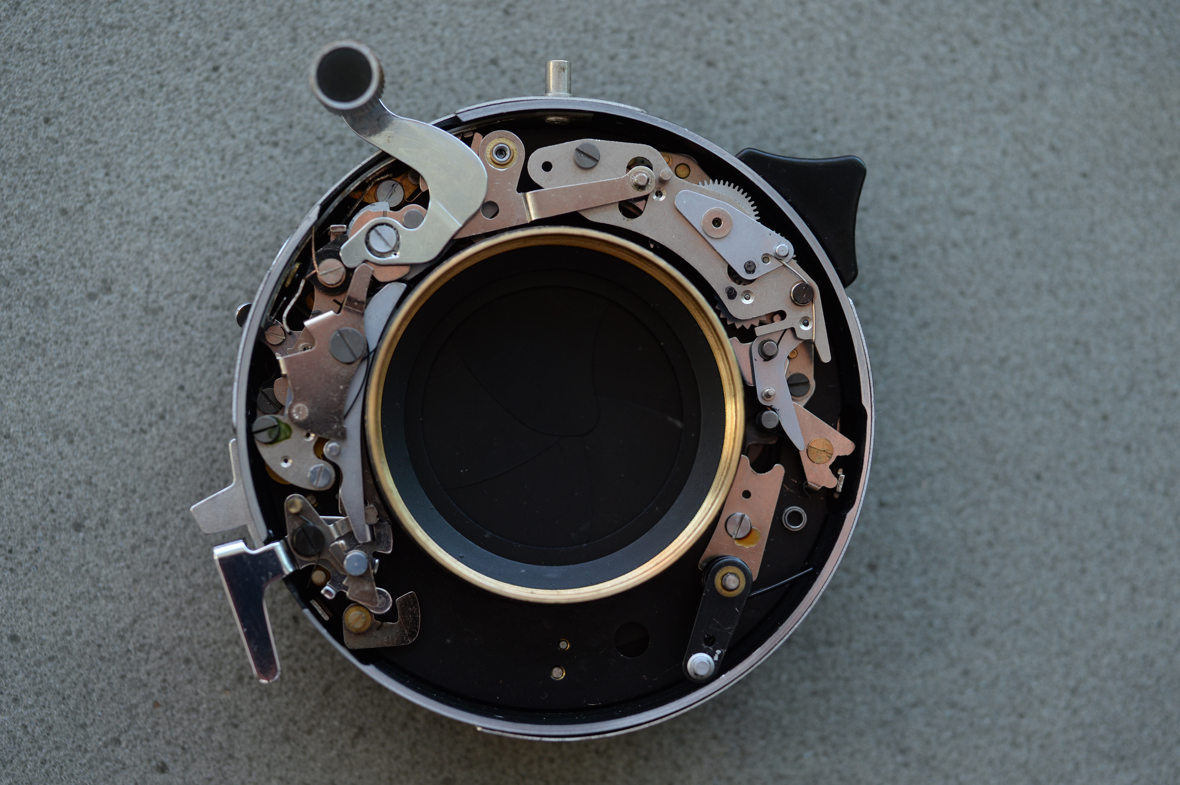

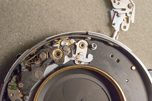

After looking inside my #1 I believe the "tiny stepped shaft " that fell out either broke off a lever or came out of the main plate. Pins/posts are pressed in and one may have come out. Look for a unused hole that a spring or lever may mount on or a broken off point on a lever.
These pictures may help.
Thanks for the photos. Interesting that my shutter has quite a bit more mechanism on the left side. I will compare both closely.

I have the shutter back together and it works. I don't have a shutter speed tester, but the speeds sound right. I never did find where that stepped shaft fit, there was no obvious empty holes when compared to the other photos. Maybe it comes from the M/X sync mechanism? Not sure. There was no place it could fit on the chrome speed ring. Other thing that is missing is a spring to return the cocking arm, it moves freely. Maybe the spring disappeared when I took it apart, or was never there, as it appeared someone had been in there before me, some of the screw heads showed they had been removed before with a too big screwdriver.

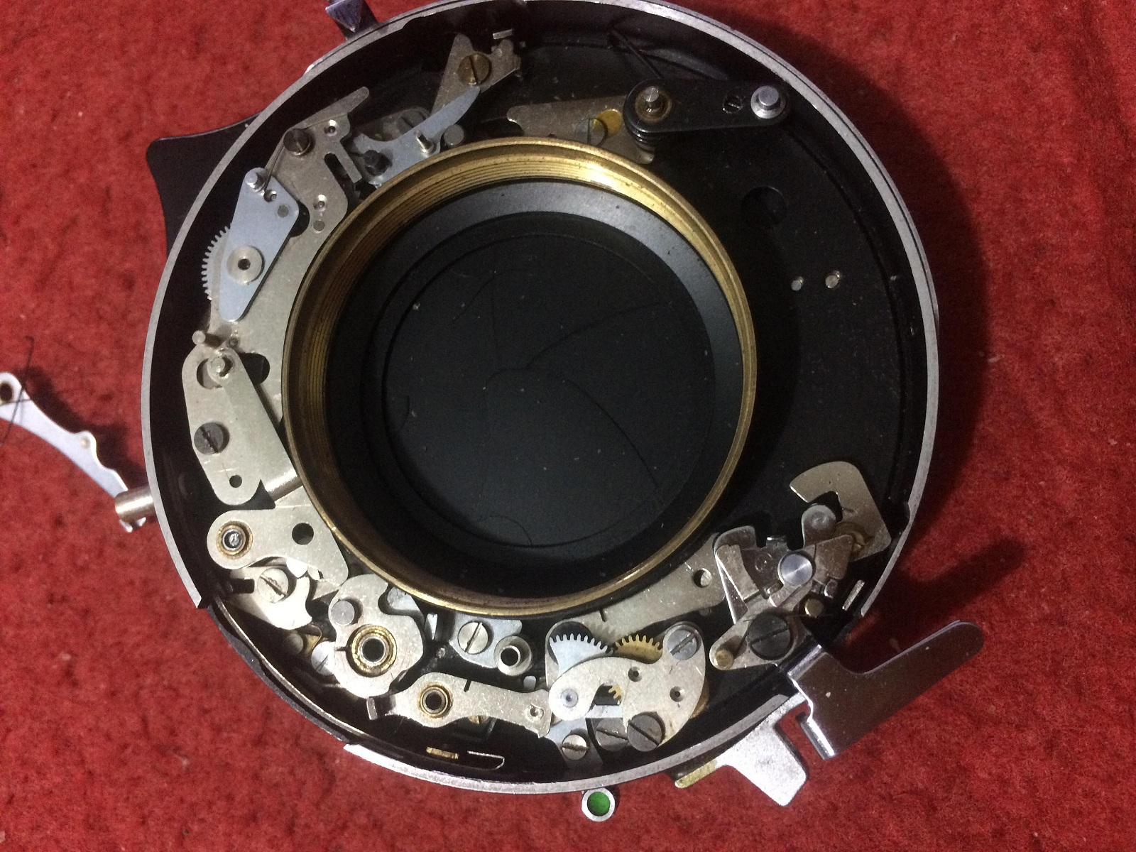

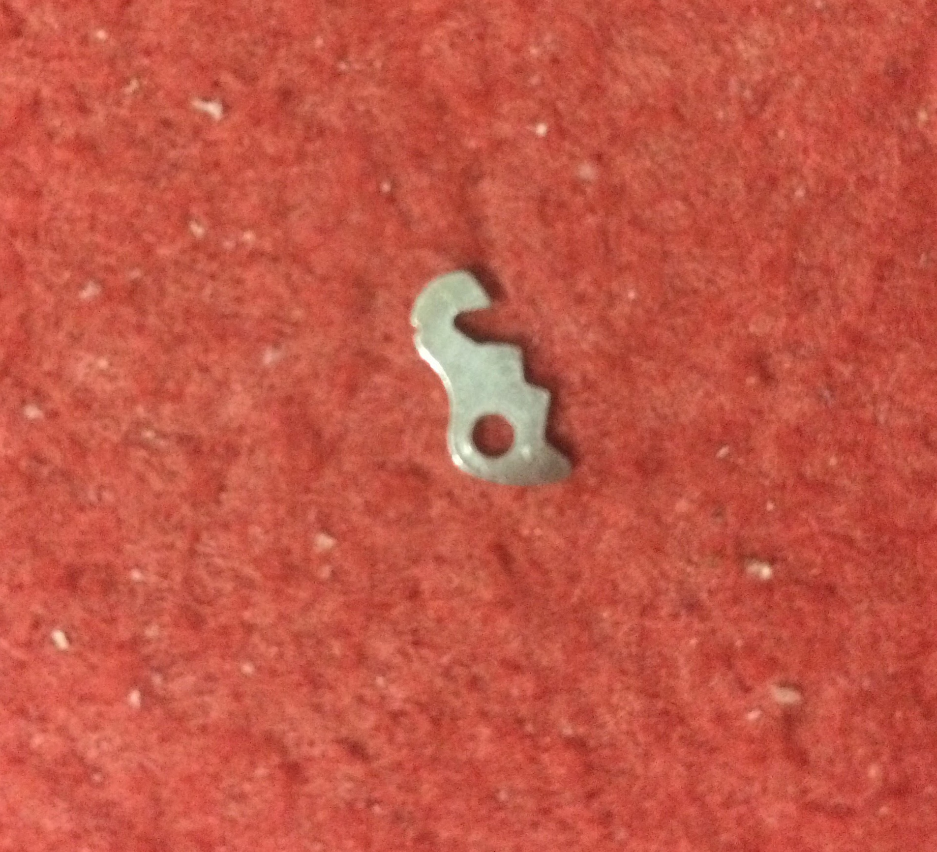

Hi everyone.
I have problem when reinstall may Copal No1. I have some detail and don't know exactly where is position.
So can you help me identify position?
Thanks
