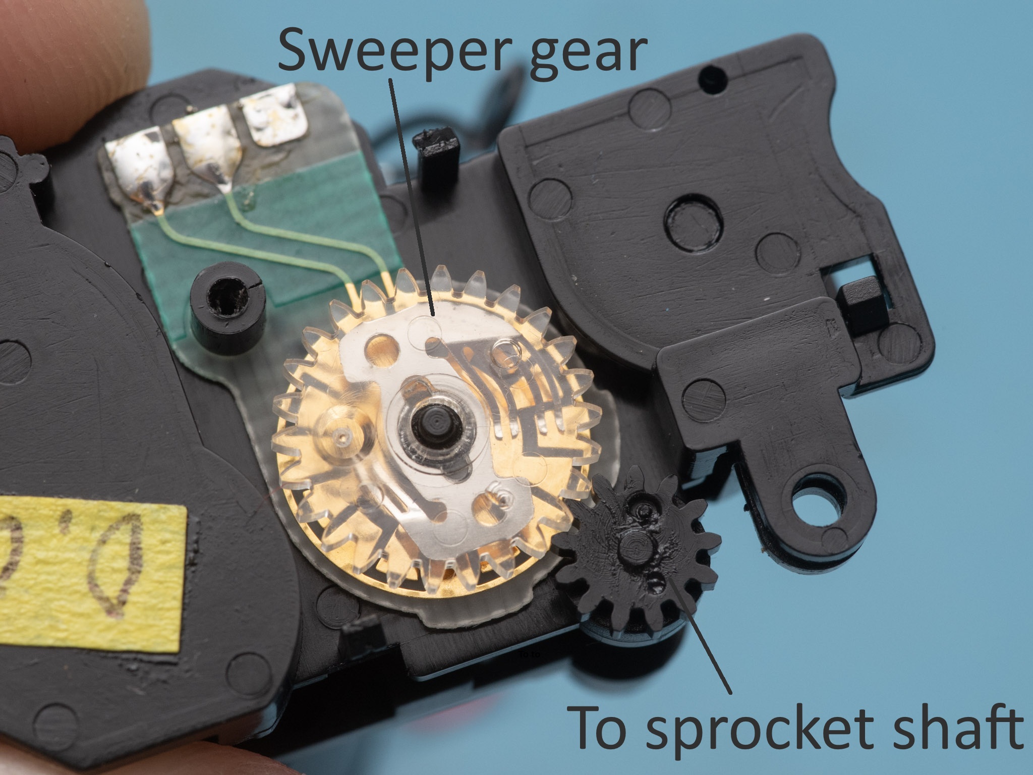

I've been messing around with camera mods lately, specifically, modifying 35mm SLRs to shoot other formats. My first project was a half-frame Pentax MZ-3, and currently I've been enjoying a PZ-1p that I converted to shoot square frames. The conversion involves masking the film chamber and the viewfinder to the desired frame dimensions and also modifying the frame advance to pull the appropriate amount of film. This is the interesting part, in my opinion, and I wanted to share it here.

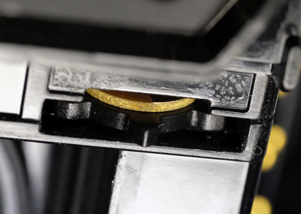

Both of these cameras use an electro-mechanical sprocket counting mechanism to govern the film advance. The sprocket in the film chamber is free spinning, as opposed to geared like older cameras. As the film passes over the sprocket, a rotary contact spins, intermittently opening and closing an electrical connection. The microcontroller in the camera counts the pulses and stops the film advance once the appropriate number has been reached. The mod involves making a new PCB with different spacing for the rotary contact. The PZ-1p, for example, has a PCB with 8 contact switches per revolution and is geared so that 8 pulses equals an 8 sprocket advance, or 38 mm. Changing the contact PCB to have 12 contacts instead of 8 will shorten the film advance to 25.3 mm, which gives enough room for a 24 mm wide frame with 1.3 mm spacing.
Custom PCBs are quite easy and cheap to get made. The layout can be done in free software such as KiCad, although I recommend drawing the contact geometry in proper CAD software and transferring it over. That will give you much more control over the precise dimensions of the pads. I've started a github repo where the PCB design files are stored as well as other miscellaneous info related to modding cameras.

Replacing the PCB in the PZ-1p is very simple as it's accessible directly under the bottom cover. All the same, I put a step-by-step guide up on iFixit to make things crystal clear. For masking the frame opening, I like to use 7 mil (0.18 mm) black mylar sheets. You have to be precise with your cuts and it may take a few tries but it's quite easy to work with. The viewfinder also needs to be changed to represent the smaller frame size. You can either scribe lines onto the focusing screen or make another mask out of the mylar and install it under the focusing screen. Just make sure to do it in a way that doesn't affect the accuracy of the focusing in the viewfinder.

So far I haven't had to get tricky with the frame counters. The cameras keep on going past 36 frames. And since they are just displaying a number on a screen rather than incrementing a physical wheel, I even get accurate counts. I usually get ~55 on square and ~75 on half-frame. The rewind isn't triggered until they feel the tension at the end of the roll.

The N60/F60 looks really promising. It's the only Nikon body I've cracked open and it has a counter PCB very similar to the Pentax PZ-1p, which was really easy to mod.
I think the N90 is modable and maybe even the F100, which would be...crazy. The N80, N65 and N55, use IR based film advance mechanisms and won't work with this method.

N80s won't work with this mod, unfortunately. They use IR sensors for controlling film advance rather than rotary contacts.
With what I currently know, I would recommend an N90 if you're looking for something that can use a wide variety of lenses. You can shoot AI lenses in aperture priority and manual mode and modern G lenses in shutter priority and program mode (I think). And it can focus AF-S lenses.

As for the moddable cameras, the SLRs I currently own all use the IR sensor but I also have a Pentax Zoom 70, the original one. This was reportedly the first-ever compact camera with a built-in (collapsible) zoom lens. Since it was manufactured by Pentax and around the same time as the PZ/MZ series that you found to be moddable, I had a hunch it could be as well. A quick check revealed that indeed it should be. There is a small PCB disc attached on top of the sprocket wheel and there are conductive and non-conductive sectors on it:
The sprocket wheel has 6 teeth and the counter PCB on top has 3 conductive sectors and 3 non-conductive ones in the pattern similar to the radiation danger sign. So I guess it should be possible to turn this camera into half-frame by making the disk with 6 + 6 sectors. But for the square, I am not so sure. Seems like 4+4 sectors will result in too wide spacing and 5+5 sectors will not be enough spacing?

a) Have a sprocket wheel. If there is none, then the camera is using an IR sensor for counting sprocket holes.
b) Display the frame numbers on an LCD screen. If a camera has a small viewing window on top where it displays the frame number, it means there is most probably a mechanical system and not an electronic one.
If both of those requirements are true, there is a high chance the camera might use the sprocket counting system like OP has described and thus could be modded. Most of those cameras will be originating from the beginning-mid 90s so they won't be the most advanced, compact or fast cameras out there but they do exist. Actually, I think the original Olympus mju might be moddable as it fits a) and b) but I don't have one to open up and check. A half-frame Oly mju will be kind of cool, though.
