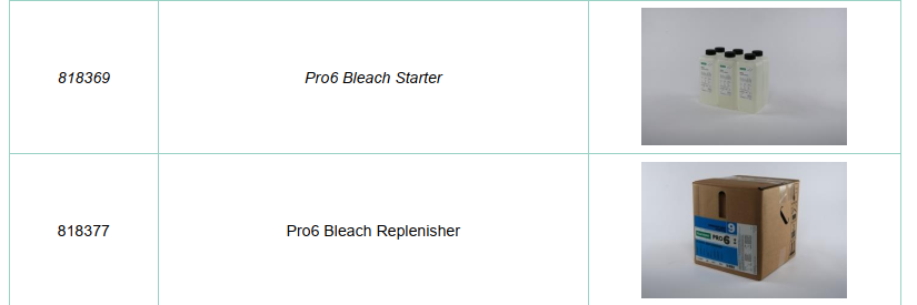

FujiFilm current products:
Any distributor or retailer can order these from Fujifilm.
The Bleach Replenisher does indeed have a high list price if you check e.g. dupli.co.uk (who have it on stock). However, that's for 20L volume, so you could part it out and sell what you don't need to others, and as said it's economical on a per-roll basis due to the high capacity.
FYI this is presently the entire E6 workflow chemistry kit as available from Fuji Hunt in Europe:

PRO6 BLEACHES
CATN° PRODUCT NAME CONC SIZE TO MAKE
818369 Pro6 Bleach Starter 6 x 1 L
818377 Pro6 Bleach Replenisher 20 L cube 40 L

Note the volumes; these are evidently not intended for small tank/home processing, but they can be used in this application if you want.

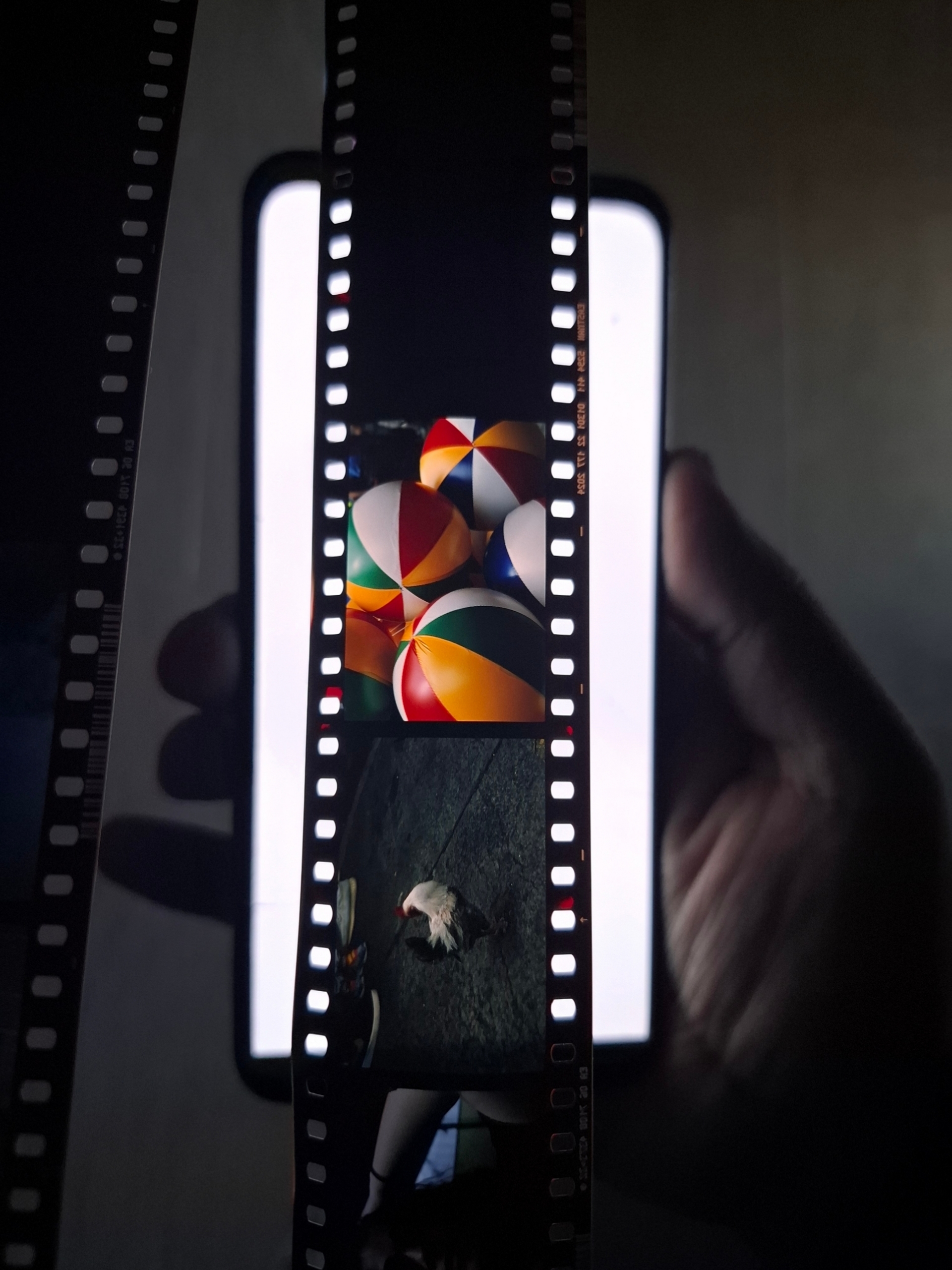

Thanks! I read it a while ago and have already put it into practice with good results in E6 and C41. I haven't tested it, it should work, but since I saw those chemical products for sale, I thought maybe I can avoid precipitating and drying free acid EDTA.

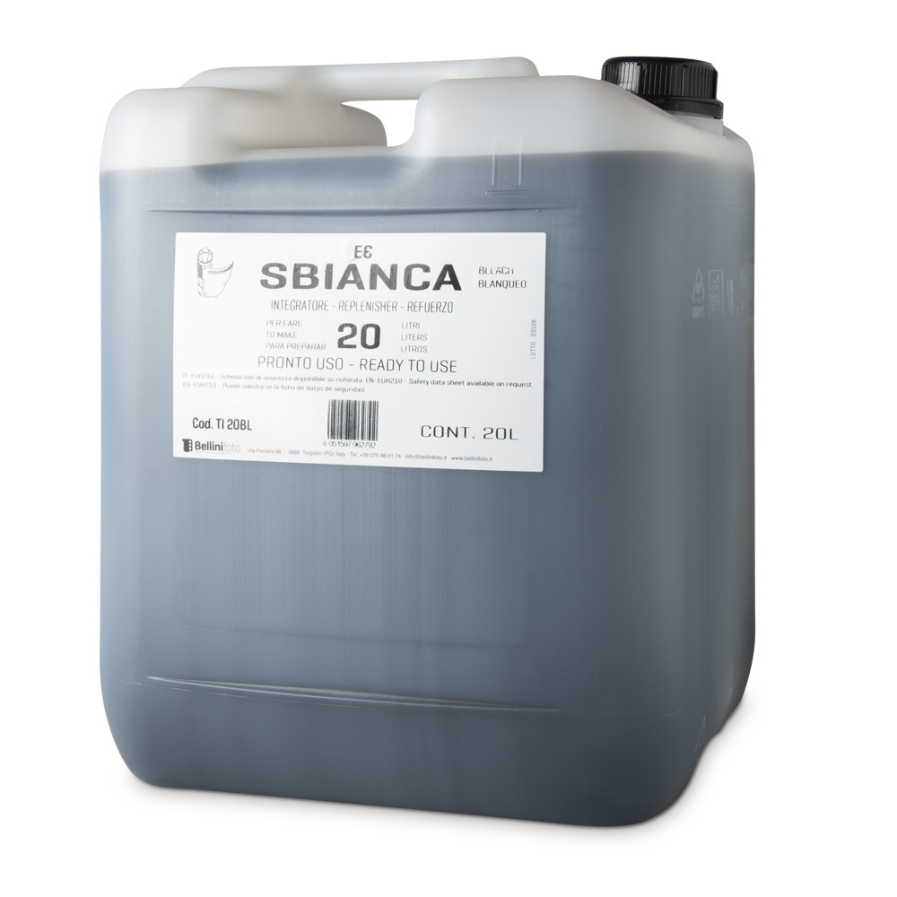

Another possibilty is Bellini, they have 5 liter presentation of E6 bleach-replenisher.
Ask them directly to place an order.
It seemed like a good idea to write about my dramas - Bellini's solution seemed exactly what I needed.
Thanks a lot!

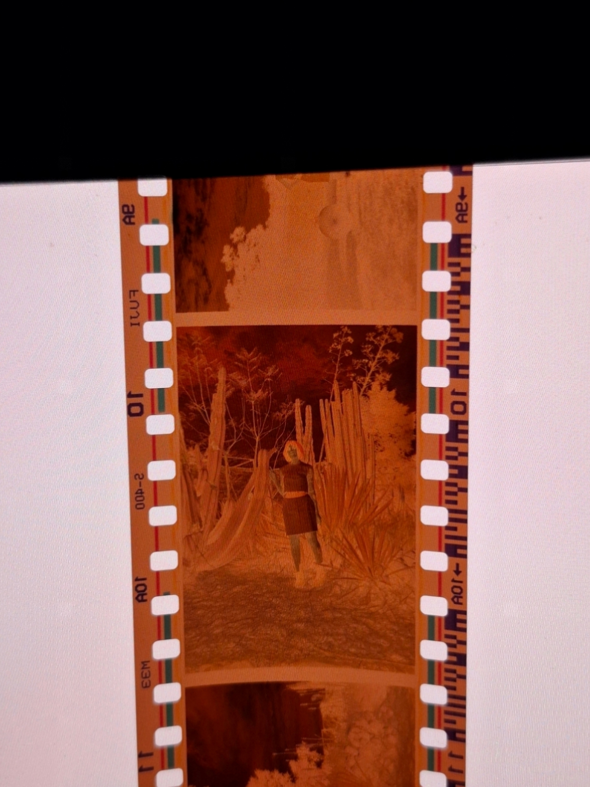

regarding this i did the following: i bought a bag of sodium ferric EDTA and also a bag of PDTA, parentheses here the bag of DTPA is Sodium hydrogen ferric DTPA but lets start with the EDTA. i prepared a saturated solution of sodium ferric EDTA (100-110gr/L) to this i added 15gr of ammonium chloride and ammonia little by little until a pH of 5.8, it seems that by stoichiometry this makes EDTA ferric ammonium salt, but i am a newbie at this so any help is accepted. ah this solution i only added 80gr of ammonium bromide. i developed an E6 film using the formulas i am familiar with and used this bleach that i prepared. I am attaching a photo of the result:
The bleaching time was 6 minutes. I monitored it every 2 minutes and at minute 4 you could already see that the bleach was working correctly.
Regarding DTPA, something different happened, I prepared a saturated solution of Sodium hydrogen ferric DTPA and added 13g of Ammonium Chloride and Ammonia until reaching a pH of 5.8, then added 80g of Ammonium Bromide. A deep red solution with yellow hues was formed and much denser than the EDTA solution, it does not let light through. Even so, I tested it with C41 film directly after the developer, applying a previous stop bath with a pH higher than 4. And yes, it did bleach but it took about 5 minutes to perform a complete bleaching. Here is a photo of the results.
I am hoping that the ammonium chloride is exchanging with the sodium, but it is very likely that nothing is happening and that I am just using 2 halogenated agents instead of one. I don't know, but I do know that it is working.
