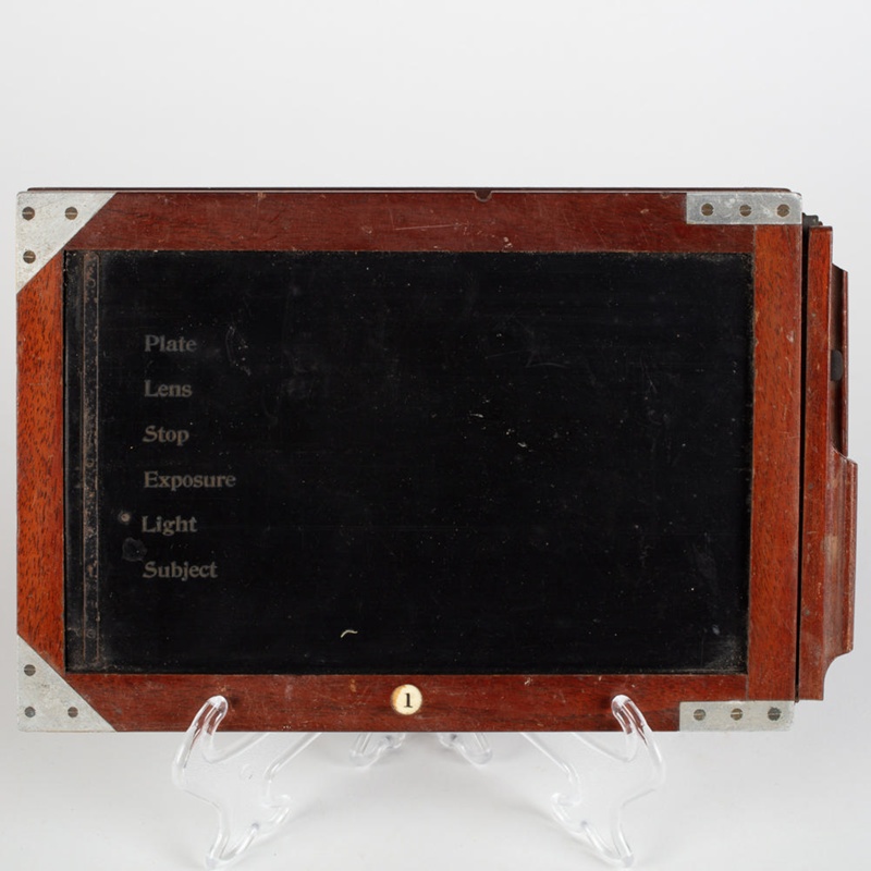

Holders with film go in a black plastic bag. I wrote “unexposed” and “exposed” on each side of my the dark slides. For empty film holders, I keep them in a green bag.
Sorry, I didn't read all 5 pages. My personal rule is to leave empty holders on the shelf, stored in the cupboard inside ziplock bags to protect from dust.
Loaded holders are all numbered sequentially, with sides A and B. I have fifty of various makes and ages (in preparation for a project that never came to fruition, due to COVID).
Darkslides are inserted with white="Ready for Light" and dark="Ready for the Darkroom."
