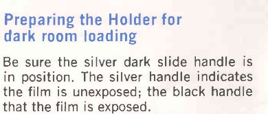

Take only full film holders with you. Never have an empty one in your bag or box. One side of the film slide has bumps (or notches). If those are facing out, it means the film is unexposed. When you expose film, flip the slide so the bumps face in. Always lock the slide.
Well! That's squashed several pages of mysterious, illusory and contradictory discussion on this topic. Sooner or later someone always shows up w/ the goods here, I'm surprised to see it happen so soon. Thanks!

The bumps/notches are on the silver side of the holder. The following is from the Riteway film holder manual:
