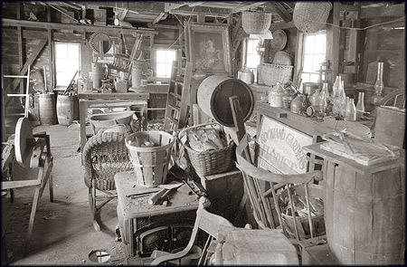

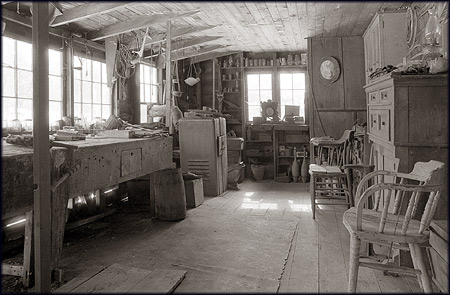

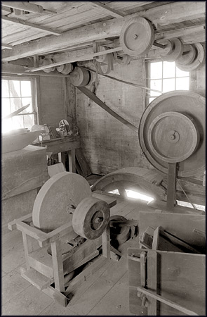

Here are some shots that I took in a very dark mill, lit only by small windows, some of which were within the frame. They could be printed darker to more accurately portray the scene but these were shot as records so I printed for more detail. Tri X is such a malleable film. I rated it at 25 and under developed like crazy and got excellent detail throughout (except for the windows which were light sources). Grain is pretty darned fine that way but if I wanted finer, I think that I might try Efke 50 or 100. Pan F is hard to handle.

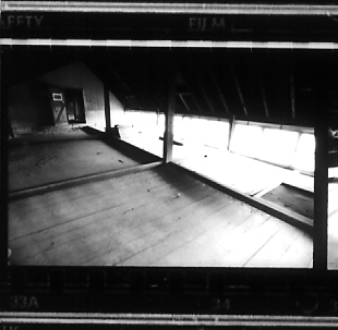

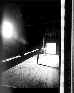

Examples
Here are some examples of the scenes I am talking about. My scanning is atrocious but hopefully it gives you a general idea. These are scans from my contact sheet with no corrections. In other negatives when I expose to get better detail in the shadows, the highlights are completely 100% destroyed (even worse than these examples) My goal is to have perfect exposure and detail in the interior of the building and allow the viewer to see the scene on the outside of the windows as well. As of now the highlights are a black blob on the negative. Hope this gives a better understanding of my dilemma.

I like the strong contrast between the blacks and whites, but then its just me, I never have been much of a follower of the philosophy of "full detail everywhere".
As it is it gives a great mood to the scene with the viewer getting lost inside those mysterious and spooky corridors. Having the view of the outside could take away that foreboding and clistophobic feeling.
Another way you could do it is make two exposure and merge them in the printing.
But that could prove to be too much work.

Daniel,
IMHO I think that you are asking too much. That is a huge range for any film, much less Pan F. Remember that the windows are serving as light sources for the interior. Imagine trying to get detail both in the light bulb and also the object that it is illuminating. The only way that I can see handling a project like that would require artificial lighting and trying to balance more closely to the outdoor light. Lighting building interiors and making them look natural is a pretty specialized area of photography.
