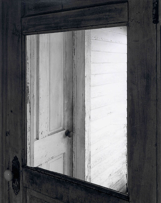

This is an image that I made back in 1988 under those conditions and using the procedures that I have mentioned. Please understand that the JPEG doesn't convey the actual print. It does contain full detail in all areas of the print. I have others just don't have them scanned in the computer at the moment. Hope that this gives you what you are looking for.

Donald Miller said:
Daniel,
Other then the mention that Ansel Adams has in his book "The Negative", I am not aware of any other sources addressing pre-exposure of film. His description does not go into a great deal of detail, in my opinion. Having used this process repeatedly over many years, I can assure you that it will solve your problem. Please send me an email if you lack understanding and I will cover this in detail for you.
There is an example in Barry Thornton's beautiful book "Elements".
Dear Donald,
I enjoyed the photo. A particularly pleasing composition (as well as technical execution). While I wasn't the one looking for the example, I appreciate that you posted it for me.
All that said, there are times when a fellow just needs a few basic darkroom techniques, particularly once the negative is in hand. I'm not sure why you're so dead set against unsharp masking, but based on the situation that was presented in the initial post, I still think it a very reasonable option and it's easy to do. Certainly pre-exposure is a wonderful method, but not every situation, even those with a larger than normal range, require it.

Neal,
Thanks for your kind comments. I posted the image for Neal Williams (Flotsam) per his request.
I am not dead set against unsharp masking...in fact a form of unsharp masking called a contrast reduction mask will suffice in some situations. I have found that a conventional unsharp mask will best work with a peak density of .35 (that seems to also be what Howard Bond has found)...perhaps a contrast reduction mask could go as high as .45. That still amounts to about a zone and one third contraction...altered development will give about a maximum of two zones of contraction before the highlights get really congested and lack separation. So between the two one could hopefully effect a total of N minus three and one third. Some of these interior shots with brightly lit exterior openings will need N minus five or six in order to hold the film density on paper.

Donald, I remember when you posted that in the gallery. Not only a wonderful shot but a great illustration of capturing an extended tonal range. How much pre-exposure can you give it before it juast greys the frame without helping the highlights?
Flotsam said:
Yeah Neal, You're not the only one with that damnably mis-spellable name :D
Neal,
The maximum that I have given is the equivalent of a Zone IV pre-exposure to non image bearing light. More normally I work with a Zone II or III pre-exposure value. It all depends on the amount of compression that one needs.
I don't understand your comment about graying the frame and helping the highlights. What we do in pre-exposure is that we add proportionally more exposure to the shadow values and then we meter the highlights to place them at a Zone VIII valuation. Thus we are actually exposing the highlights for less then we would in a single conventional exposure.
A typical single exposure would place the shadows at a zone III or IV and the high lights in a SBR of 12 would fall on Zone XV or XVI. That is why the highlight regions are blown out.
In pre-exposure we are adding a Zone III or IV pre-exposure to the low values...with little proportional effect on the highlights and then we expose the highlights at Zone VIII. That will allow the highlights to print properly and the shadows will have the exposure that we want.
The compression occurs in the shadow regions rather then in the highlight regions as in the case of altered development. I believe that normal human visual perception is more accepting of shadow compression then it is of highlight compression. We expect to see shadows be less well defined then we do highlights.
