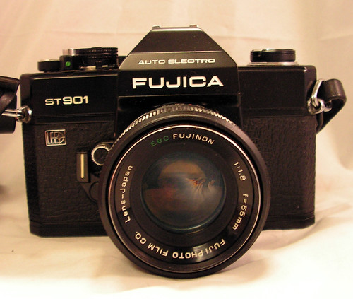

Thinking about Pentax, what about Fuji M42 bodies, the ST801, top shutter speed of 1/2000, or the 701 which had silicon meter, but lower top shutter speed of 1/1000, the last Fuji M42 901 with a electronic shutter, down side to the 901 is that it used a modified M42 lens and need to hearing aid batteries. When using Pentax and other M42 lens had to use stop down metering. Fuji M42 EBC were some of the best of all the M42 lens.
