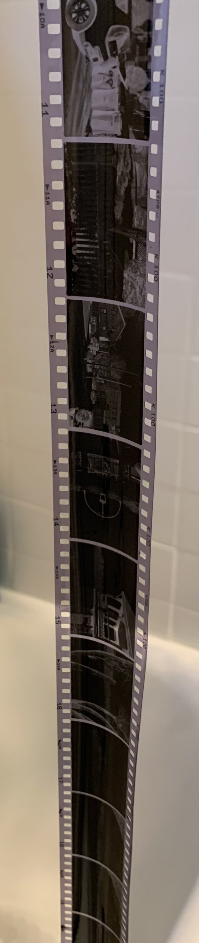

Ok, just developed my test roll and waiting for it to dry. Stupidly saved the 35/2.8 for last and only got one shot with it - and that's the lens I was most interested in! Interestingly, film transport seems wonky for the first 10 or so shots, with a couple of big gaps and then 3 serious overlaps:

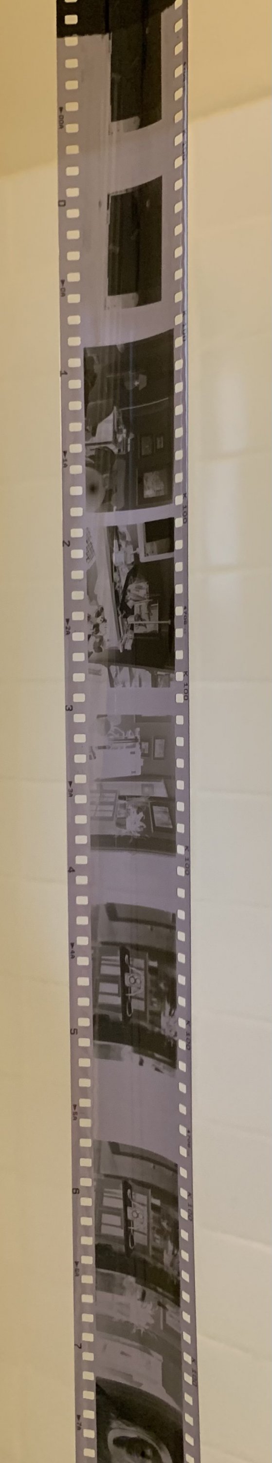

But then it's totally fine after that:
I wonder if that's down to tension in the beginning that resolved itself. Also, I felt nearly no resistance at the end of the roll but did feel the sprockets not catching. Wound up triple exposing at the end like an idiot!
