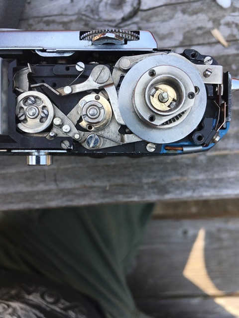

I repaired my own but did not go below this deck (shutter was basically working but did not always fire.)
It is a very difficult operation and the guys who help you will chastise you for leaving any tool marks. So good tools and technique is important. A Dremel with some polishing tools is good too, because you will need to dress inevitable tool marks.
I lost one screw while polishing it, flew in the air and into the garden. I thought I was clever using a magnet to try to find it, but it was brass.
If you lift the wind knob up as you press the shutter release will it fire? If you use the self-timer will it fire?
