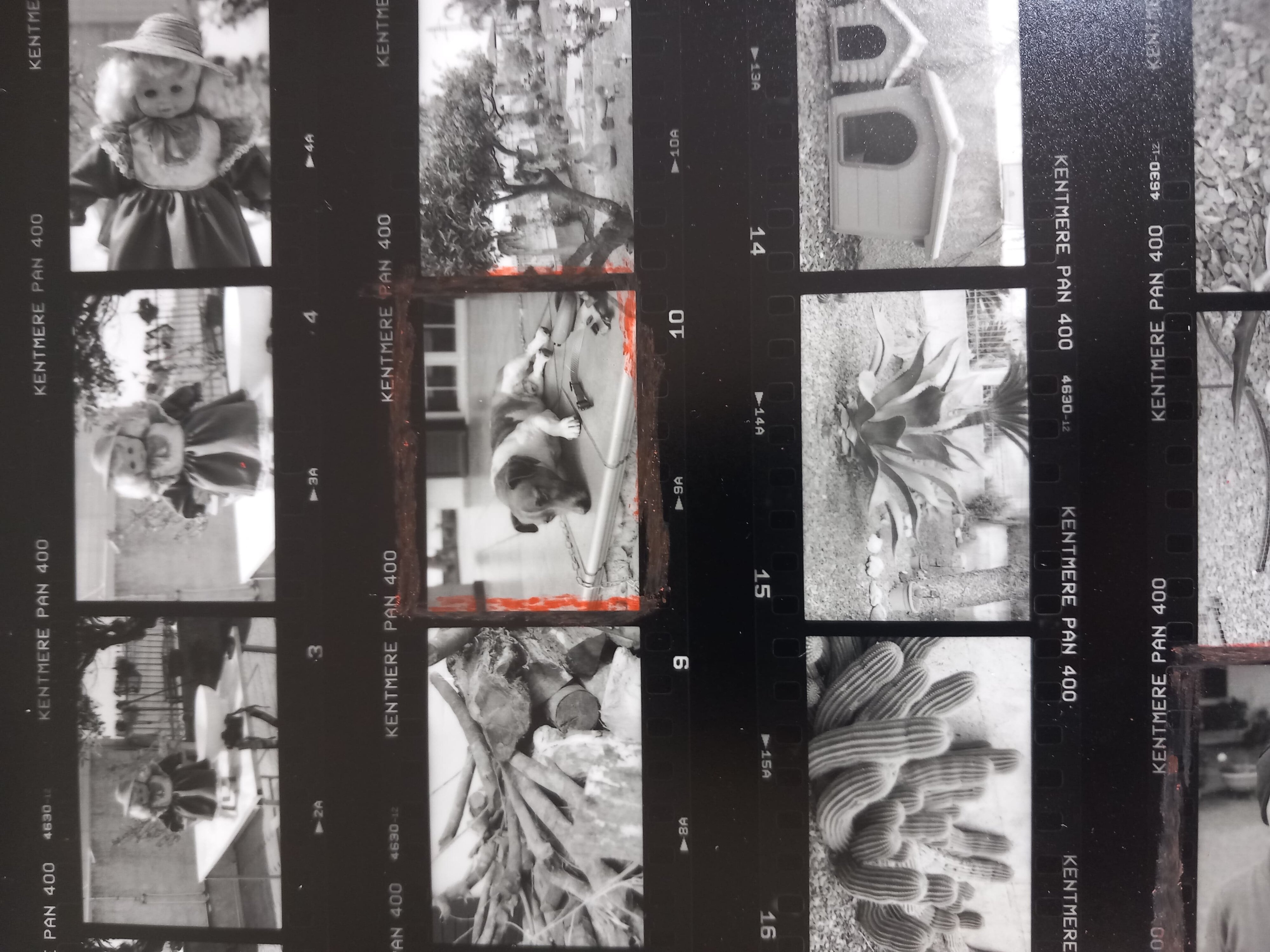

As you can see the bottom rebate are less exposed.
Maybe I should try to raise the enalarger more so it cover all the baseboard size? Lens is stopped 3 stop...
Of course they are from the same roll and I put a glass on them.

I don't really see it, sorry. If you have uneven illumination, then try:
* Raising the enlarger head to project a larger image circle
* Use the focus adjustment to move the lens further away from the light source, which increases coverage
* Stop down 2 stops from wide open on the enlarger lens.

If you look in the first negative strip, the sprocket holes are barely visible from the black of the film rebate, while in the last two of the roll, they are visible (so with less exposure).
I will try to raise the head much more and adjust focus to see if the exposure became consistent across all the strips of the contact.

If you use a 50mm enlarging lens to make your contact sheet, make sure the negative holder is in there. That's insurance against light drop-off.
All the points above about uneven light are the most likely source for the problem.
I'll just add one question: Are you developing the contact proof print for a sufficiently long time?
More than necessary exposure, plus less than ideal development tends to lead to inconsistency.
