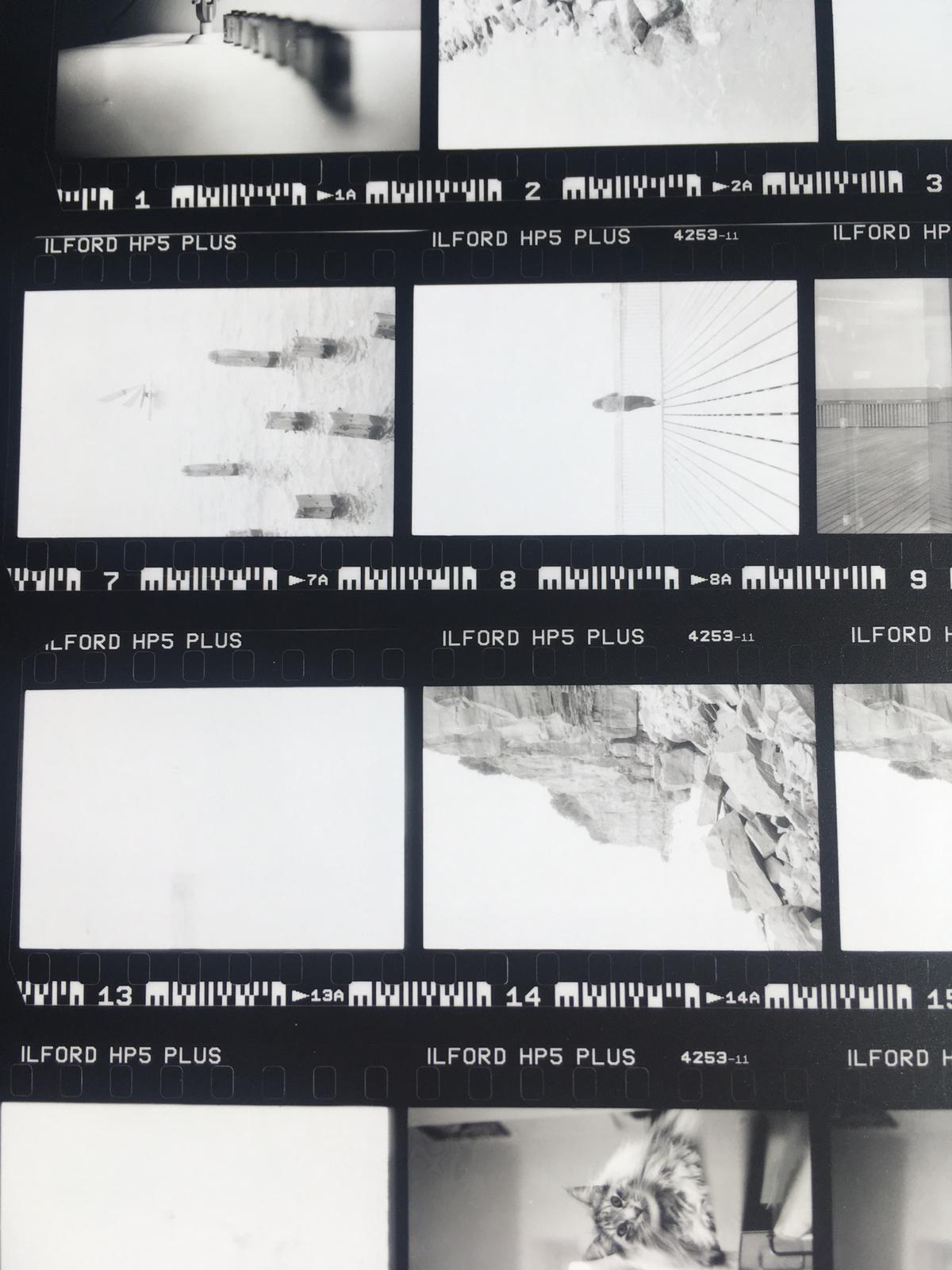

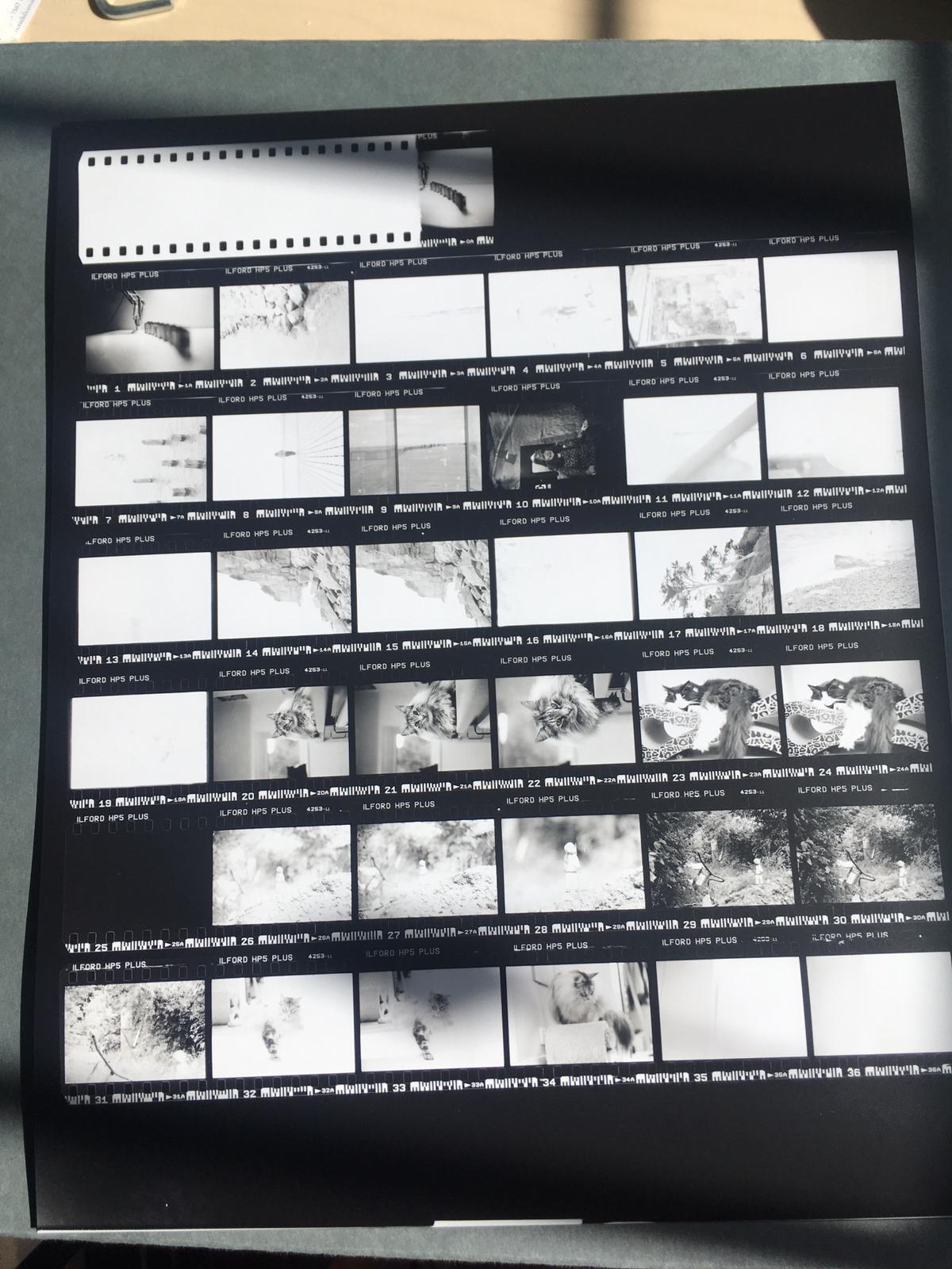

I have a question as I’ve managed to completely confuse myself after spending quite a long time thinking I had a firm understanding of it all. Ive been shooting film again for last year and a half and develop it at home. Up until recently I purely scanned my negs and whilst there would be a few tricky customers (over exposed, dense negatives) overall metering didn’t seem a big problem using an incident meter in the classical sense - meter for shadows, aimed at camera / sometimes shade lumisphere as shadow surrogate.
However I recently started darkroom printing again – the confusion has arisen from making contact sheets again. I have used the method shown to me by exposing the contacts to achieve the minimum level of black around the sprocket holes. I was very surprised to see that lots of my dense negatives were pure white frames on the contacts which seem to suggest some kind large exposure error even though there are a lot of online articles extolling the virtues that bw film has a big latitude range and I’ve followed guidelines for basic incident meter use as far as I know. I also know people like Ralph Gibson prefer dense negatives and the old adage of expose for the shadows.
It seems like a common problem is people underexposing bw film and shooting in low light – weirdly I’ve found out I’m fine guessing low light exposures but seem to be overexposing sunlit / daylight shots using an incident meter which should be fairly fool proof. I guess my question is have you ever found the overexposed negatives just to be blank frames on contacts and is this a darkroom issue or a metering issue. I have also thought about refining my incident meter technique if I know I’m overexposing in daylight by not exposing for shadows or angling slightly more towards light areas to balance out – I’m aware this is unconventional but struggling to work out why those contact frames are white when contacts have been produced in correct way :S
Ive attached a few of the worst offenders, I did about 30 contacts and some were ok but regular problem with incident metering in daylight / sky blown out. I have a basic understanding of zone system and don't know if id be better off going reflected readings.
Many thanks

I'm not sure what you mean by "minimum level of black". What you want to find is the minimum time to maximum black. The best way to do this is by using an unexposed (but developed) frame. Set up your enlarger so it casts enough light to cover an entire sheet of 8x10 paper. Set your aperture to 5.6 or 8. Then, do a test strip of the unexposed sheet. Once developed you'll be able to see the differences between the strips until you get to where 2 strips look the same. The time on the second strip is your minimum time to maximum black. Mark your enlarger height at the height you've run the test, and always use that height and f-stop for all of your contact sheets. You'll get consistent results, but it will also tell you if there's any variation in your processing method, as well as alerting you to any potential variations in your camera's shutter speed.

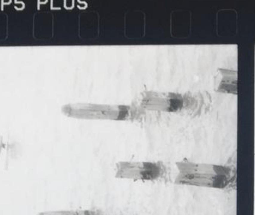

Seems to me that you haven't quite found minimum time to maximum black. I can see that the sprocket holes are a deeper black than the film rebate.

In addition, those contact sheets look really contrasty - you may have over-developed your film.

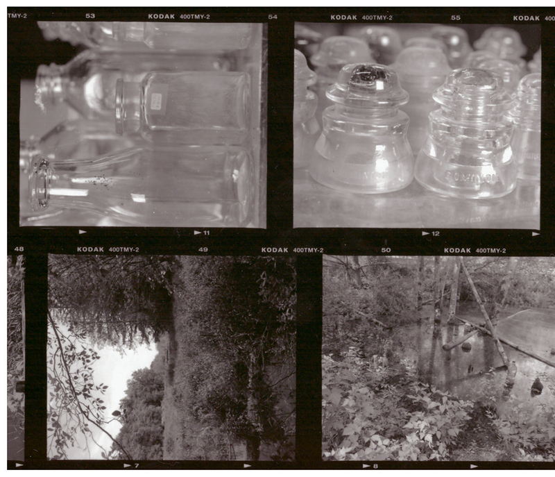

Here is an excerpt from a Contact Sheet that I consider to be both appropriately produced, and from appropriately exposed and developed negatives:
And yes, I have lots of contact sheets that don't look this nice :redface:.
The advice to overexpose film by a stop is good for a bunch of different reasons. But it is inconsistent with the idea of contact printing with minimum time to maximum black. Don't worry. You would just need to add about half stop of contact printing exposure to correct for having overexposed your negatives slightly.
Though people who look at critical sharpness and resolution will think that one stop overexposure degrades the print from a 35mm negative, I don't think the degradation is worth the risk (when you try to perfectly expose every time and mess up) of underexposure. Because underexposure ruins a negative pretty seriously.
Aiming for minimum time for maximum black is part of a "Fred Picker" idea to make a "Proper Proof" that proves the best exposure index to use.

A "proper proof," i.e., minimum time for maximum black of the rebate is a great tool for evaluating your exposure and development. It isn't and shouldn't be thought of as a finished print. Getting the right proper proof is more than just finding the exposure time for maximum black. First, you really need to decide what maximum black is. Depending you your viewing light, the "maximum black" will vary quite a bit. If you evaluate your proof under sunlight you'll end up exposing your proof for way too long; vice-versa with dim viewing light. Use a light source that is an average of the display lighting you prefer and find an exposure time that just gives you an almost imperceptible difference between the film rebate and the black of the uncovered paper. Use a paper contrast that is your target contrast or just slightly less, keeping in mind that properly exposed highlights will appear a bit greyer in the proof in the latter case. And, use a paper that you would use for display prints. Papers are different; there's no use proofing on one kind and printing on another. Once you get the proof nailed down, you will see how you need to adjust your exposure and development.
If, as in the case of the OP, you have grossly overexposed proofs (almost all white), then start looking for problems with metering, the meter itself, the shutter, etc. (It seems to me that the OP is overexposing because no adjustment is being made for basing the exposure on a shadow value, which will result in 2-3 stops overexposure.) It's especially important for smaller film formats that you expose properly. With LF, the problem is less; I've made great prints from negatives that proofed almost completely white. With smaller formats, however, the print will show the grain more with overexposure. The opposite happens as well: no shadow detail in the proof means you need more exposure, so adjust metering technique / E.I. accordingly.
I use my proofs to make small tweaks to my negative development times as well: a regime that gives me consistently underdeveloped negs gets a longer time and vice-versa.

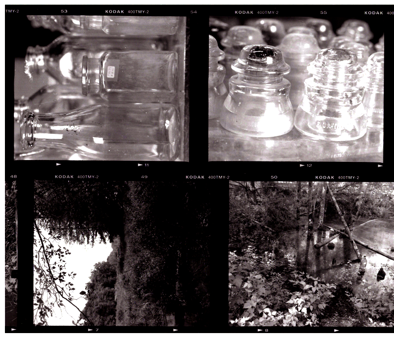

By the way, the images below are simply the contact sheet image I linked to earlier, plus another version resulting from about 20 seconds of post processing adjustments:
I like to produce my contact prints with a much lower contrast than what I would normally print at. It gives me a much better visual indication of what I can do with a negative.
