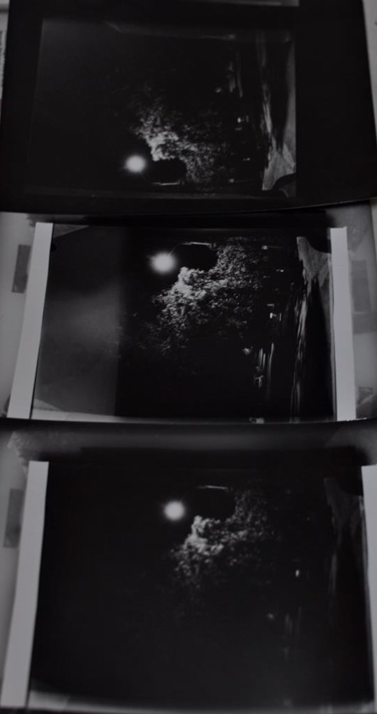

Right I tried Dektol 1:3 as well (again), freshly mixed and at 45-50s I am more or less forced to pull the print out. Its been a couple of days since, so I will try that 1:3 solution again tonight :D Will also test with some more diluted solutions.
The attached images were all printed with 1:7, from a (very) thin negative at ~25C (exact temp is in my notes +-1C). The one on the right is the first print, the middle one was where I experimented with dodging - and the one on the left is one where I more or less got the print as I wanted for the shadows with burning at the bottom.

Whoa! You have not been removing the prints from the developer before they have completed development? If that is the case then we have found the problem.
Oh, no no! I got deep blacks by 15s-20s or so and by 45s- 1 min, I would see the print tend to go black in the grey-er areas too - except for prints from very dense negatives, which did good with 1 min+

You need to develop the paper to completion. This means you do not rip the print out of the developer when it 'looks right'. You need to control the print density by the exposure. So, if once developed to completion, the print is too dark, you need to reduce exposure.
To reduce exposure when contact printing you can:
- reduce time of exposure
- reduce brightness of bulb
- move light further away from paper
- introduce a filter to decrease amount of light
- do a combination/all of the above
My suggestions:
- mix Dektol 1:3
- reduce expose (using whatever method you can)
- develop for the full recommended minute
- rinse & repeat until :smile: (you probably want an exposure time about 10 seconds as different negs will need adjustments)
