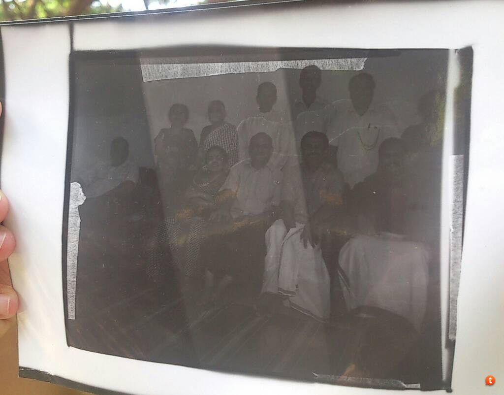

I realised I probably communicated this wrongly, so heres an actual print -
Taken via my phone (low Res)
What I realise I meant was that the prints weren't coming out at the right contrast levels.
Thats what the greys were.
So, would this be more development or more paper exposure thats required?
Thanks!

hi analoguey
i think you might have misread what people are suggesting using
dilute dektol ( 1:7 &c ) for ... people typically use those
dilutions when using dektol to process FILM, not paper .. with paper
it is usually used as recommended by others in this thread ...
do you do test strips tofigure your light and exposure ?
together with stronger developer it might help you get better prints ..
have fun!
john

The exposure should be enough to show as completely black at the film edges just outside of the image area. Ideally, you want just enough exposure to get the edges completely black, and no more.
This is assuming that you're processing the print in fresh, active developer. Your 1:7 dilution may or may not be active enough to accomplish that.
Assuming it is, and the image of the area of the print is too dark, it would be an indication that the negative was underexposed in the camera, or possibly under developed. In that case, you may be able to get an acceptable print by reducing the paper exposure, and using a higher grade filter or paper.
Start with an exposure reduction of 1 stop, and adjust from there. Note that if the underexposure is severe, you may not be able to get a true back at the edges without making the whole image too dark.
Sounds to me like dilution and temperture combined to cause this problem. Dektol does, in fact, oxidise rapidly at temps higher than recommended by Kodak. Making Dektol too dilute exhausts it rapidly as well. Large image areas require a minimum amount of chem to develope a full range of tones. Contact prints from 6x6cm negatives will do well in dilute solution, but an 8x10 inch requires tremendously more. Maybe the OP should change developers to LPD which may be diluted and still retain useful properties even at higher temps.
IDK, I think maybe there was a reason Kodak developed "tropical" developers for these high temp climates.
Right, I did use this a couple of weeks after I had made the working solution so maybe temperature had effect on oxidation.

The developer was not only overly dilute, but two weeks after mixing the working solution you are lucky it had any life left at all. It should be diluted 1+2 or 1+3 IMMEDIATELY PRIOR TO USE!
Try reading the Kodak directions for Dektol rather than items on here referring to using the developer for processes different from those for which it was designed.
this advice does not seem to be sinking in Jim. I agree with what you say.
If the ambient temperature is above 30C (quite likely over much of India) then Dektol is clearly not the best developer choice. But what is?
I recall there being special-purpose tropical film-developers, for use at high temperatures, but is there a readily available (in India) paper-developer for the same purpose, or a restrainer that could be added to a standard developer? These might help the OP's temperature problem, for developing the contact prints. It would be helpful to see the negative(s) which are giving these results too.
To make it completely clear, high-temperature extremely diluted Dektol will be of unusable quality in an hour or so.

The dev is clapped out (oxidised) end of story.
