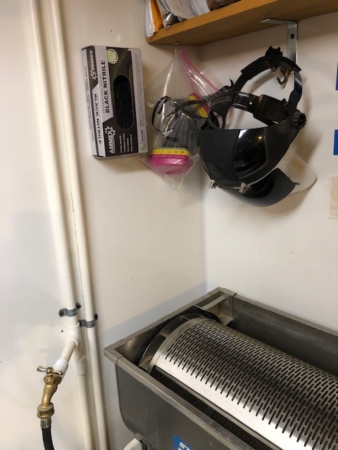

VinceInMT
Nov 14, 2017
1,937
Montana, USA
Gloves: Check
Respirator: Check
Face shield: Check
