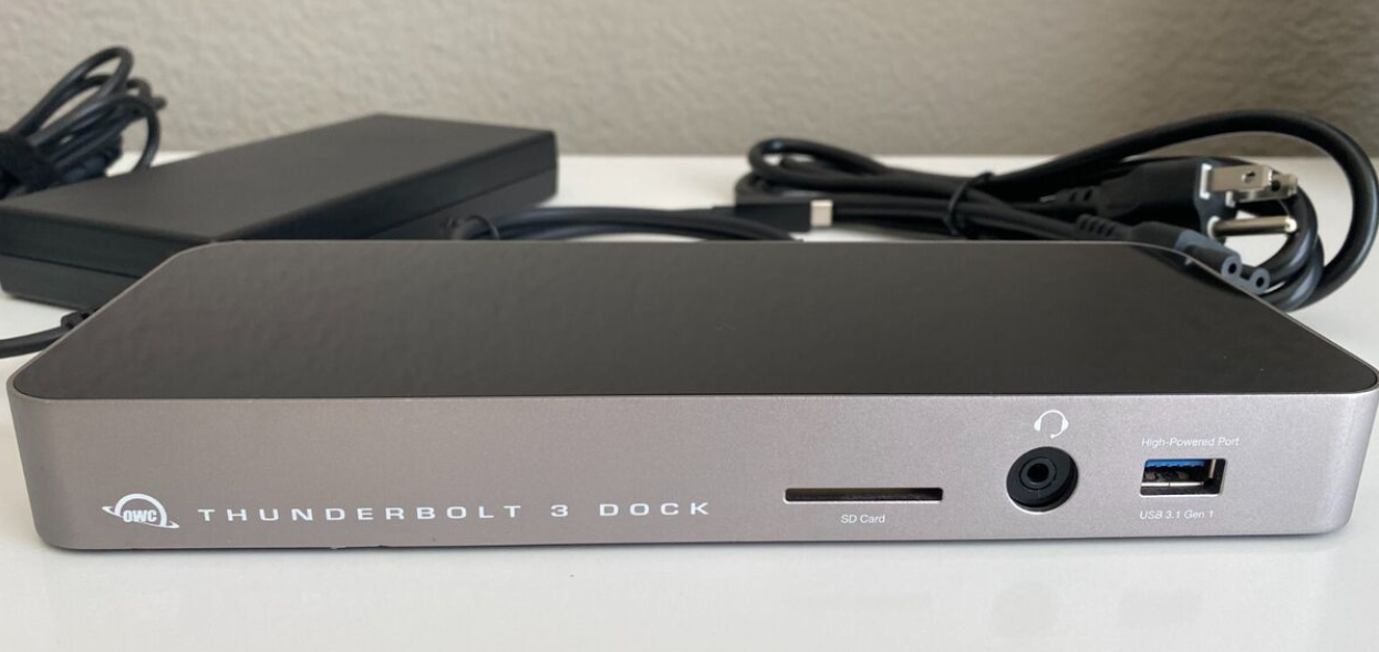

If your computer has a thunderbolt port, a daisy chain of adapters should work. HOWEVER, I have encountered thunderbolt compatibles laptops that will not recognize this daisy chain for whatever reasons.
The solution that I found is getting an old OWC thunderbolt 3 USB dock. Did the trick for me.

I also gave you another solution. That even might be cheaper (but not cheap). This.
Works perfectly for me with a computer whose thunderbolt port wasn't working either with my daisy chained Coolscan. Try it. And resell it if it doesn't work, they're kind of rare and looked after.
