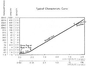

Hi there,
the simulation of analog films I am writing uses film density curves, and I'm wondering about their representation.
Some curves are presented as a nice "S", while others often skip the shoulder part, and even some don't really show the entire toe part.
I read somewhere that the shoulder part is not very important, this is why it is not represented, but for me it still contains some information concerning the highlights. It is the same for the toe which is used for shadows.
My simulation uses D-min and D-max to use the full gray scale. So when I am using the curves to discretize them (i.e. save some curves coordinates in a file to simulate them later), should I complete what is missing ?
If I am not wrong, how much should I "add" to the curves, for the y axis (density)?

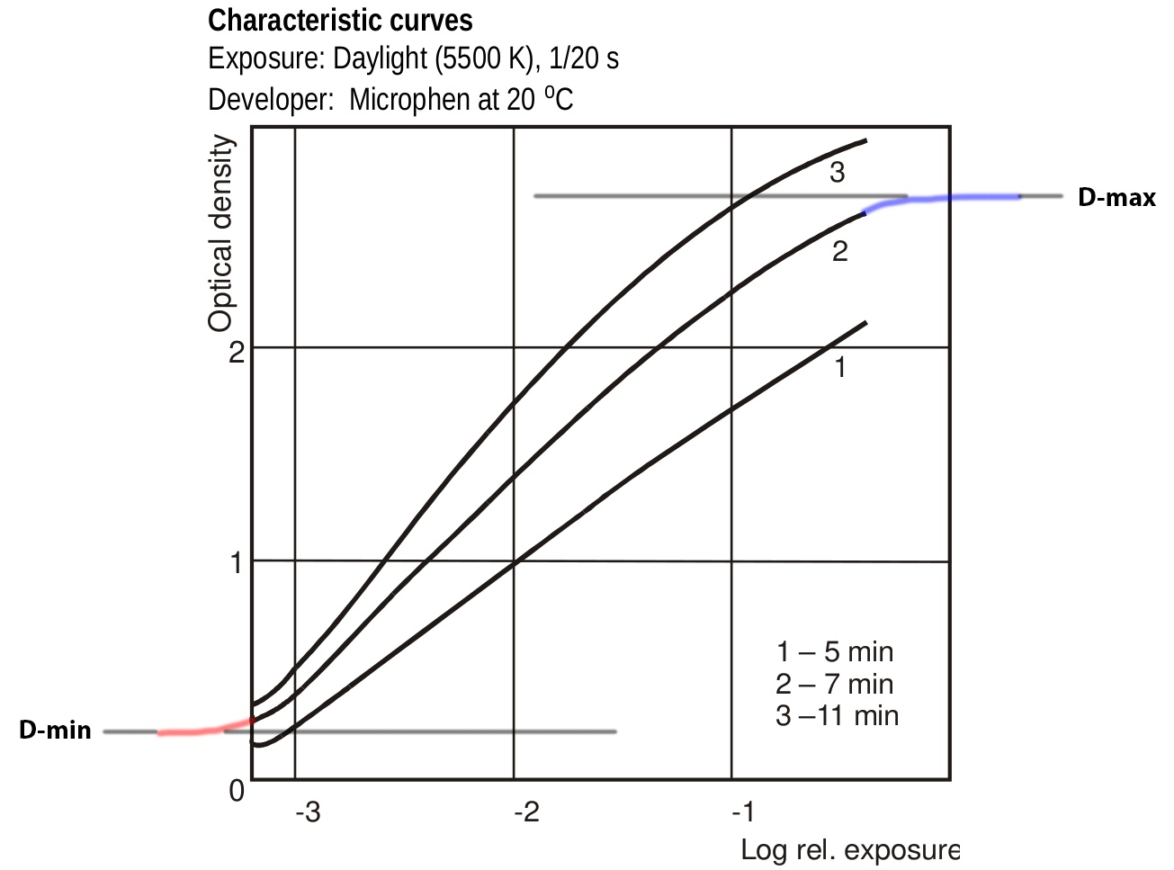

Here is an example with Fomapan 100, curve #2:
The red line would be the addition for the toe, and blue for the shoulder.
Does that make sense to you ?
You're correct that manufacturers don't give you the complete line(s) -- just what part they think is important. If you want a more complete line, you have options. Maybe there are expanded lines somewhere -- good luck with that.
My suggestion would be to create your own. That's much more work, but it more accurate because it uses your chemicals and gear instead of the manufacturer's lab.
Another is to use math to predict where the lines will go, but you have to have a way of getting all the data points on the line into the mathematical formulas -- and after that, there are many formulas that you need to choose from. They will all give you different results -- predictions of where the lines would go -- quadratic, cubic, etc.
So if you really, REALLY. REALLY have convinced yourself that you need the expanded lines, do your own tests.
Thanks for this. I already have the knowledge and the tools to perform basic maths. For the "real" thing, I don't have the equipment.
It is just that I have to decide how much should I go for the toe and shoulder on the density axis.
For the toe : in the case above it is not difficult to complete the line, the lowest curve (1) gives a hint to what D-min should be. But if I had only say the 3rd curve just to decide, it would be more difficult.
For the shoulder: surely the manufacturers cut the curve just at the end of the straight line, so there's no way to really know how much higher the curve should go?
I can also do stats, I already have entered many B&W density curves.
But if other people have hints to help me decide...
It is usually not practical to measure the shouder, but it indeed is important.
The shoulder is represented by the faint and clear portions of the common 21 step wedge. The exposure of the film in that area can't increase without making the sensitometer light 20 to 100 times brighter to obtain the data to graph the shoulder.
Making the sensitometer light 20 to 100 times brighter, while maintaining exposure time and color temperature, is not usually practical. Thus, the shoulder of the curve is usually cut off as there is insufficient data.
To fit the curve on a control strip, most sensitometers have a way of adjusting the exposure for the ISO/ASA range in which one has an interest in graphing.

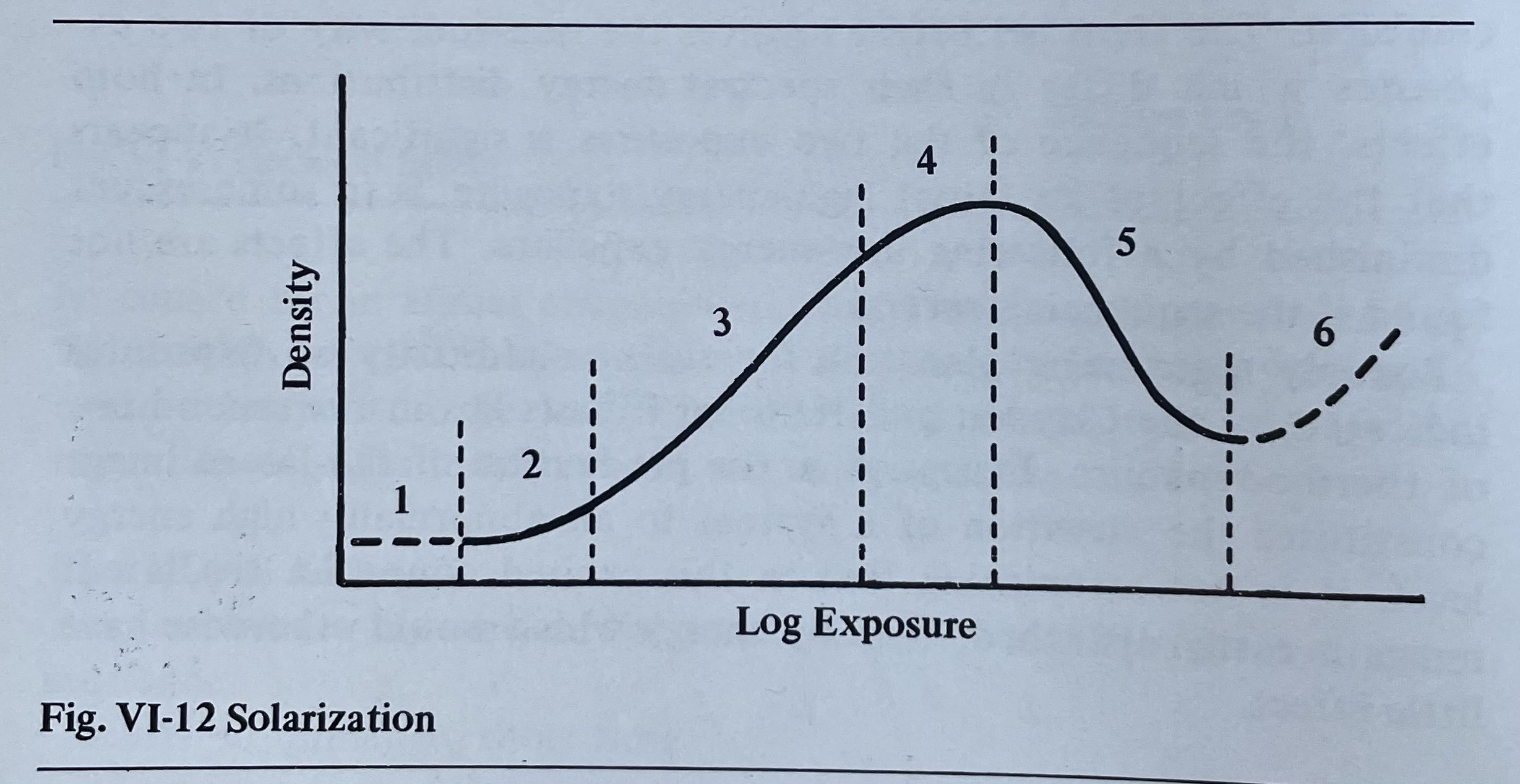

As exposure increases to a thousands of times greater exposure than normal, there is often reversal (and sometimes a cycle back and forth of reversal and re-reversal).
From Mees Theory of the Photographic Process. (that you can find in its entirety for free online)
But couldn’t physical analysis predict it?
I'm with @xkaes on this:
I assume that quite a bit of research was done to understand the effects and on that basis, I imagine it's to an extent possible to model it. But looking at the family of curves @Bill Burk has posted above makes it clear enough for me that it's probably darn complex.

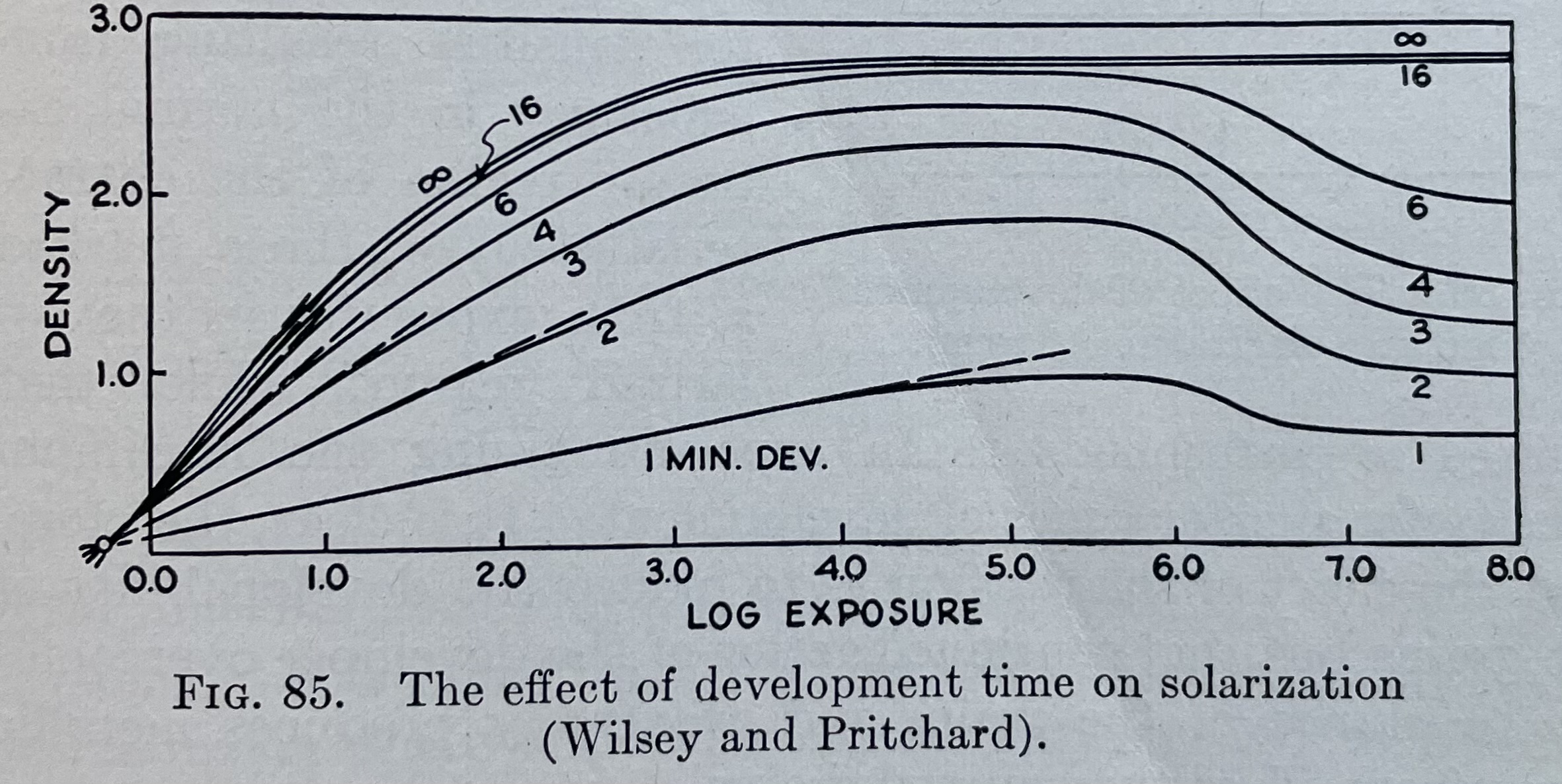

Another stylized graph illustrating reversal and re-reversal. This from Todd-Zakia Photographic Sensitometry
Some film or paper is designed specifically to do this on purpose, for example photobooth paper where you sit still where bright light hit you and your friend in the face.
Solarization can be simulated on my system, I just have to enter the curve(s) coordinates and try them. The graph from Mees' book is perfect for that :smile:

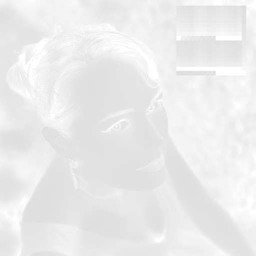

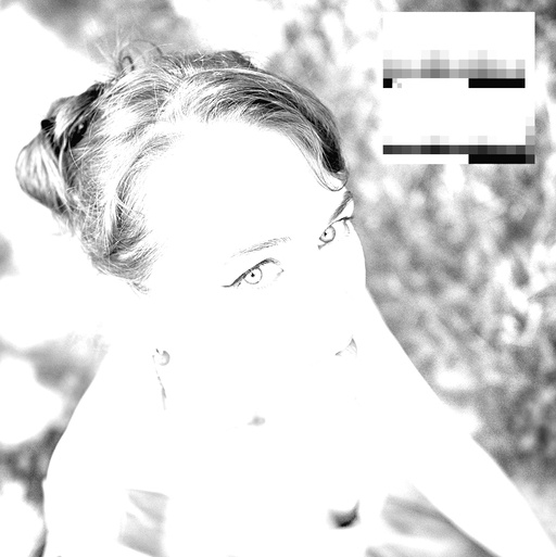

Solarization simulation test ! I saved the coordinates of the curve from Mee's book, used a flat spectral chart.
Here is the test image (her name is Typhaine), with a nice palette for reference:
This is what the simulated shot looks like with Mee's book's curve (ref exposure = 0)
+1 exposure = burned
+6 exposure = solarized
This is almost a negative! I reversed it in GIMP and it looks like a dark version of the "normal" processed photo.
+6 exposure is a LOT, the interface of my program was not ready for this, so I had to tweak it a little temporarily.
Blacks stayed white because they didn't get past the drop.
What do you think?

I'm surprised that your +1 comes out so light - but then again, let's not forget you're starting with a high-gamma digital file, which is a bit like working with a slide instead of a negative.
The plain/straight B&W conversion is really pretty good although I wonder if the toe behavior is maybe a bit too abrupt. It feels like film being underexposed by 1-1.5 stops or so.
You're right!
In my program the exposure numbers are shifted to relative representation, and spectral charts are normalized, and on Mee's chart the curves starts at a negative number.
All in all in this precise case, I think you are right the 1st simulated photo base exposure must be around 1. The internal numbers used in my simulation are indeed weird.
I underexposed it a bit for the blacks to stay white when the solarization strikes, plus I added a little more exposure time with base exposure = 0 to boost even more the total exposure!
:wink:
