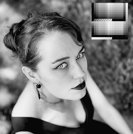

I am using "basic" image files, but my system works in the OKHSL color space, which implies : RGB -> linear RGB -> XYZ -> OKHSL - so the "gray" data from the image is linear. I chose OKHSL because the whites - blacks - grays are well distributed on the gray scale.
But, yes, I could use RAW files too, but I chose not to for now. Later surely, to have better precision.

Yes, it originated from Björn, but as he published it with a "libre" license, OKLAB (and derivatives) found its way in the last CSS specifications, and even very quickly in some Photoshop functions in 2021 using color gradients.
I studied this color space, and it was waaay better than CIE Lab*, in terms of computation complexity, color space uniformity, and color distances computation that are just an euclidian distance vs CIE's infamous CIE DE2000 function (patches on patches instead of reconsidering the CIE Lab* base, and that's what Björn exactly did).
It also looks like you have “reversed” each image, turning it into a positive
Yes, I am aware and convinced that a photo is something that has to be "printed" (errrm, developped). It will be easy for me to add the final step with general print paper curves with the possibility to vary the effects (more or less contrast, tinting, etc) + even adding an "outside" aspect (glossy, matte). In fact my system is already modular, it is just that for the moment I am focusing on the "pure" film part. The rest will come after.
And by the way, the original question (completing density curves) is resolved, now that I can use the density curves "as is" without modifications, once again thanks to you all, it made me thnk the right way.

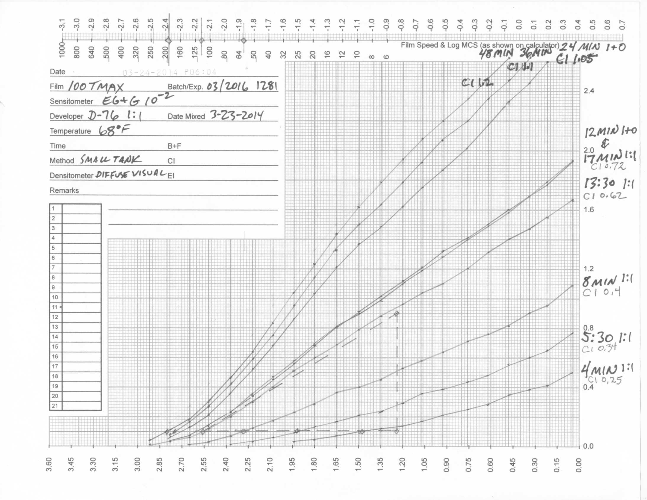

If you don't have a densitometer you could use a digital camera to simulate one. It would take a few accessories (a cheap microscope objective, extension tubes, a couple of adapters, and some sort of light table).
I explained how to do this in a thread titled "Using a digital camera as a densitometer", started July 11, 2022.
My thought is that you would not need to take many measurements in order to draw in the approximate shape of the curve. Just measure the base plus fog for the appropriate development conditions, and then sort of eyeball the shape of the curve between the curves that Foma gives and the base plus fog region. This should get you a not-too-terrible result for the toe region.
The high density region is a little trickier, but you could measure the density for a heavily fairly over-exposed film developed for the conditions that Foma lists. I would probably avoid doing it for an extremely over-exposed region. I don't know, but maybe few stops (perhaps ~4 stops?) above the upper end of the curve that Foma lists. You will want to avoid the exposure region likely to give density reversal. That would give you a fairly good value for the maximum density. Then eyeball the shape of the curve going from the curves that Foma gives and the max densities that you measure for the different development conditions.
The scheme outlined above would give only an approximate result, but it would probably be a useful result, especially for regions of the curve that are not too far off from the ends of the curves that Foma gives, and it would probably be more accurate in the toe than in the shoulder.

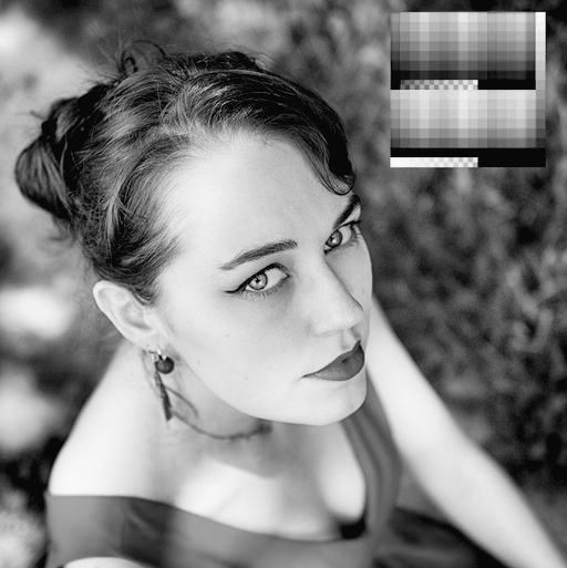

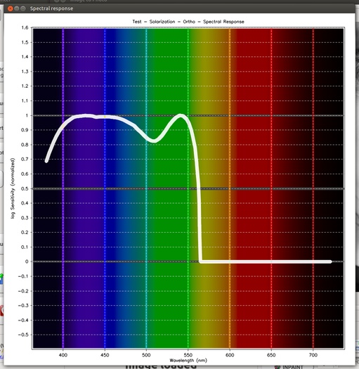

You asked for it... here is the same photo with Mees' book's density curve and Ilford Ortho Plus spectral data.
Is it ortho enough for your taste? -> the red lips and the dress are now almost black. And she has even more fantastic eyes 😋
Bonus: the ortho plus spectral chart I used (this is from the interface of the program) - as you can see my spectral data is always normalized because manufacturers don't present data the same say. That's the reason why I can't have "real" values for exposure.

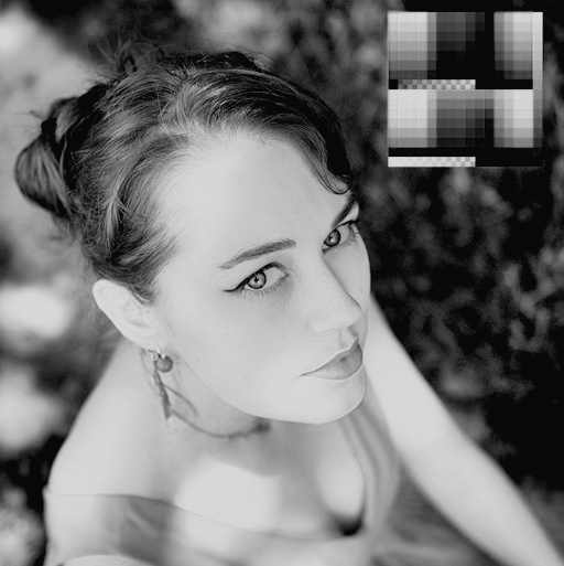

Now with a Ilford HP5+ spectral chart, and the same Mees' book's curve
And just for fun the same with a Hoya R1 filter (red) - yes I implemented color filters too, I did all the interesting actual Hoya filters, excluding ND ones (22 of them), and all old Wratten filters I could get data for (128 of them). For the wratten filters I extracted all the data in the charts from an old Kodak PDF file, semi-automatically. Thanks Linux and all the marvelous tools you can find for this sort of things!
Now Typhaine looks a bit out of this world.

I am wondering what algorithm you used to implement filters
I am already using spectral data for the films (you saw ortho and panchro example), so all I had to do was to find a way to combine with it the spectral data of (color) filters. This kind of data is easily available from the manufacturers' technical documents. These ones are NOT normalized because the amount at each wavelength is important (for example a 20% red filter vs a 50% one).
I am also thinking about the possibility to change the light source (daylight, tungsten, etc), this is all about spectral data too. For the moment I am just using a "flat" spectral curve.

Your Ortho and Panchromatic examples look very convincing. I would like to understand how the spectral sensitivity curve of a film or film with a filter is applied to the input RGB image. I tried to figure out how to convert from (r, g, b) to wavelength but could not find a satisfactory solution.
AbsurdePhoton
AbsurdePhoton
May 13, 2024
72
Paris, France
Ah, this a good question, how to go from RGB to spectral, much debated. There are naive solutions (that almost work) and complicated solutions (too much computing power is needed). Always go the "way of the middle"...
For the rest: even for B&W results, I take the RGB color values of each original image pixel (linear values, in fact an intensity). I compute from this their wavelength levels, discretized with a 10nm interval between 380 and 730 nm, which gives a new spectral chart for this color (using some specially crafted data derived from daylight spectrum). Using the same system for all my curves, I can add, subtract, multiply and divide, combine them to obtain different effects (additive and subtractive color mixing for example).
For color filters, it is just a multiplication, after preparing a special spectral chart from the original. All is a queston of discretized intensity levels.
Finally I use the discretized values of the "final" spectrum to compute a global "level of energy", that is used with the HD curve as the "exposure", and that gives me a density for each original pixel.
Color films work the same way, they are just B&W layers on top of each other, responding to a certain part of the spectrum. Modern negative films have a fourth orange layer that must be considered in the process.
This is why my examples look so good, it's because all the computing done was made from real physical principles! Well, a bit tuned, but the basic principles are respected.
