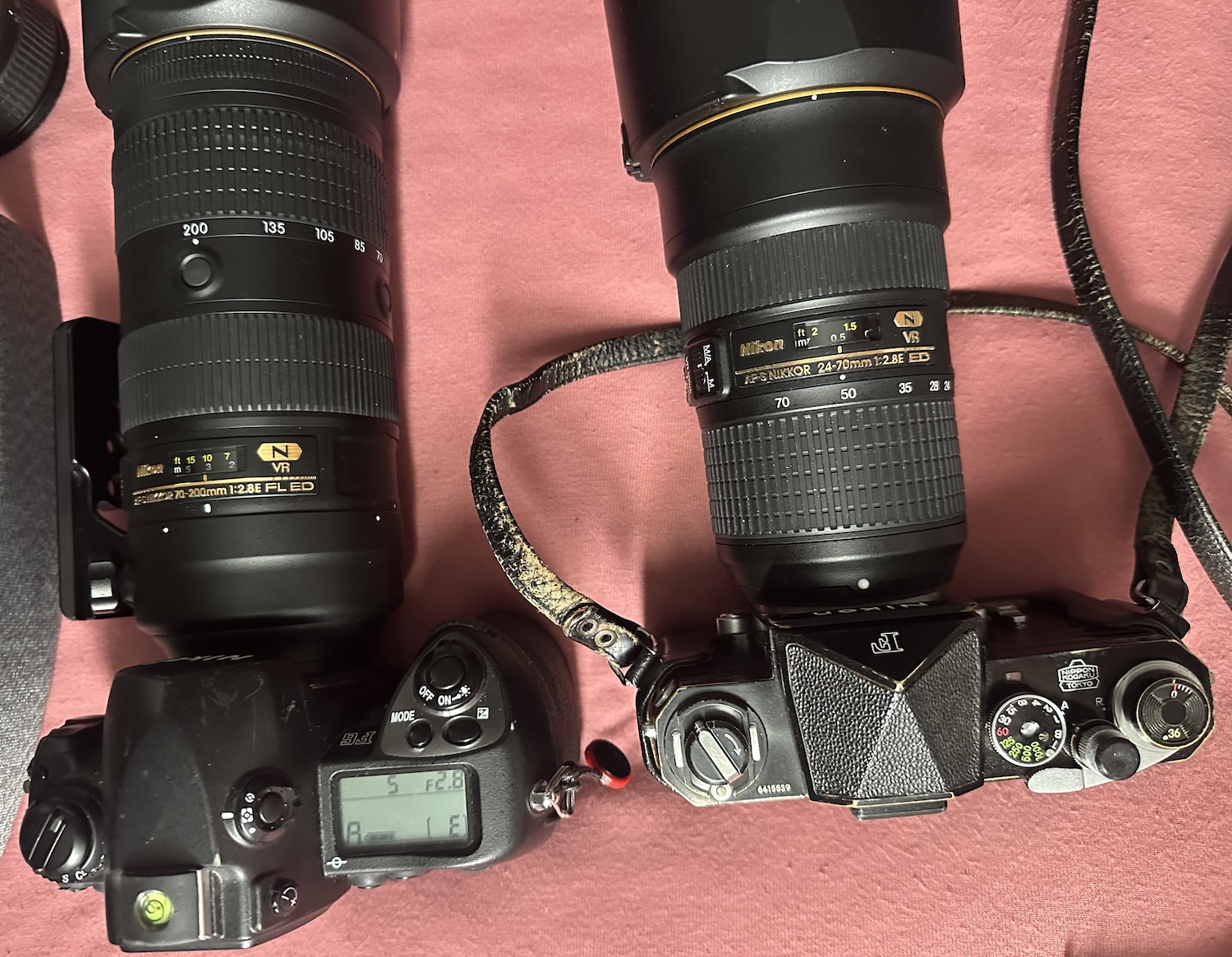

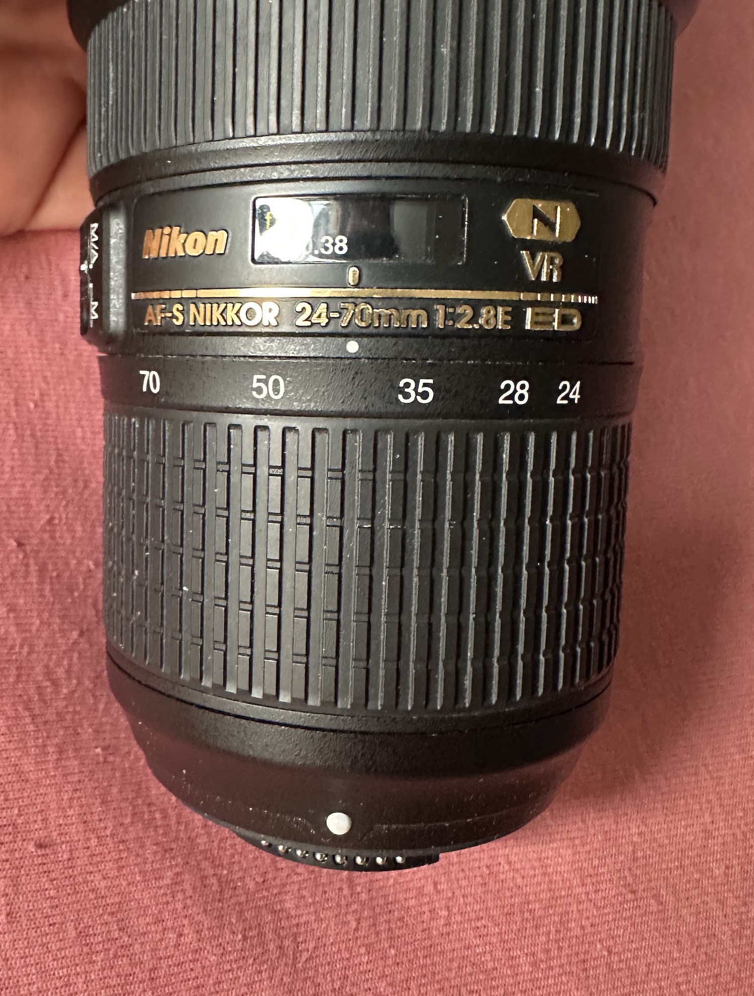

Type E lenses have no mechanical aperture coupling. The only camera that can control them are DSLRs(and mirrorless) introduced after ~2008. Interestingly enough, though, I can put my 24-70 f/2.8E or 70-200 f/2.8E FL on one of my F4s and the camera will still give correct exposure-it knows that f/2.8 is the only available aperture. The F5 and F6 will show f/2.8 as the aperture in any mode and not let you change it.
It’s actually a shame the F6 never got a firmware update to control these lenses. Most of Nikons newer high end F mount lenses use this type of aperture, and among other things I love that it’s free of the exposure inconsistency sometimes seen in G lenses, especially in high speed shooting. In fact I never paid much attention, but a lot of times in say a family portrait session(which is almost always on digital for me…just the reality) I’m often using the 24-70 and 70-200 pair on two separate bodies, with the 24-70 doing the heavy lifting a lot of times. I’d often notice random missed exposures in a sequence, but would never be able to tie it to a specific lens or body. It was especially frustrating when I’d have 20 photos of the same group, and the bad exposure would be on the one where everyone was looking at the camera and smiling…and that’s often where it would be most apparent because I’ll usually shoot groups at moderate apertures.
This problem went away for me if I was using a D lens and setting aperture on the aperture ring. It also went away when I upgraded the 24-70G to the E version. I lost it completely when I got the 70-200 FL last summer, which is just a magic lens in general(if only Nikon hadn’t felt the need to mess with the zoom and focus rings). That lens still gets some “best in class” recognition, and even compares favorably to the newer Z mount version. I just got a roll of Velvia back where I shot a few frames with it, and the lens is just as amazing on film as digital.

Tell my transparencies shot with my 70-200 f/2.8E that the lenses have "no use" in film photography.

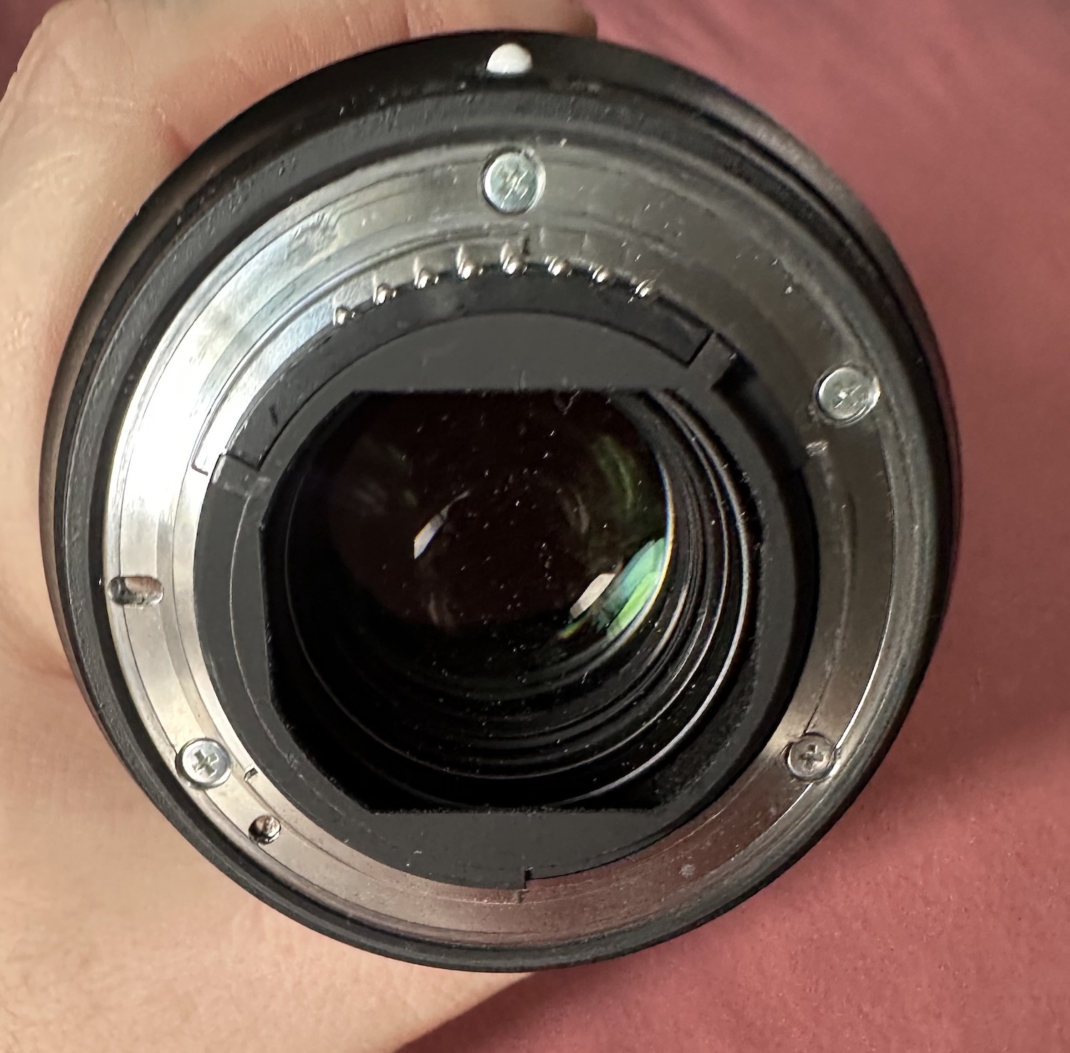

And no, these type E lenses do not have any mechanical coupling to the camera body, aperture or otherwise.

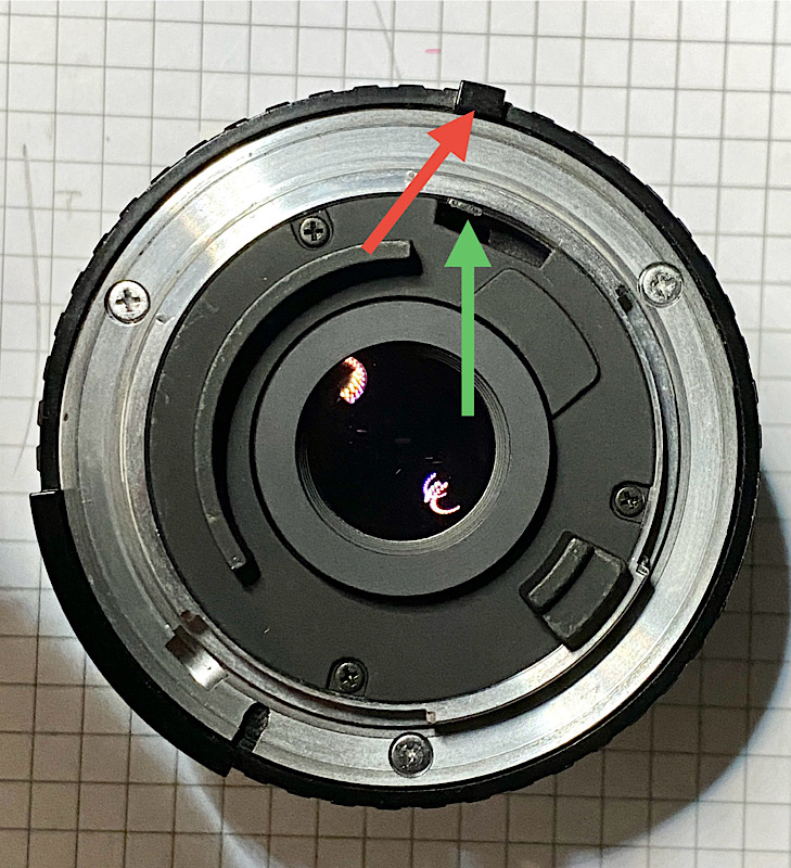

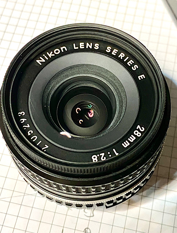

Example for a Series E lens:
Mechanical aperture coupling elements on the Ai-S bayonet:
  • AI coupling for transmitting the set aperture to the aperture simulator camera (red)
  • aperture lever that couples with the open aperture lever in the mirror box (green)

As an analog photographer here in the analog forum, I understand „E“ to mean „Series E“ in the Nikon world.
I've provided an example for Series E here.
If Series E lenses are 100% Ai-S compatible, how can they function without a mechanical aperture clutch?
How does a Series E lens then work on a Nikon FA, which is what it was made for, and how does it transfer the set aperture?
Type E lenses are not Series E lenses. In fact the correct term is E Type lenses. Ben was talking about the E type lenses which have electromagnetic diaphragm. These were introduced in 2007. No film camera can control the diaphragm on these lenses and the lens to body interface is 100% electronic. No mechanical coupling of any kind.
How does a Series E lens work on a Nikon FA, which is what it was made for, and how does it transfer the set aperture?

"Series E" lenses were, as you show, the budget lenses originally designed for the Nikon EM, but fully compatible with all Nikon bodies capable of coupling to AI-S lenses. They made liberal use of plastic(compared to contemporary Nikkor-branded lenses-they have a lot of metal compared to many modern lenses!), used simple optical designs, and omitted the coupling shoe for earlier non-AI meters.
