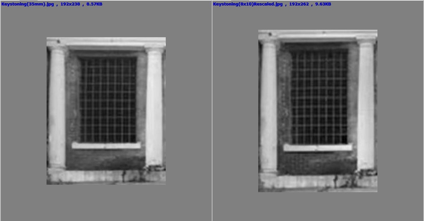

Please take a second look at the "8x10" and "35mm(corrected)" images side by side. The 35mm image has parallel verticals, sure. But is is vertically compressed compared with the "8x10".
To confirm this, I cropped identical (as best I could) portions of each image, scaled (same factor in both directions, of course) the 8x10 image so that its width matches the 35mm, and put them side by side.
35mm left; 8x10 right
The vertical compression of the "corrected" 35mm image confirms my suspicion that the perspective correction in PS (or whatever you used) merely stretches horizontally the top of the image to make verticals parallel.
This ignores the vertical foreshortening. Imagine you take a picture of a tall business building, the center of the pictures being, say, on the 6th floor. With a view camera, full perspective control, lensboard and film vertical, all windows of the building will have the same size on film. With a 35mm camera just looking up, the 9th floor windows will be vertically foreshortened relative to those of the ground floor. And that is not corrected by stretching apart the verticals.
This shortcoming has mild consequences in the video, because the aiming tilt is not very pronounced. But one should be aware of the difference between a true perspective correction and just making the verticals parallel.
To end on a constructive note. How to do a proper correction in post? I use a panorama software, PTGUI (shareware) of Hugin (freeware). Panorama?? Yes, with just a single image. And use the "align" tool to re-define the location of the horizon.
And, to end on a positive note, despite my nitpicking. thank you for your informative and stimulating videos!
...The vertical compression of the "corrected" 35mm image confirms my suspicion that the perspective correction in PS (or whatever you used) merely stretches horizontally the top of the image to make verticals parallel.

@Andrew O'Neil

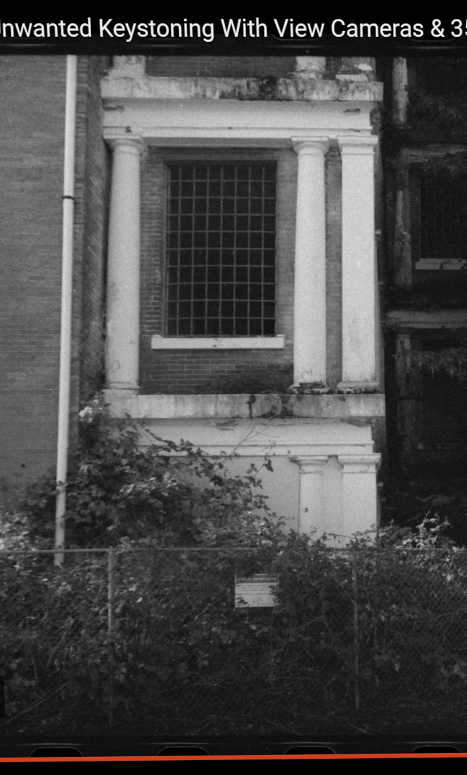

I tried correcting the 35mm original with Lightroom using only Transform auto, aspect and rotate and got this. Is this better, the same,?

Kudos for performing an actual experiment. As you realized with a P&S the true distortion of the lens interferes with the "distortions" of projection.
There is more to perspective correction than fixing the convergence of verticals plus a scale factor. Details aside , you can understand that the vertical scale correction varies for individual squares (or windows) depending on distance and slant angle (foreshortening).
Hard to tell because:
  • In the example shown by Andrew in his video the perspective effects are moderate.
  • Once the average value for the vertical scale factor has been applied, only second order effects remain.
  • Images grabbed from the video are not very sharp.
My point was not that the proposed 35mm correction was terribly bad but to raise a flag about the correct method. The difference will be significant in situations like 24mm (equiv) FL staring up at a building at 45degrees.

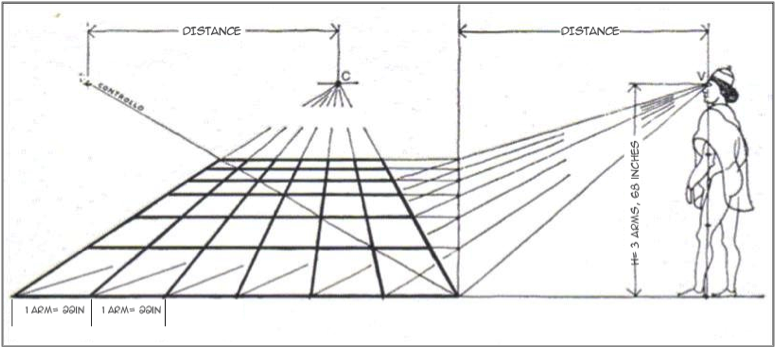

Brunelleschi and Alberti had it figured out by the middle of the quattrocento. No Internet, no Photoshop.
quoted from: https://www.silviaminguzzi.com/anotherperspective/linear.htm
