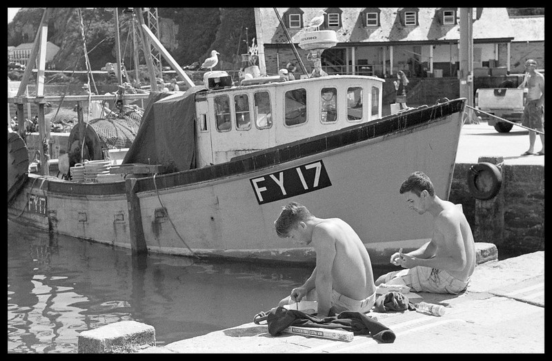

Good luck with your testing. Dont forget that you have a 3rd variable in addition to time and dilution. By changing your agitation routine, you can affect the contrast in the image. More dilution and less agitation will give better shadow development and still retain highlights, in effect, pushing the shadows.
This example is HP5+ exposed at ei200 shot in contrasty summer sun, and developed for 12 mins @20c in HC-110 dilution H 1:63 with 15 seconds initial agitation and then only 2 gentle invertions at 4 minutes and 2 invertions again at 8 minutes.
Lunchtime at Mevagissey. by [url=https://www.flickr.com/photos/25714267@N06/
Thanks for the tip, and nice shot! I am amazed by the dynamic range and tones which can be achieved with film (when used properly:smile:. The way you developed it seems to be somewhere in between a "standard" development and a stand development. So far I have done "standard" development only but I have, at some point, to give it a try. Cheers! Franck.
