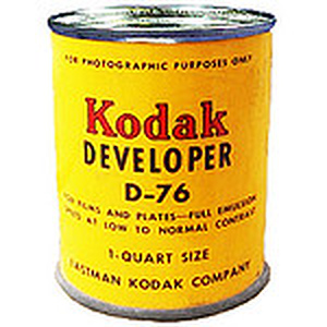

The best marketing move Kodak could (and should) make, would be to offer their powder chemistry in tin cans, or even in glass bottles. Ok, would be 1$ more expensive, but well worth it on so many levels, including the customer experience.
Enough with the plastic bags crap. Do they sell sardines and tuna in plastic bags? They could, but people wouldn’t buy that crap, even if freshness was guaranteed to last. There is a point where the customer starts getting insulted.
These new bullshit-oversized-one-bag-fits-all-our-oxydized-chemistry is fankly starting to tick me the wrong way.
Bring back the good old cans, bring back the good old folklore into the people’s darkrooms. Make people happy.

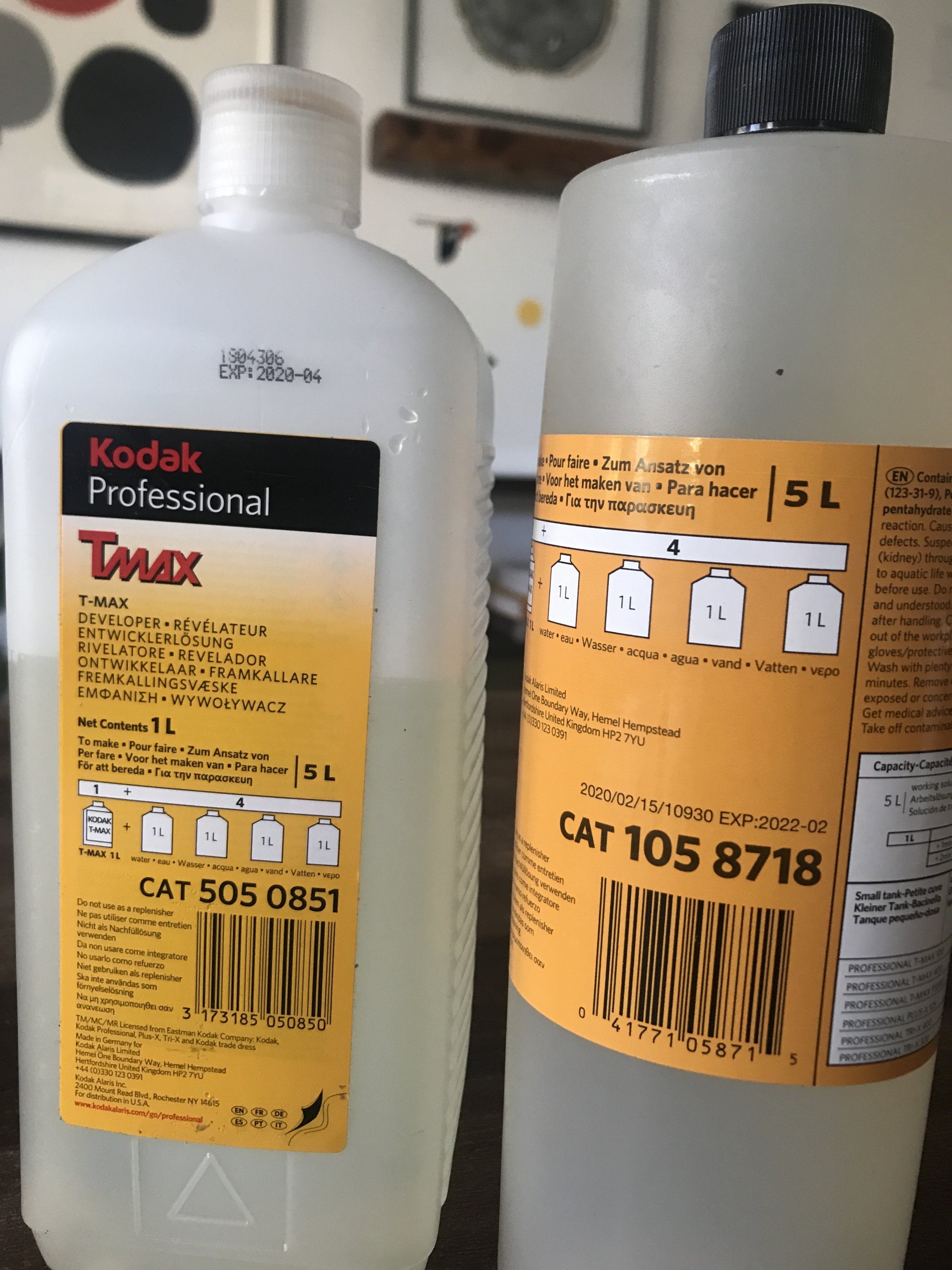

Speaking of expiry dates, my old bottle of Tmax developer has the expiry date printed on the bottle. The new packaging for Tmax developer has no expiration date. Don't know why.
The expiry date on powder packages most likely reflects the durability of the packaging, taking into account what happens to packages in the light and heat on a store shelf.
I have had very old plastic packages get brittle.
As I understand it, "Use before" dates are also part of ISO certification.
And as for the T-Max developer bottles, I bet there is a hard to read date there somewhere :smile:
No, not really. That is a bad idea gone very very wrong. Do you really think that the people that do the R&D and production of photochemicals are really so stupid that they did NOT look into that and other ways of packaging? It is really easy to hide behind a computer and Monday morning quarterback. Work as an engineer or chemist for a decade and then you will understand what is wrong with your complaining.
Oh please. You are the monday morning quaterback, as far as I’m concerned. I am telling you what I, as a consumer, would want. And what WAS DONE during the golden years, before they all sold their mothers and started cost-cutting everything.
I, the consumer, want my dry chemicals to be offered in two forms.
1: In tin cans. I would LOVE this.
2: Powder in 1 Liter brown bottles, with a 1” opening and with an embossed Kodak Logo, and a big yellow cap. These bottles would get reused and would prove to be a very effective long term marketing move.
I’m fed up withe the cost-cutting ungraceful plastics of all kinds. Give me a tin can or a brown bottle. I will pay the 1.12$ extra.
I just checked and you're right Matt. On the old packaging they inkjet printed the expiry directly on the bottle (left), while the new packaging has the expiration pre-printed as part of the label. I imagine deleting the production line printer is a cost savings for them.
