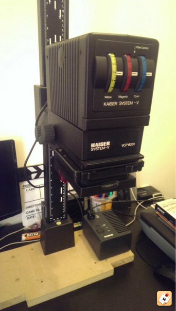

Here she is :smile:
I'm running with both hands...
My enlarger is pretty much the same. It works a treat with Ilford and other VC papers!

I used a Kaiser VCP6000 with dichroic colour head for many years for black and white VC printing. It's almost the same as yours. I found it to be an excellent enlarger for this job. I found I never needed additional filters, but if you do, you have an above-lens filter drawer. You can get a copy stand attachment for it if you ever want to do any copy work or film 'scanning' with your DSLR. I have this attachment and use it in copy stand mode at the moment, but if I ever get my darkroom set up again, it will probably do service as an enlarger once more. Happy printing!
