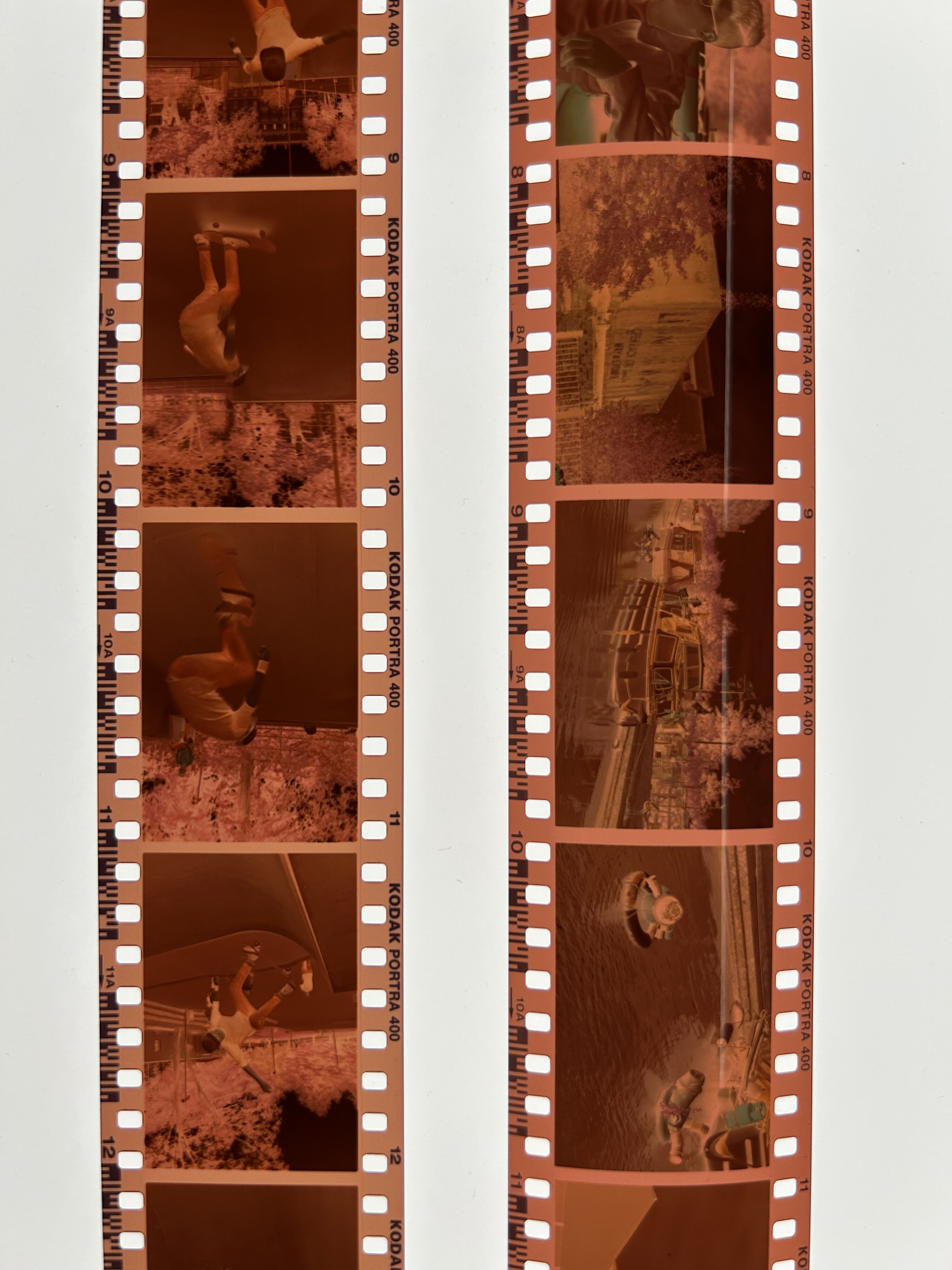

Looking at the negatives themselves it is quite hard to tell the difference with the naked eye, here the left strip is lab-developed and the right one is home-developed and to me it appears as if the base of the right strip is slightly blue or purple than the left one:

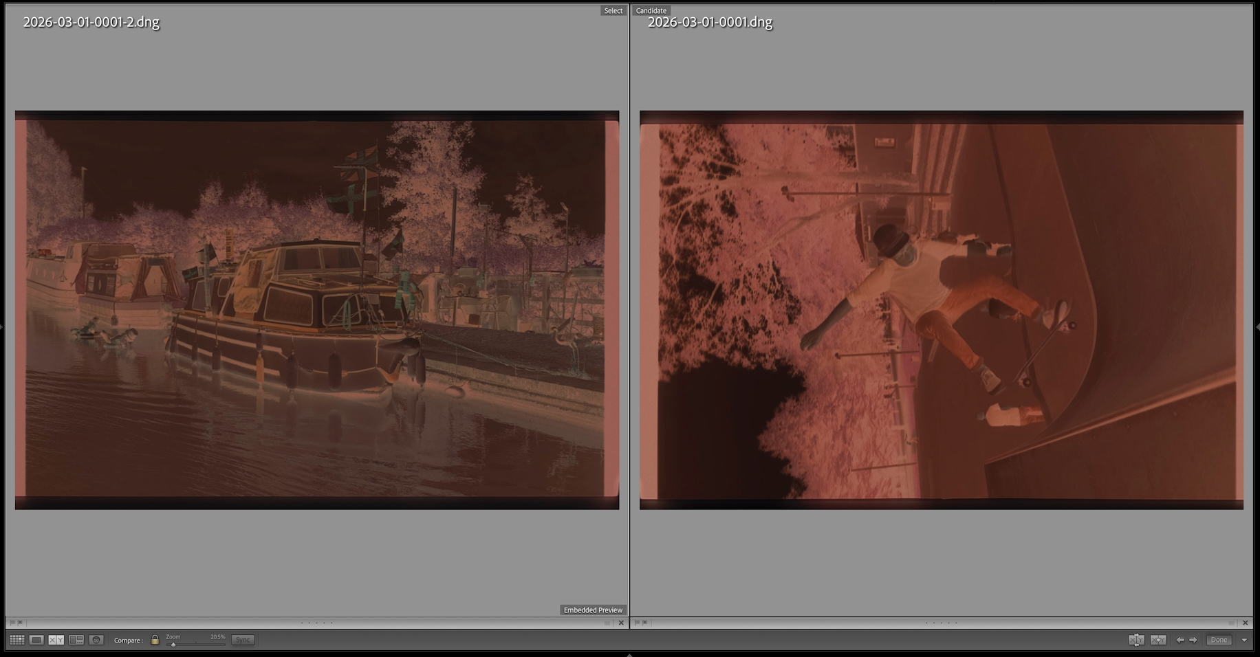

Bringing them into the computer the difference is more notable (forgive the slight trespassing into hybird territory here), this time the lab-developed negative on the right and the home-developed negative on the left. To me it looks like the home-developed negative has a blue cast to the base, and it becomes very apparent in the colour of the trees.
I think in the end, when inverted, this has the effect of adding a red or magenta cast to the resutling positive, which is quite troublesome to colour correct. I would imagine that this might be an even larger problem if I were to do RA4 prints of these.

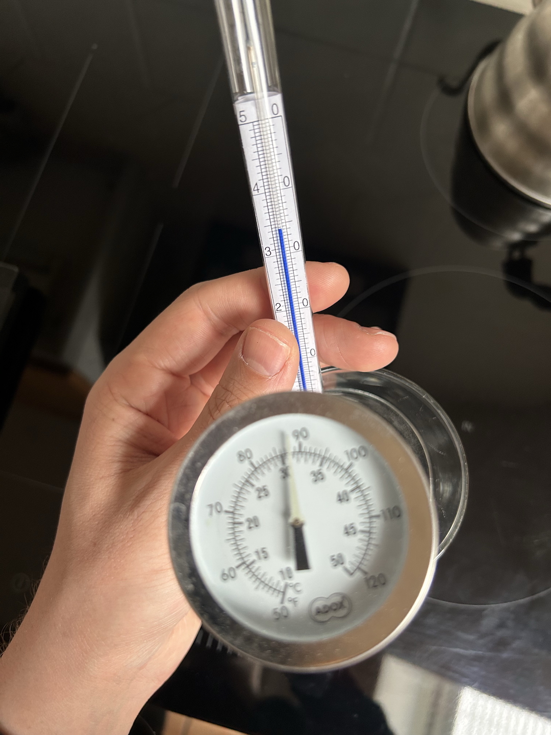

Tentatively I think I may be closer to solving this mystery. I ordered a new Jobo colour thermometer a while back which arrived today, and comparing it to the Adox dial thermometer I was using the Adox thermometer shows several degrees lower:
I will have to try developing some test rolls to confirm, but unless the Jobo thermometer is terribly wrong in the opposite direction this seems like a likely culprit

Those dial type thermometers should have a calibration screw somewhere. If not calibrated, they can deviate quote badly from the correct temperature.
Yes, that's true. This ADOX thermometer has a calibration screw. All these thermometers sold in Poland have instructions in their manuals that they should be calibrated before first use. However, I didn't find this recommendation in online stores in other countries. I was convinced that our Polish distributor was selling a defective product, as in other countries they sell pre-calibrated thermometers.

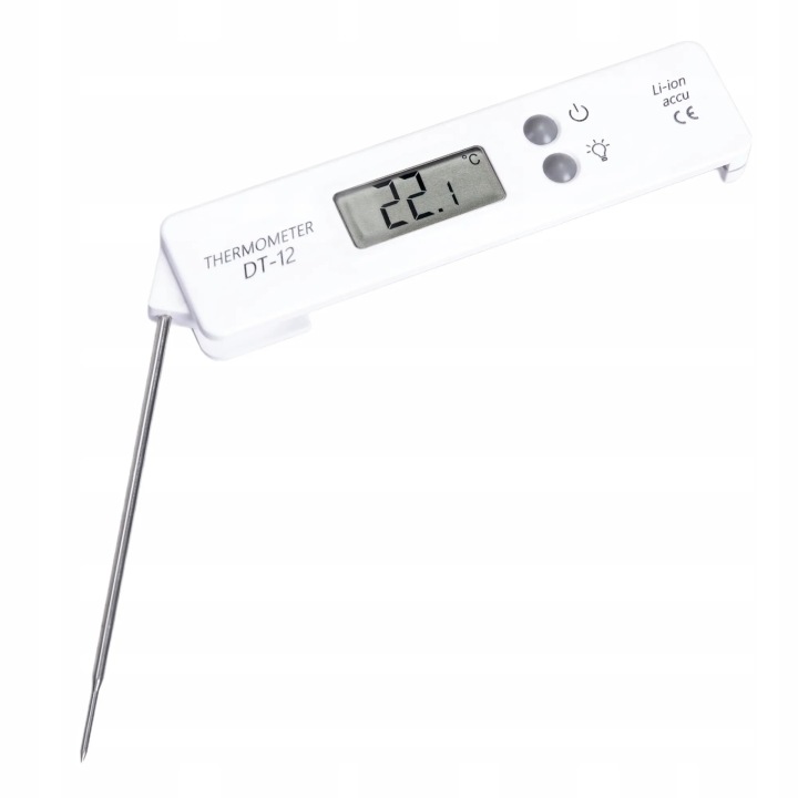

I solved the problem of the ADOX thermometer's temperature accuracy by purchasing a professional digital thermometer from the Polish company Termoprodukt. It's the DT-11 or DT-12 model and costs around 50 EUR in Poland. It's very fast and accurate. Accuracy: 0°C-100°C: -/+0.1°C
My workflow (Process C-41):
I place photographic chemicals in glass bottles in a 12 liter sous vide container. I fill the container with warm water (around 40 °C). The water temperature drops because the bottles (and chemicals) are at room temperature.
I turn on the sous vide machine and set the temperature to 40°C.
I keep an ADOX thermometer in the heated water all the time, constantly monitoring the water temperature.
Water heated by the sous vide device reaches the set temperature quite quickly, but it takes some time for the chemicals in the glass bottles to reach the recommended temperature.
I focus on the developer temperature, as it's crucial. I unscrew the cap of the developer bottle and begin checking the developer temperature with a DT-12 digital thermometer.
I account for the temperature drop during the 3 minutes and 15 seconds of developing in the tank, so I allow the developer to reach a temperature of around 39.5 °C.
Then I turn off the Sous Vide machine and start the developing process.
During this time, the water in the sous vide cooking container maintains a temperature of about 39 °C for a long time, so during the developing process I place the tank in this container so that the temperature of the developing chemicals does not drop significantly.

It does have a calibration screw as it turns out. I will test the process with this new Jobo thermometer and in case it works well I'll use that to calibrate the Adox thermometer.
