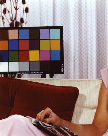

I would have to say that Tungsten alone, even with the right filter, is not a good idea!
As for the test chart, of course you don't take pictures of charts, you take pictures of landscapes, people or other items of interest and INCLUDE the chart for a reference.
See below:
Left photo, good test but bad picture to illustrate proper technique. Direct scan of Portra VC 6x7 from Mamiya
Right photo, typical portrait to illustrate correct method. Scan of Endura print of internegative on Portra VC 4x5 pulled, from EPP 4x5 original.
PE

Fine. I'll do it outside.
In the past I have thrown objects of different colors into the scene.

This is a brown covered spiral bound book, about 5x7 inches in size that Kodak updated in about 2002. They make a B&W and a color version, but the color version is the only one with the test chart.
Older versions of this book contain a control negative as well. This is similar to the photo I posted above with a model next to a color chart.
