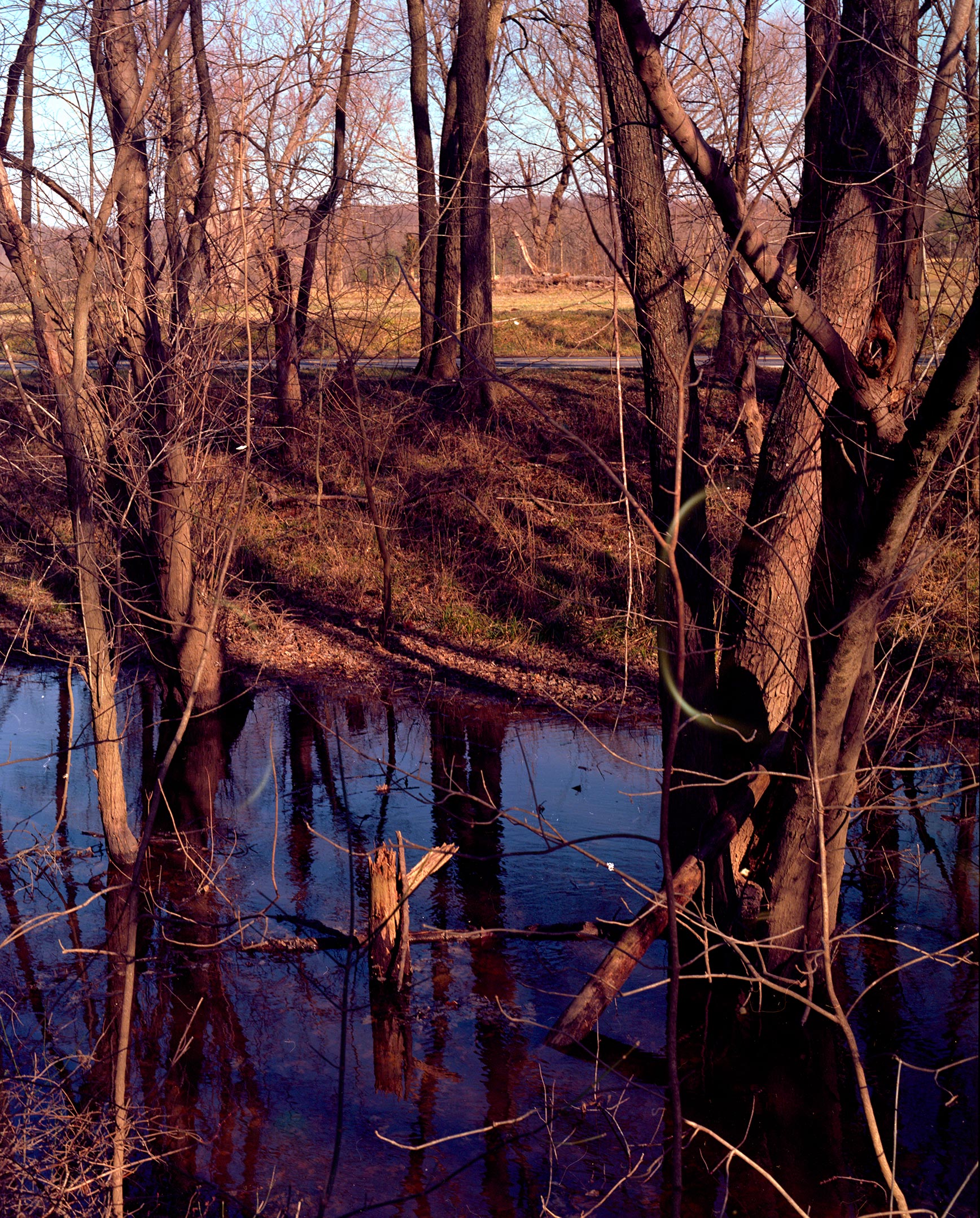

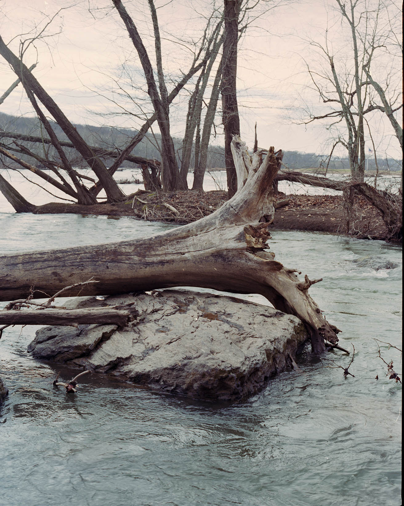

I home processed my first roll of color film this weekend, and scanned it using Negafix. I see there's a huge difference between images that are saved using the Negafix color profile in Silverfast vs images that are saved as raw DNG's, and inverted in Photoshop. The Negafix image is much better. If I had to pick out one thing, I'd say that using inversion doesn't seem to take into account the base tint of the film. How does one get the correct color curves for a specific film in Photoshop?
The Photoshop inversion seems to be just that, inverting whatever the raw scan was (hitting Ctrl - I) and is definitely not a proper method getting a photo from a colour negative.
That's right. FWIW, Ctrl-I is the same thing as selecting "Color Negative" under Curves. It's just a raw inversion.
With Silverfast, it seems that there isn't any way to apply any processing when saving as a DNG. That's fine, as I think I'd rather my DNG to be as straight off the scanner with as little processing as possible. Still, I'd like to actually get a proper image through Photoshop somehow.

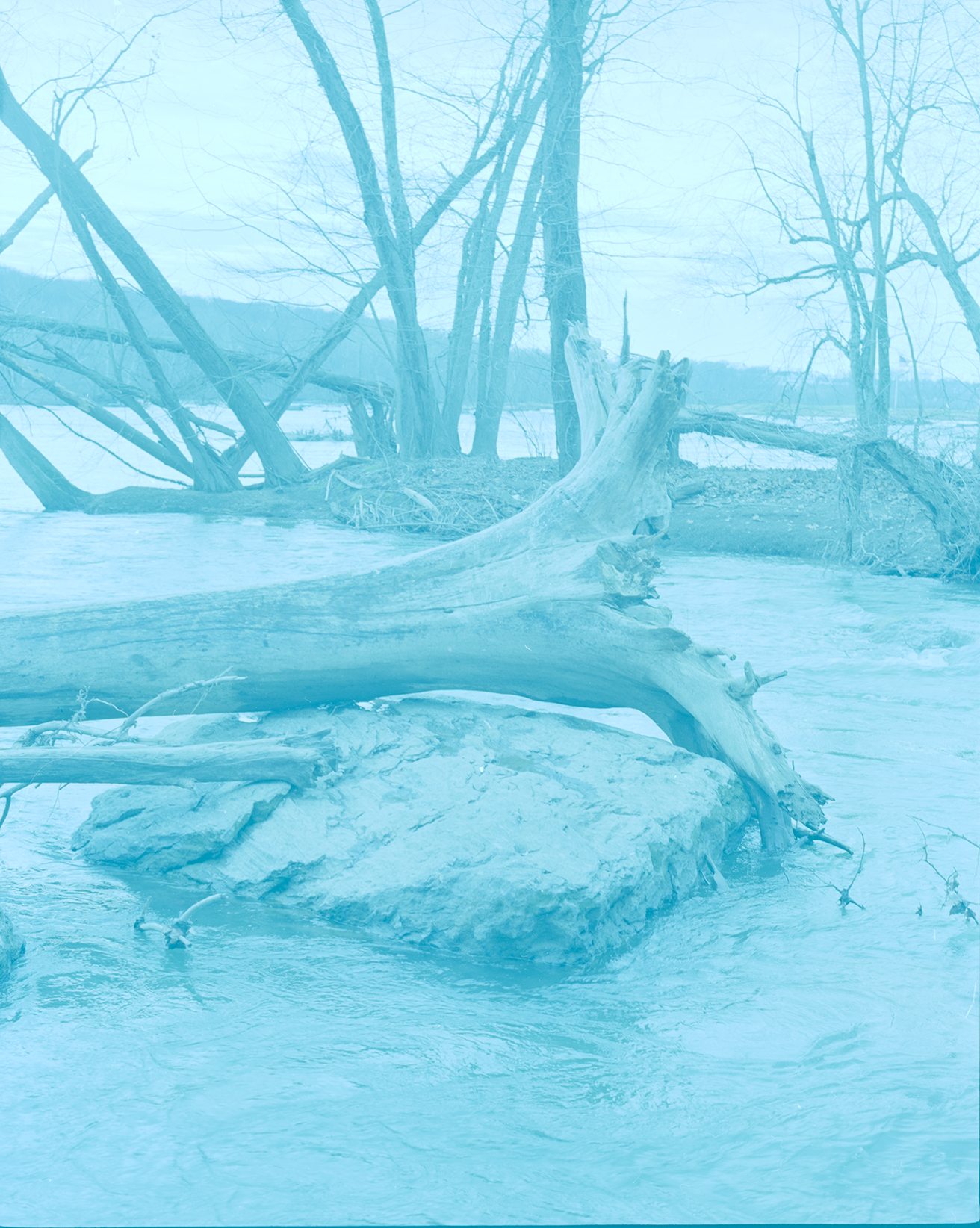

I found this explanation, it works well for me:
The key step is pretty simple to do in Photoshop: sample the colour of the un-inverted negative rebate, make a new layer, fill the layer with the sampled colour, set blend mode to divide, flatten the layers, invert the image, clip RGB black & white points using warnings. Then fine colour adjustments & tonal balancing. The divide blending mode is essential - the mask is not a global colour - it's a mask that's formed inversely proportional to exposure & must be removed as such. If you do so, you're well on your way to manually matching how an optical print responds.
It takes considerably more time to describe than do! Main area of trouble people tend to have is judging how far to clip the individual black/ white points in each of the RGB channels in curves. Best solution I've found is to clip the black point till the rebate has a good black, and the white until just before it starts to clip in the image area. Other important thing is that black points must be set first. Far too often, the preset driven programmes are excessively aggressive with bp/ wp settings when compared to manual controls. In comparison, the Fuji Frontier (for example) tends to clip 'white' to outright white, then adjust the output back to an L of 95 amongst a whole series of other oddities that rather stifle the range of many films. It makes sense in the context of that sort of minilab, but if you want something more akin to what an optical print might deliver, I've found manual clipping to be significantly better.

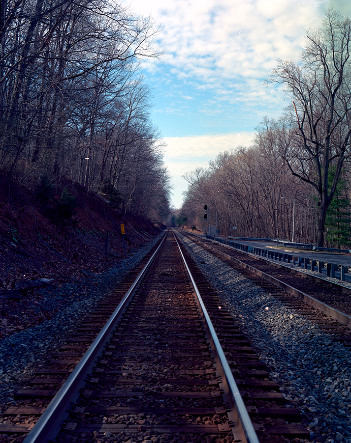

OK, interesting. Looks like there are crazy numbers of ways to skin this cat, starting with a simple divide by orange/invert/find light & dark colors. Negafix looks fine, although I really didn't want to apply color adjustement at the scanning stage.

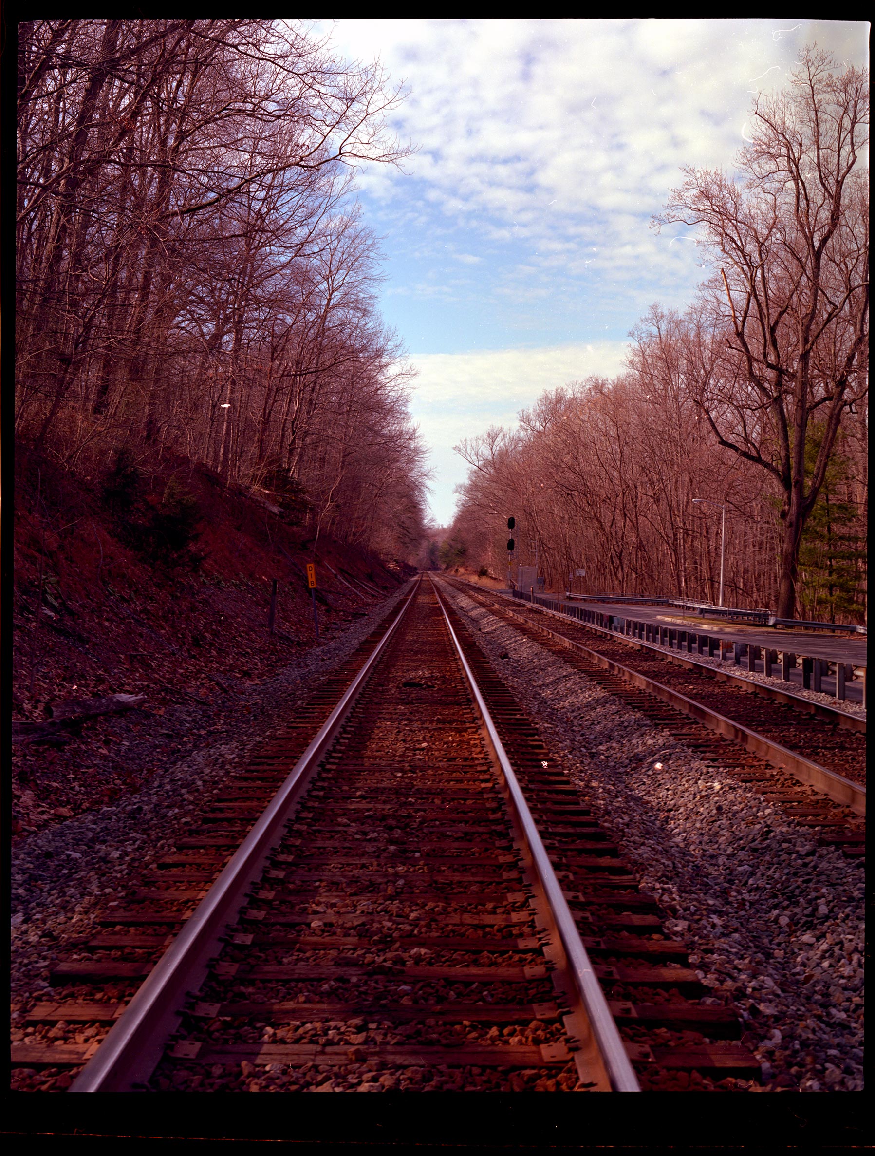

However, it does look like ColorPerfect isn't removing the orange base tint. Is there some button or trick to that? Also, kind of strange - if I remove the base tint before I apply ColorPerfect, the result is the exact same. If I use Negafix directly, these pictures aren't so orange.
That is normal. I think the algorithms it uses know when the orange mask has been pre-neutralised or not. As to the orange cast in the above images, hard to know without seeing the file directly.

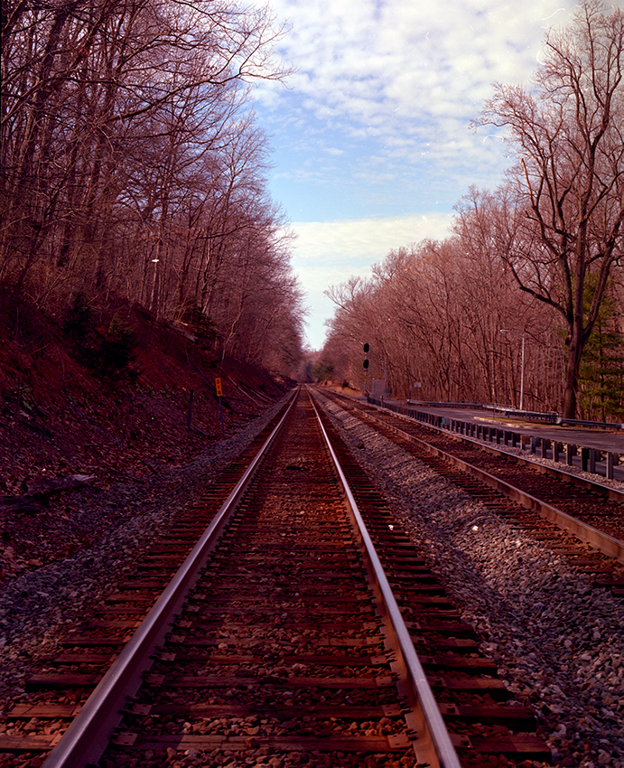

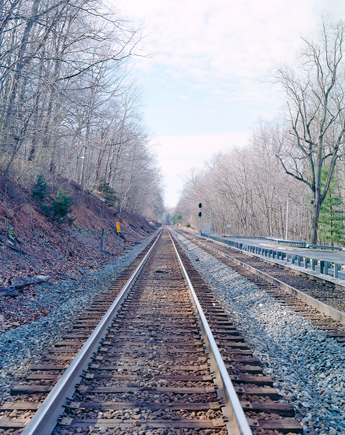

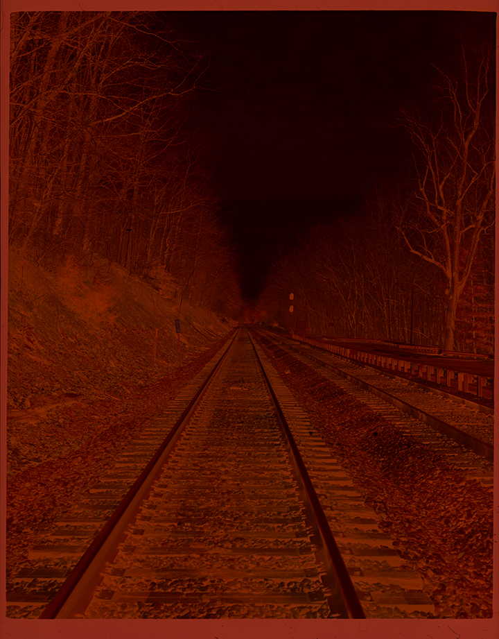

Here's an example. I've attached the scan, one that was done with a simple divide and find dark/light colors, and one using Colorperfect. The Colorperfect is using the Kodak Ektar profile.
Ah, OK, I think I've got it now. The button that says 'L' means linear. And if you click it, it switches to 'G', which means gamma. I thought this was a linear scan, but apparently it was gamma.

This isn't true in my experience. ColorPerfect gives me way more accurate and easy inversions than manual inversion ever did in Photoshop, and believe me I tried all the common techniques, including curves manipulations. It's a recipe for frustration and endless tweaking. Ektar in particular is extremely difficult to manually invert properly. ColorPerfect gives excellent results every time with very minimal effort.
And here's the Colorperfect image with the corrected color space, but otherwise untouched. And of course it still needs further tweaking. I'm not really sure how I'd do that in CP at this point, but I'm not worried about it. My main goal at this point is just to not be making basic mistakes.
