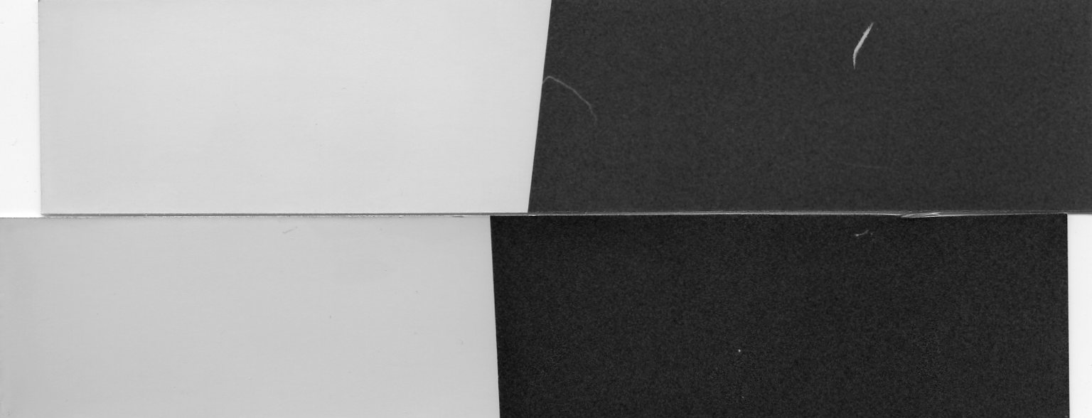

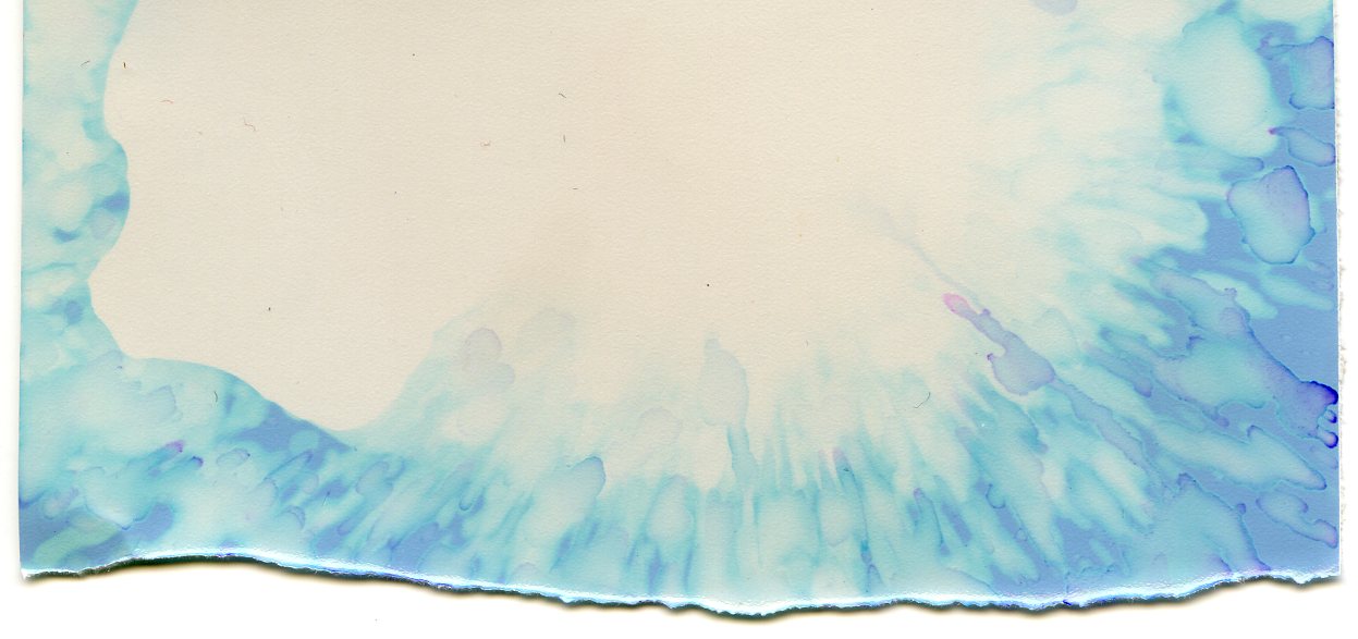

I think here we go circles. Her I'll try one time, trying to get it clear.
This is Fuji CA Super C color paper. Below is a piece of new paper.
I cut the same piece of the paper and put it under sink faucet. No chemical at all:
You can see clearly that the blue/cyan coating was washed away. This paper never sees chemicals.
I cut the same paper into strips and printed 1/2 of them with 18% grey negative. Below are two of them I printed:
The scanner did not do a very good job here. 1/2 of the strips were exposed and the 1/2 were not exposed. After processing, the 1/2 un-exposed strips should be white. The top strip is old and the white paper is white. But the newer (lower, 2nd) strip shows a light blue/cyan color. You probably can't tell from the scan, but I can see clearly with the actual strips. It is the same color tone with the original new paper. This is the same top blue/cyan coating that did not get washed away.
The paper is fine. No problem with it.
Sigh. It's all a matter of semantics: washed AWAY - yes, washed OFF, no. The dye is in one (or more) gel layers on the paper and is washed OUT of the gel layer(s), leaving the gel layer(s) behind.

If the scans are reasonably accurate in density, then please note the Dmax of the top strip and compare it to the Dmax of the bottom strip. The bottom strip is considerably more dense than the top strip indicating over development may be the problem.
Fuji did introduce CA type II papers in 2006, and they claim that the new papers develop more rapidly. They have supposedly released a new RA developer for this paper. IDK if this is the case, but I do think that the development (Dmax and Dmin) are different in the two strips.
Check time and temperature, and also check the contrast of the image you get.

If you run the second strip under the faucet, does the light cyan color go away? If so, does it come back when it is dried? I think you are making a connection between the color of the unprocessed paper and the cyan cast of the test strip where there isn't any. They are coincidental and unrelated.
I have been always talking about the blue/cyan top coating, as seen in the second picture. I think it is in the top protective layer.
For the unprocessed paper, I believe the color can be completely washed out in rinse water (as seen in the 2nd picture). For the white part of the test strip, I can wash out the blue/cyan color with rinse water and the cover won't come back.
I believe this color has nothing to do with the image forming dye....

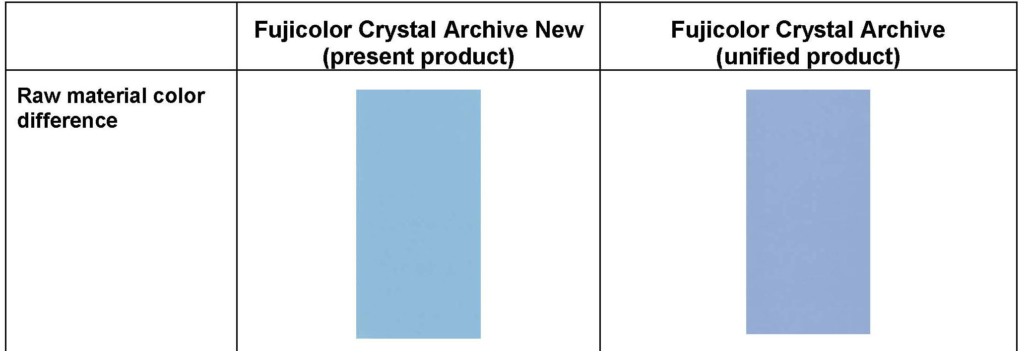

This paper color is documented in Fuji's document, as the Raw Material Color of the paper.

I've also explained the reason behind the blue color. It is there to adjust speed and to sharpen the image. It washes out. Nothing washes off! The blue color of processed paper that Red Sun is seeing is not related to the blue dye in the paper that washes out! It is probably fog of some sort.
If you fully process a sheet of unexposed paper, and just blix a sheet of unexposed paper, then if they differ in blue color (or cyan), then it is fog. If they do not differ in color, then it is indeed retained blue dye, and this indicates some sort of defect in the paper or process.
