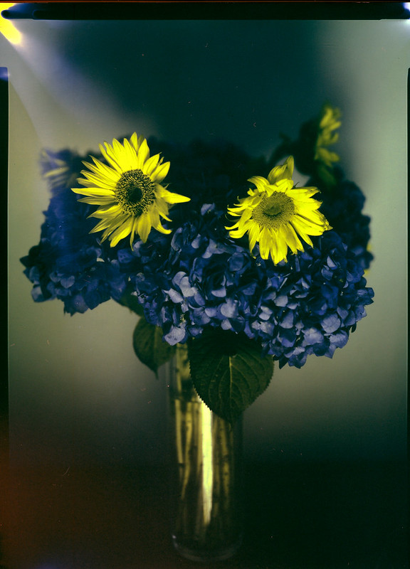

*sigh*
I accidentally developed using the expired developer the result was a very strong colour cast...
I balanced out the colour but, yikes, what was left wasn't nice!!!
Blue Hydrangea and sunflowers
Weird hand coloured look to the image - don't you think?

*sigh*
I dunno, I kind of like it. It depends on whether you are going for realistic color or weird unpredictable effects and I'd say if you are going for realistic color, use color film.
OTOH 8x10 color film is outrageously expensive while 8x10 paper is dirt cheap in comparison so that's a reason to try for realistic color from paper negatives.

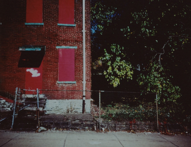

I had more trouble with contrast (too much) than I did mottling. You can see a print I made from Kodachrome in my gallery. There are a lot of variables in this process, but a lot of hard stops too. Pure white, for instance, is elusive.

I understand you use Endura. And while the mottling isn't as evident in some prints, or in comparison to Crystal Archive, I'll argue that it's still there and once seen, cannot be unseen. Heh. I don't want to be picky..... but if there is a way to prevent the mottling or an explanation for it that may help get to a solution, I'd love to hear it.
This is a 4x5 print made from a Kodachrome slide, reverse processed. (Since you don't show as a subscriber, I don't know if you can view gallery images.) While it's a bit dark, and very contrasty (black shadows) I don't think I see any mottling.
