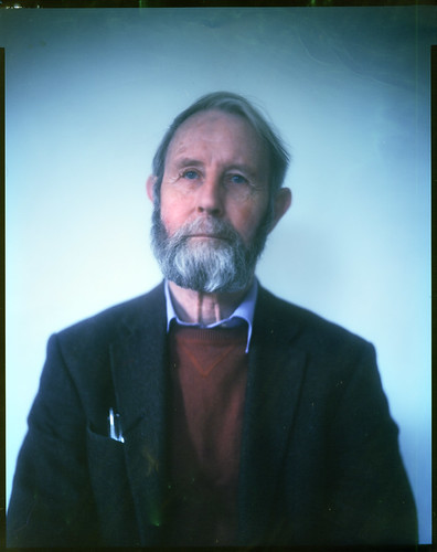

It may be critical - the portrait was taken with a studio flash and the following filters:85B-85C-25Y- 20M - could this blue to red shift be exaggerated because I did not use a UV filter?
mkillmer
Mar 18, 2011
101
UV is important with papers just as IR is. You should use both.

I never heard of IR blocking filters before, just did a search and they are easy to find. I wonder if this would help remove the hotspot I have in the centre of the images?

Color papers are tungsten balanced. As such, they have a lot of IR sensitivity to get them "out there" into the short IR range for matching the films. If you do not filter things properly, colors can be off. This can even happen with films.

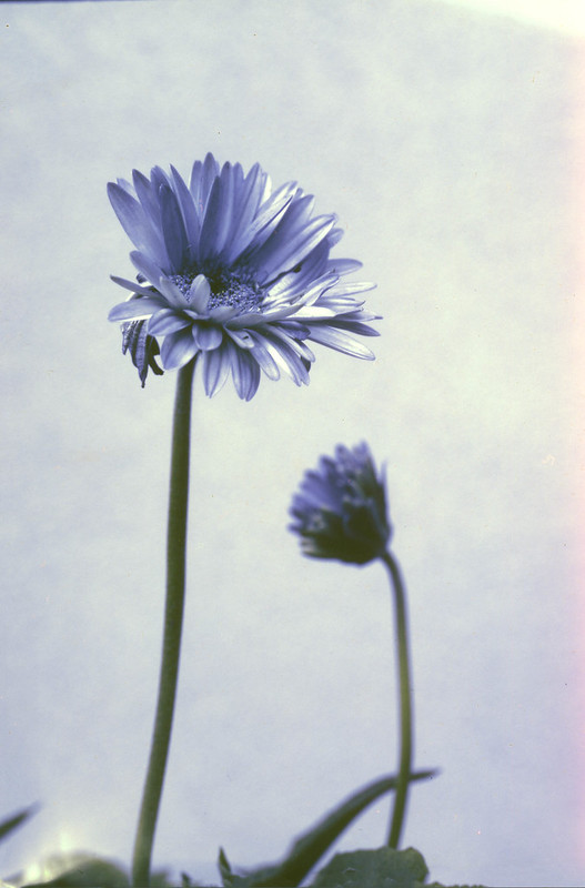

This one was the one that made me notice it first, this is the corrected scan,
This is just the red channel, looks very IR

The red sensitivity of color papers is quite far into the red compared to camera films. It is made so due to the Tungsten balance of the paper and the need to match the dye set in C41 films. This imparts some IR sensitivity.
Some automobile glasses are IR blockers. I bought a 5x5 square of it for cheap.
It worked.

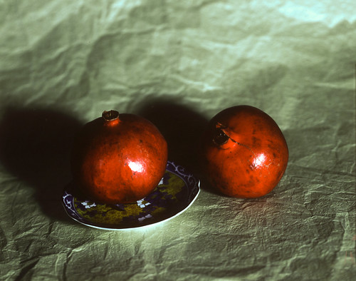

Any suggestions as to what is wrong with the weird red colours here?
If someone can tell me how to fix the colours in photoshop, I can apply the appropriate filtration...
any thoughts?
Photo Engineer
Apr 19, 2005
29,017
Rochester, NY
A Wratten 70 filter has a good level of IR blocking so R/G/B is a good and bad idea. Good for IR blocking but bad for difficulty level. If you are up to it! :D
As for the reds in the apples, I have no idea as I have no comparison. Single stimulus experiments are hard to comment on!

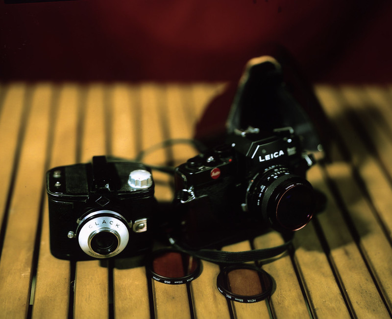

Here I've used a "Coffee" and a Yellow filter. There was too much yellow and green, but I was able to balance it out pretty easily in Lightroom.
You can see how much I need an IR cut-off filter - the background is a Matt Black ultrasuede - no red at all!
