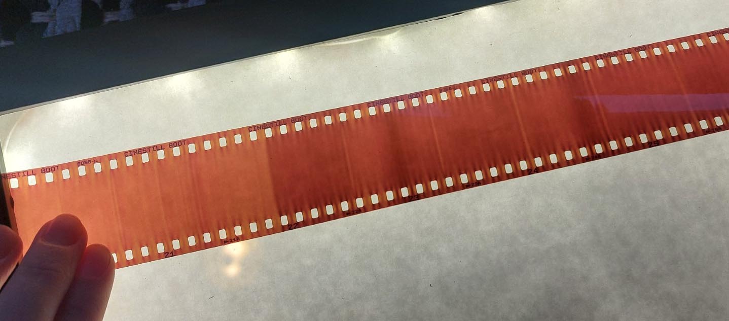

My daughter took this roll of cinestill film. I have never seen a failure quite like this. The shutter seems to be working without the film. ``
There don’t seem to be any images just the vertical lines. Any ideas?

The film was rewound backwards, causing stress marks.
Why the film is blank if the shutter is working? More info needed.
Was she using flash, and the camera was on M sync?

That's very strange. I've not seen that before. You might ask Cinestill. If the shutter was opening and aperture was wide open in daylight you should have an image. Could be due to a processing problem.

Those two dark vertical bands and what appears to be considerable fog remind me of x-ray contamination — and 800T is more than high enough to record this over a couple of passes. Have you travelled with the camera loaded recently? Light piping — bright ambient light entering the cassette felt-trap, doesn't really fit with what is visible in the pic, but more of a "could be". The other thing... shutter capping — incomplete or erratic (or no) travel of the shutter. Load another roll of film in the camera and shoot randomly; have it processed to rule out x-rays as a culprit. You then know it will be either the camera or processing.

Well spotted! The stress marks around the sprocket holes are a giveaway.

Well, the film isn't entirely blank - it has density on it alright. Although the 'frames' are of an odd dimension and seem to extend to the edge of the film, which is strange.

What kind of camera was this?
In 60+ years of owning all sorts of cameras, teaching and shooting, I never thought that one could rewind the film backwards. I would assume it would happen when the film was advanced tight so the film was only attached to the spool with the tape. In that state it would/could go either way.

I've never experienced a backward rewind either. I suppose it must be something that requires a lot of force and strain.
It does, which explains the particular pattern. It literally strains the emulsion, causing mechanical 'exposure' of the silver halides.
No, it's quite rare indeed. It's virtually impossible with modern cameras with motorized film transport, but with older cameras it's technically possible.
I think there are several problems, not just one.
- camera. We have a double density of the entire frame, including the perforation. At the same time, where the image should be, there is practically nothing meaningful.
Judging by the marking, the film should have enough density to see a clear and distinct image.
- processing. We may have some gigantic form of stress marks. Or maybe it's okay - we observe a form of light leakage. But it's probably both...
