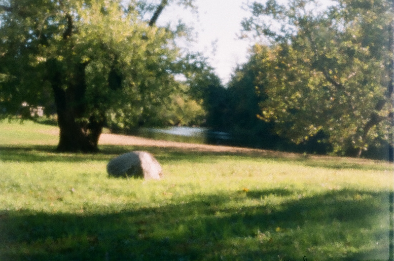

Starting out this was shot with the cheapest 35mm Fuji color film I could find locally. This is f 90 or so based on the smallest pinhole I could make at the time.
It did not take to long to realized 35 mm is too small a format for any enlargements. I switched to a 4x5 format and black and white film I could develop myself. I shoot with and f360 pinhole now. Shooting 4x5 color is expensive and I an still experimenting.

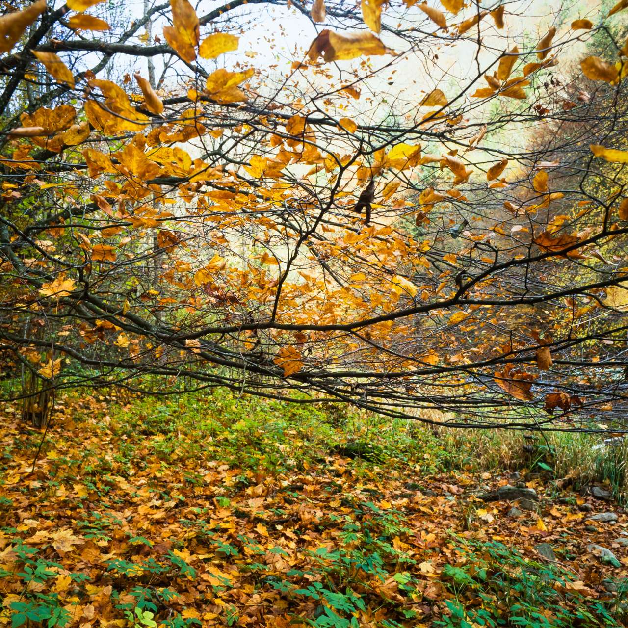

I'll show some samples taken with a lens to as contrast examples. First Provia 400X in 6x6 format taken with a Rolleicord, which I have on hand right now. You can't buy the 400x anymore, but the 100F should be similar. I think the contrast is not extreme, and they look better when viewed physically on a light pad:
And these 6x6 Velvia 50 images where taken with a Rollei SLR, the first with a Planar normal, the second a distagon wide angle. The first has a lot of contrast due to the scene:

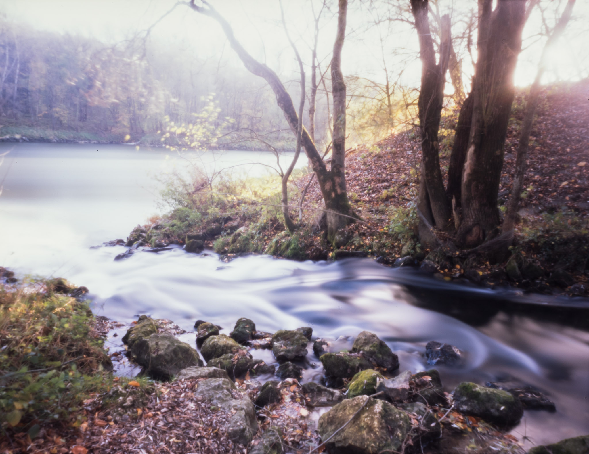

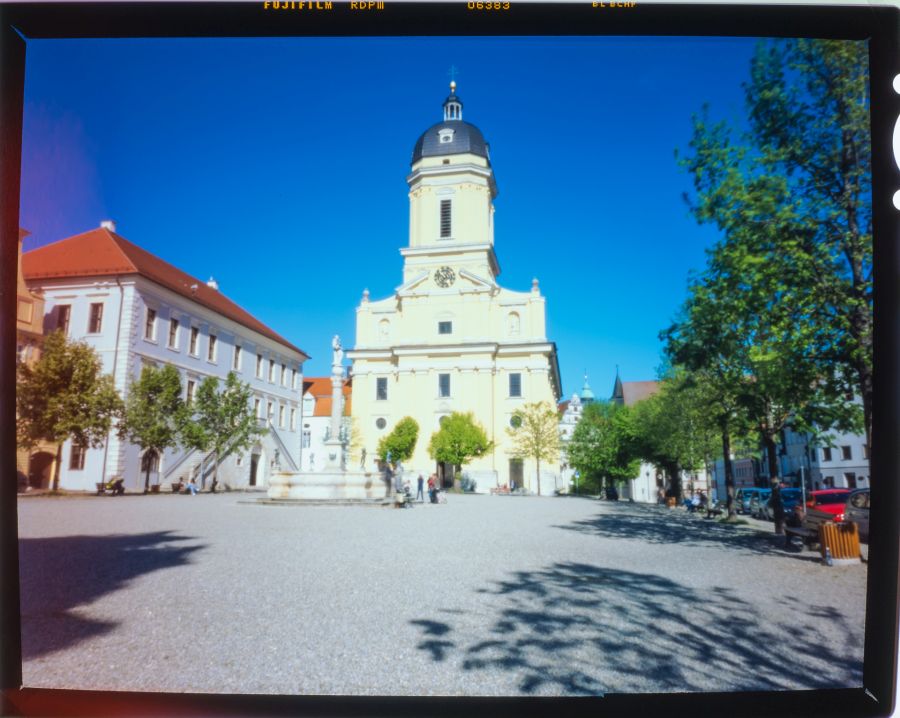

Here are the pinholes taken on a sunny day with Provia 100F (RDP-III) 4x5 sheets. The first two had short exposure around 2s, the third quite a bit longer. But I cannot remember how long.
The next one was a very long exposure (for me). I believe somewhere between one and two minutes:
