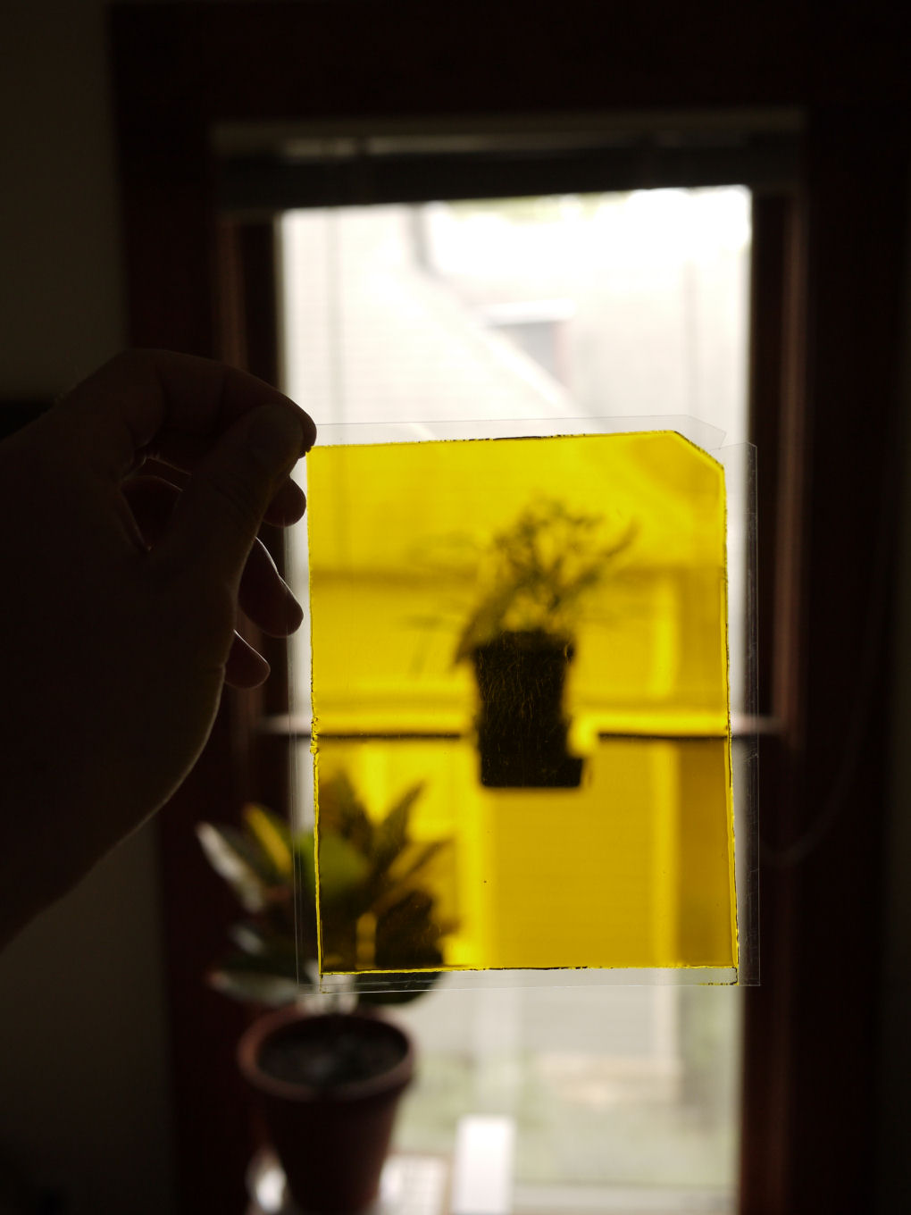

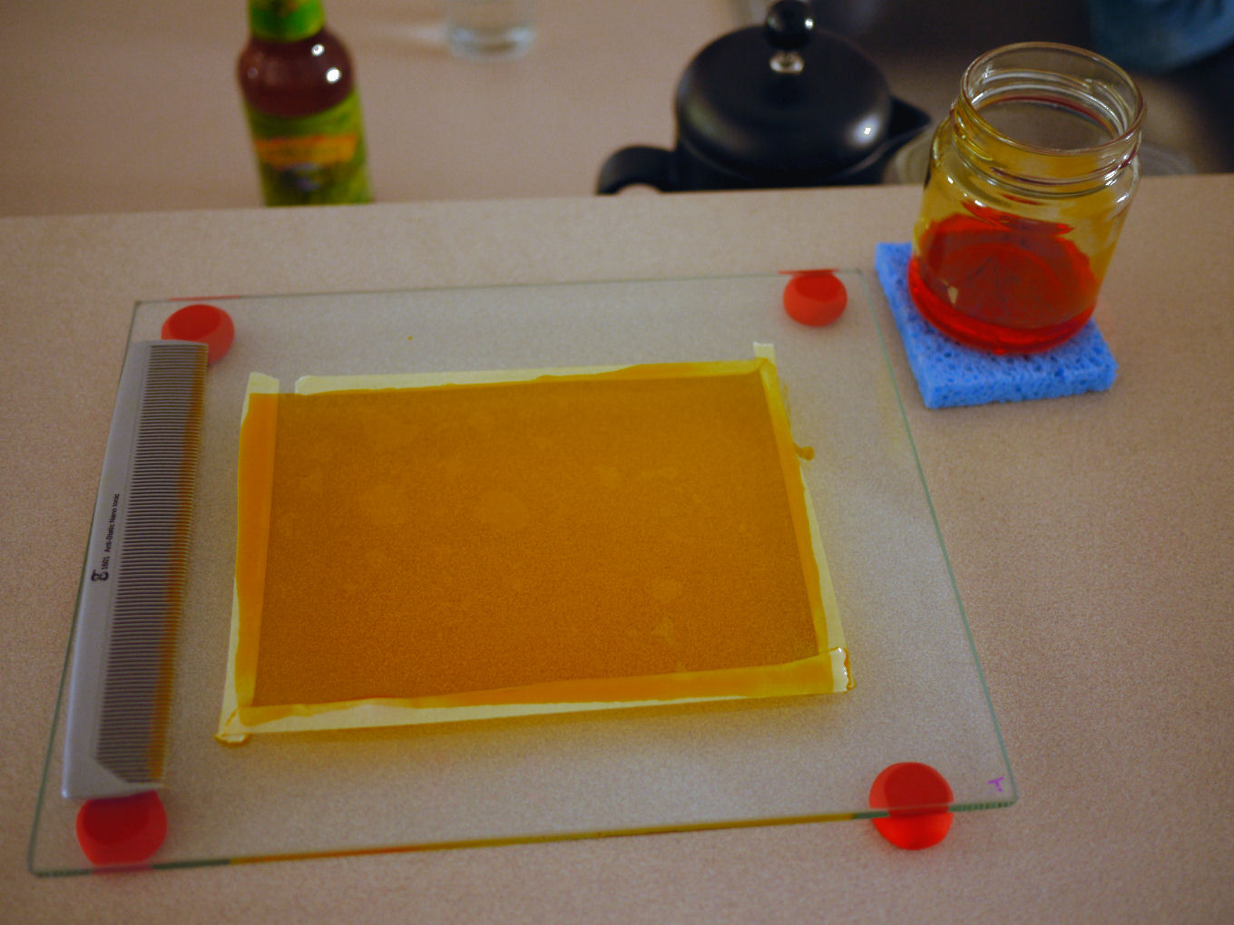

I made a coating of 6% gelatin (grocery store generic brand), 1% sorbitol and 5% McCormick's yellow food coloring (FD&C 5; a.k.a. tartrazine) as an extinction dye.
This produced a coating that is quite orange, somewhere between a yellow and orange b&w contrast filter. I suspect that it will be very good for keeping the relief shallow, and the addition of dichromate will further the stain.
I'll try to post an image soon.
After exposure, it will be etched in hot water (shooting for 115°F), cooled in room temperature water (68°F), cleared in sodium bi-sulfite and then "set" in 91% isopropyl alcohol.
All but the last step are common to the carbon process, but it is recommended by Friedman and others to dehydrate the gelatin relief, thus immediately "plastering" it down on the base. This helps in the all important drying step to limit any exudiate, which basically means no dissolved gelatin will be squeezed out while it dries, leaving gelatinous material that could cause streaks and spotting in the dye print. An alternative to the alcohol is sodium sulfate.
Gelatin Matrix with Extinction Dye
Here's a look at the still slightly wet matrix on photoformulary subbed melenex[sic]. Once dry it became significantly thinner (if you can even tell).
Tartrazine has been the standard "extinction dye" for color-blind matrix materials since the beginning, with Ives in 1914. We all likely consume some of this coal tar distillate every day in the form of yellow 5 of FD&C 5.
This coating is 5% per volume of classic McCormicks food coloring.
Hi Chris - nice coatings! It is unusual to see a 'clear' matrix film, rather than the translucent type with silver halide. Does the Tartrazine absorb UV light?
Regards - Jim Browning
Thanks Jim,
Tartrazine has an absorption maximum of 427nm and I have a scan from the Sigma dye book somewhere around here that shows its UV absorption to be decent. It's not as good as some other candidates, but I think it'll be an improvement over no dye.
Also, the fact that it's so common and that nearly everyone has some in their kitchen cupboard is a big appeal.
Thanks!
I can't say for sure to be honest. It's a 6% gelatin solution, so it's quite liquid and takes a while to set up. I think a more viscous solution would be tricky with the comb, but this kind of comb (all the same size & spacing of teeth) does quite well I've found. Like a poor man's mayer rod!
I think it's about 0.5mL per square inch when wet coating, with a little excess.
