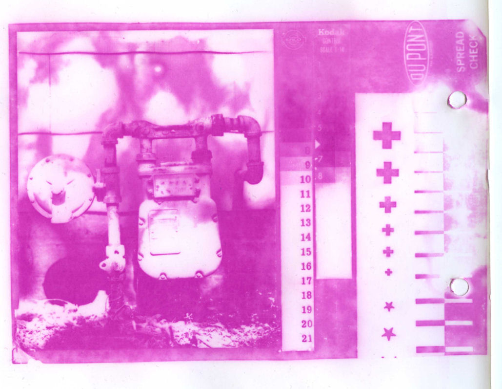

    Kodak Magenta on Kodabromide (F-2)
    Here is a test of Kodak magenta dye transferred to old fixed-out Kodabromide with an F-2 glossy surface.
    The matrix was 6% gelatin, 1% sorbitol on melinex and brush-sensitized at 5% potassium-dichromate. The matrix was dry, so it was briefly pre-soaked in cool water, then added to the dye bath at 20° for 5 minutes. It was then rinsed in a 10% acetic acid bath*.
    The Kodabromide was punched and soaked in cool water about 15 minutes prior to this, then squeegeed to the transferring board.
    The actual "rolling" of the matrix was done with a squeegee, but I need to get a brayer or a print roller. Thought about a rolling pin...
    You can see that there is bad transfer near the registration holes, this is due to my registration pins being inaccurately mounted, causing some buckling. (need to fix that)
    All in all I'm pretty pleased, just looking at it. It's the best image I've gotten yet with a dye, but it definitely illustrates what needs improving.
    * For one, the 10% a.a. rinse (Ive's recommendation) might have been excessively high, resulting in high contrast. Afterall, Kodak recommends 2 baths at 1%, adding acid in the 1st rinse to increase contrast.
    It pays to read up :wink:
    Ives speaks of the necessity for a 'tenuous' relief (read thin) in his patent that includes the claim for a light-restraining dye, a practice thereafter used in the industry. The relief needs to be thin to allow for flush contact between the matrix & transfer paper.
    I think I will include some yellow food dye in the next batch of matrix gelatin. As PE says above, the dye is tartrazine and I'll bet that's what the majority of yellow food colorings use anyways.
    Lastly, EK says that the quicker the print is dried, the sharper it is. I let this one air-dry after a wash in distilled water. Washing isn't recommended at all by Kodak, but it seems like you'd wanna wash the acid out?? IDK.
    Ok.. well I think the next logical thing to do is repeat this exact procedure but with Kodak Dye-Transfer paper. That'll give some idea of what mordants can do.

    Kodak Magenta on Kodak Dye-Transfer Paper
    Here is the latest test with the Kodak magenta dye, and this time transferred onto "official" dye transfer paper (designed and mordanted to accept dye images). I did two transfers, one with a 10% acetic acid rinse and another with a 3% acetic acid rinse.
    As you can see, the 3% is much, much better. Contrast has been improved in either case, and the sharpness is remarkably better than the fixed out Kodabromide.
    I did the 3% transfer 2nd; placing the matrix into a warm water bath after the 1st transfer and then into a cool water bath, then back into the dye for about 4 minutes.
    I can't tell if the increased density of the 3% transfer is due to an inconsistency in the dying, or virtue of the reduced acetic acid.
    As you can see, the image has a lot of blemishes, and a few strange anomalies. This is due in large part to the operator.. err.. and the fact that I'm using a squeegee instead of a roller. It shows that chemistry is not the only thing at play here, technique is very important.
    Going back to the test on Kodabromide paper, it should be noted that this was fixed in PhotoFormulary TF-5, which is a non-hardening fixer. I suspect that a hardening fixer would produce much better sharpness. However, I don't have a hardening fixer on hand, though I do have chrome alum. Any suggestions for a hardening bath?
  22. Photo Engineer
    Photo Engineer Subscriber
    Messages:
    27,531
    Joined:
    Apr 19, 2005
    Location:
    Rochester, NY
    Shooter:
    The anomalies appear to be either air or water bubbles trapped under between the Mat and the paper. You have to roll firmly with a squeeegee roller to prevent this, and you must use a flat level surface.
    PE
  23. OP
    holmburgers
    holmburgers Member
    Messages:
    4,492
    Joined:
    Aug 13, 2009
    Location:
    Rochester NY
    Shooter:
    I think you're absolutely right!
    During the 10 minute transfer, all I could think about was how terrible the "rolling" of the mat was. Fingers were crossed...
    By the way, looking back at my first transfer with the kodak magenta, one which I did not post and with which there was no rinse at all after the dying, the dmax is very strong. So!, it seems that the less acid present in the rinse (or none at all) the greater the density. I guess this makes sense if you consider that the acid might heighten the matrices affinity for the dye..??

    I'm coming in late, but this is fun stuff. I worked in dye transfer for many years and ran one of the last standing dye labs in NYC (Tartaro Color).
    I've read a lot of your posts, but haven't seen any mention of separation negs. Are you using digital negs or going old school? I know that pan masking and panchromatic lith film haven't been made for years, so if you are pursuing an analog method there are challenges.
    Also, in your last post I see you're having trouble rolling prints. The Warren Condit Company (Sandy Hook, CT.) made print rollers with a weighted steel bar over the roller to reduce shimmy. Also, the matrix was anchored to the transfer slab with register pins (I didn't see any mention of this in the posts I've read) which adds additional rolling stability.

    Hey Dewey2, awesome to have you join the fray. It'd be really interesting to hear more about your lab; history, technique, etc. When did you stop doing DT printing?
    Separation negs are at this moment, on the backburner and these tests that you're seeing are just from a b&w negative. To be honest, I have kind of a convoluted scheme for separations. The biggest problem is the expense of large film, particularly panchromatic film. The cheapest option is to use X-ray film, which is made in large sizes and can be had for a song. This film is orthochromatic though.
    So, that means there will have to be an intermediate step wherein I make the separations onto panchromatic film, 1:1, preferably by contact, but probably with a copy setup if I'm doing 35mm. If coming from a C-41 negative, then that's great; these separation positives can be projected onto the x-ray film. For E6 I'm planning to reversal process the panchromatic separations, and then project these onto the x-ray film.
    Masking can then be achieved rather effortlessly since there will be 3 enlarged negatives. Creating a positive mask would only require contact printing onto another sheet of the x-ray film from the desired separation and reducing exposure or reducing density in farmer's reducer, for instance.
    Now.... anyone in their right mind would probably use digital negs, but I'm gonna give this procedure a go and see what it can do.
    I do plan to get a roller, though the Condit stuff is so expensive, I just can't justify the cost. A 12" Kodak print roller might be the next best option.
    You can see the registration holes in the paper, but I need to clamp my registration board onto the table next time. I'm using a 2-hole office punch for that.

    My advice is to avoid making positives from a c-41 neg. It's strictly hit-and-miss with exposure and development. I think a fun first approach would be in-camera seps. Use 29, 61 and 47b Kodak gel filters on (ideally) a sheet film camera and shoot three exposures of a still subject. You'll develop the red and green about the same and the blue will need extra development. With sheet film you can process all 3 sheets at once in a tray. You clip one corner on the magenta neg and two corners on the yellow so you can ID them while processing in the dark. You can postmask the negs for highlights or for shadow detail or just go with them naked.
    Contact print them on your matrix film and you can even roll them in register by eye. Lay down the yellow first, then magenta, then cyan. Use a mylar slip sheet and a lupe to register before applying roller pressure.
    I had a dye lab in Houston and later moved to NYC to work for Frank Tartaro - something of a legend in the business. I think we rolled our last print in 1990, but prior to that we made prints for Robert Mapplethorpe, Avedon, Eggleston, Penn and a lot of boring ad stuff.
    It's a beautiful and fascinating process, but honestly, I'm very impressed with where ink jet printing is at now. A dye took a full day to produce in a professional lab - an Epson takes 10 minutes and takes up a couple of square feet of real estate.
