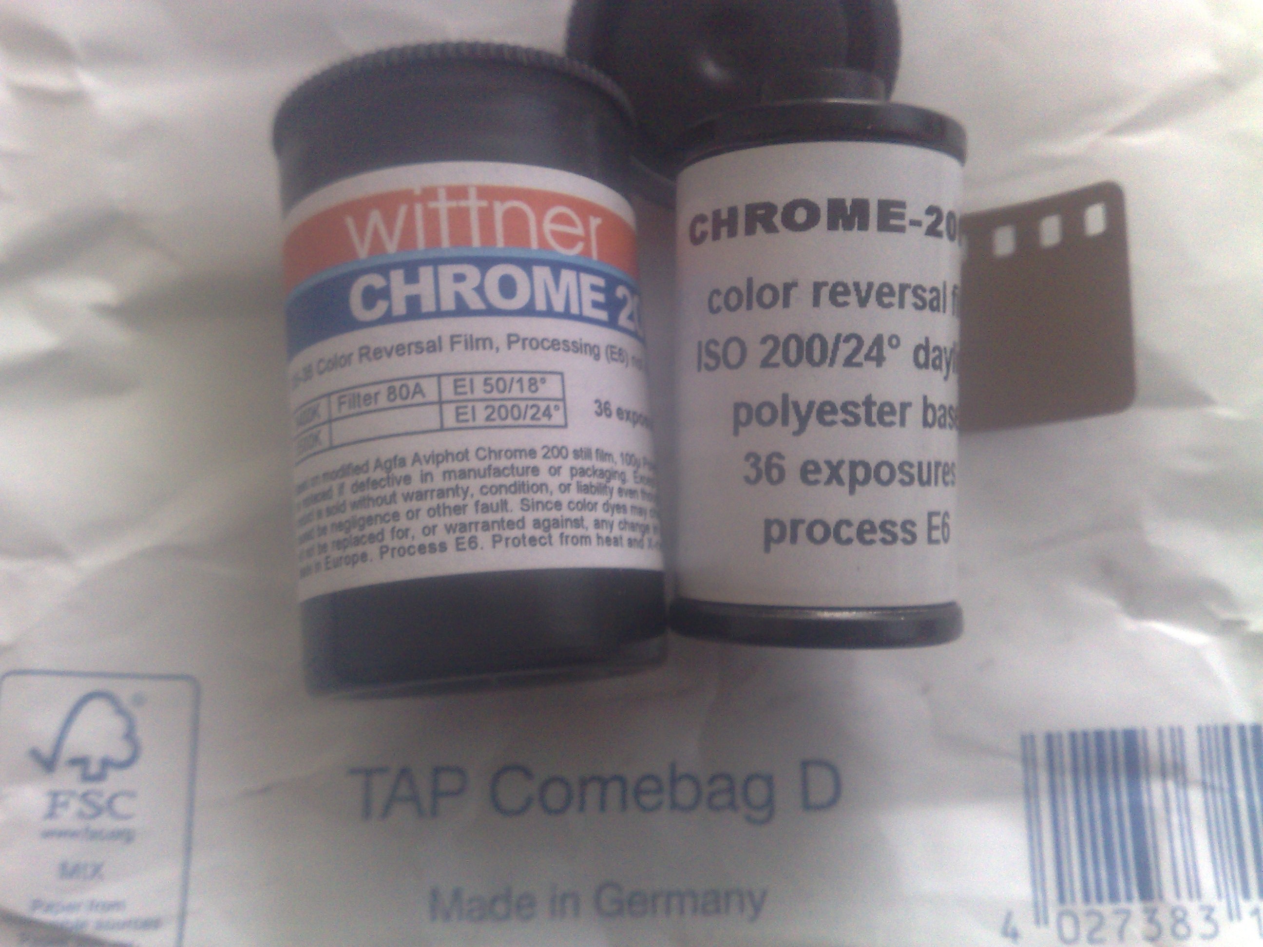

Wittner Chrome 200D / AGFA Aviphot is now available at Wittner in 35mm canisters!
Prices:
from 1 pcs. (4.16 EUR netto) 4.95 EUR brutto
from 5 pcs. (3.32 EUR netto) 3.95 EUR brutto
from 10 pcs. (2.93 EUR netto) 3.49 EUR brutto
from 20 pcs. (2.48 EUR netto) 2.95 EUR brutto
Netto = without VAT, brutto = with German VAT 19%.
Yes it is available thanks to the combined effort on this forum and a few emails exchanged with them!
My 2 rolls arrived today and i will share the results once i get it processed.
