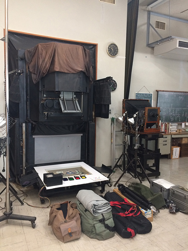

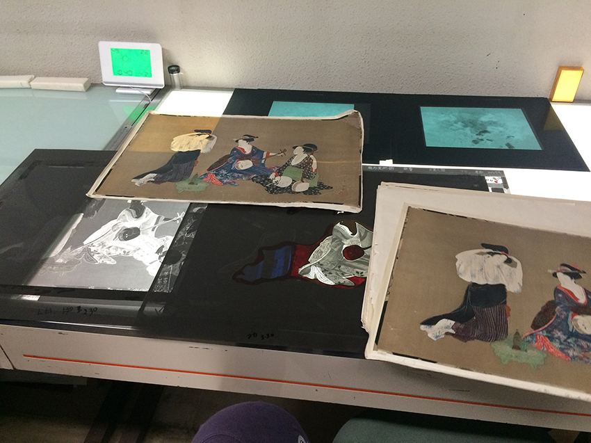

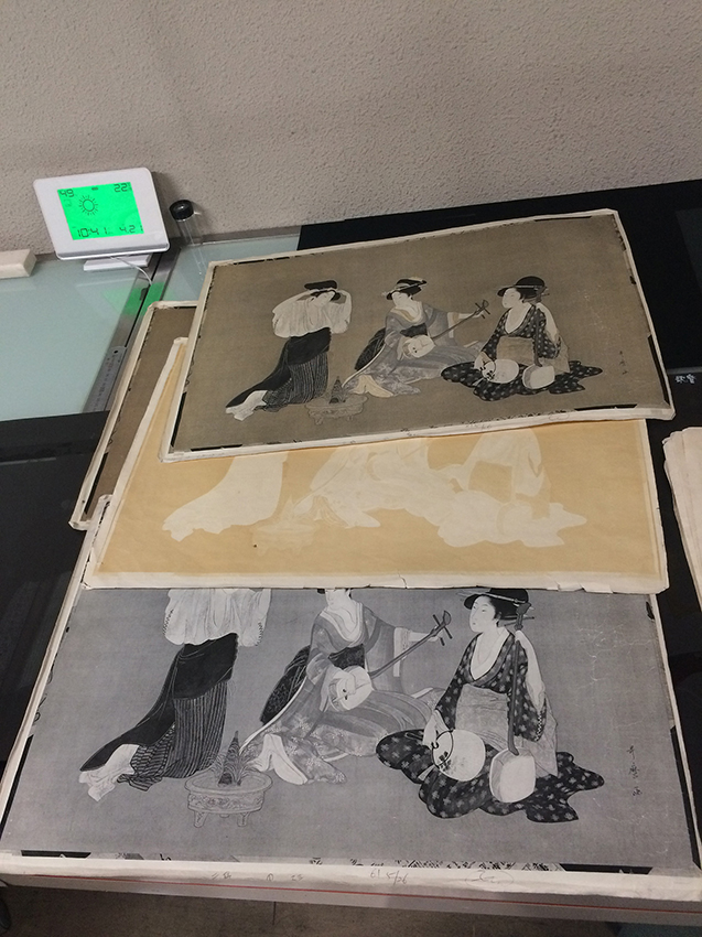

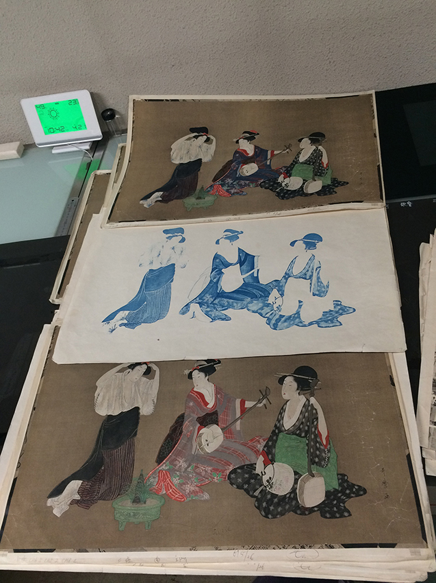

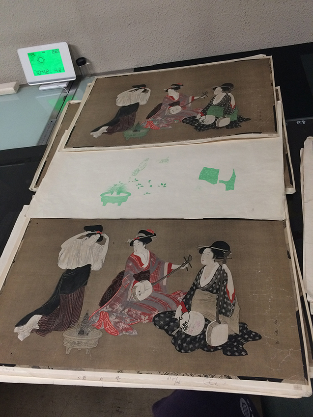

Thanks for the link. There are only 2 remaining collotype printers left in the world, both of the here in Japan. A small one in Osaka does only black and white, the other here (Benrido) in Kyoto does colour. They often do official reproductions of art inside temples, castles, and other historic places. I did a workshop with them back in April to make collotypes of my own images, and of course got a tour of the building and how do they make collotypes on the dedicated presses. It's an incredible amount of work - here are a few photos from that day (part 1). They have to make masks for every single colour:

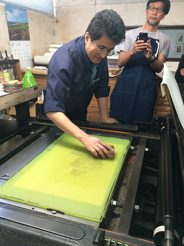

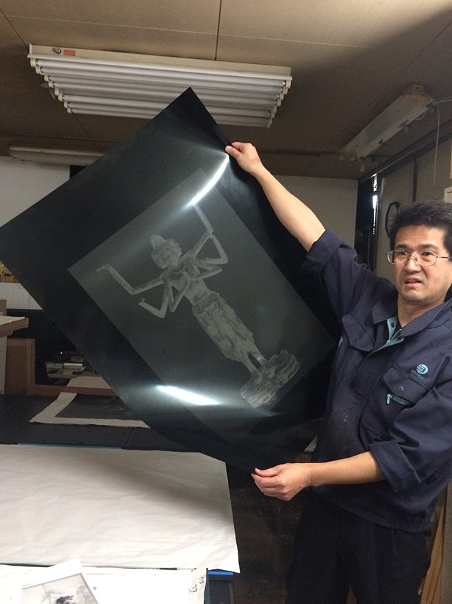

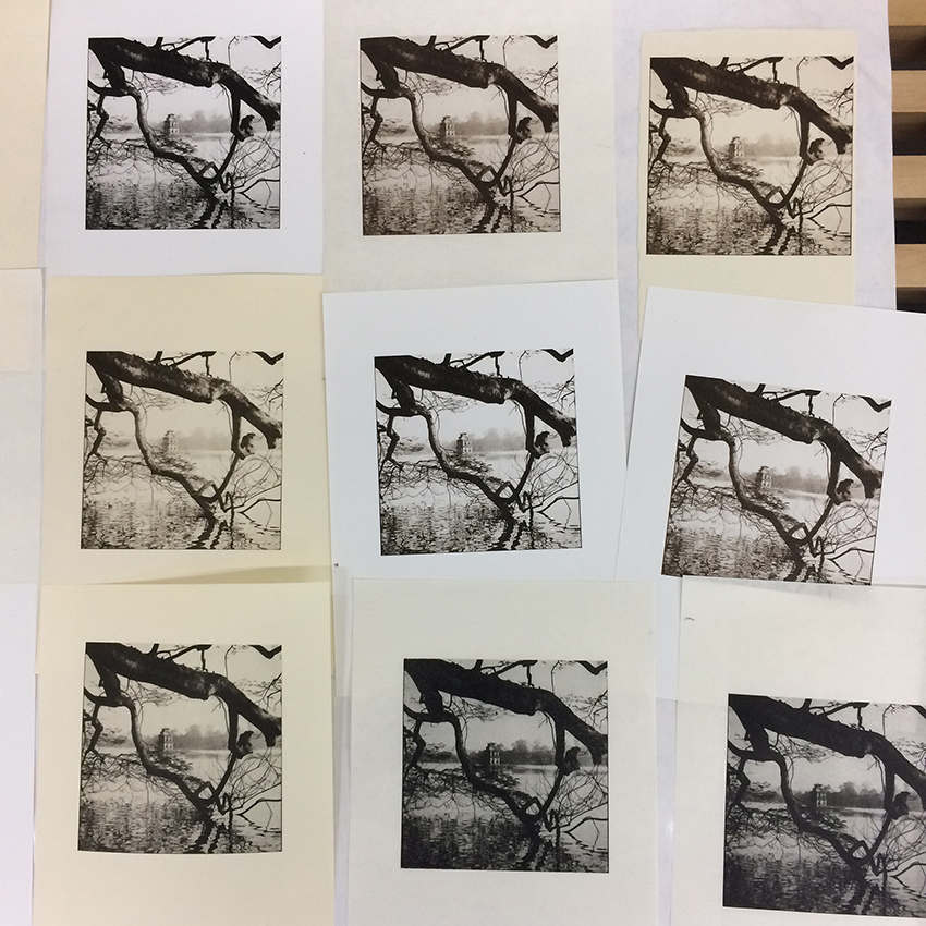

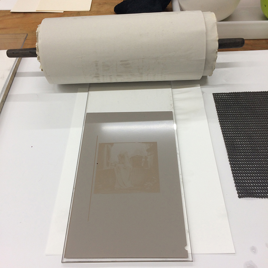

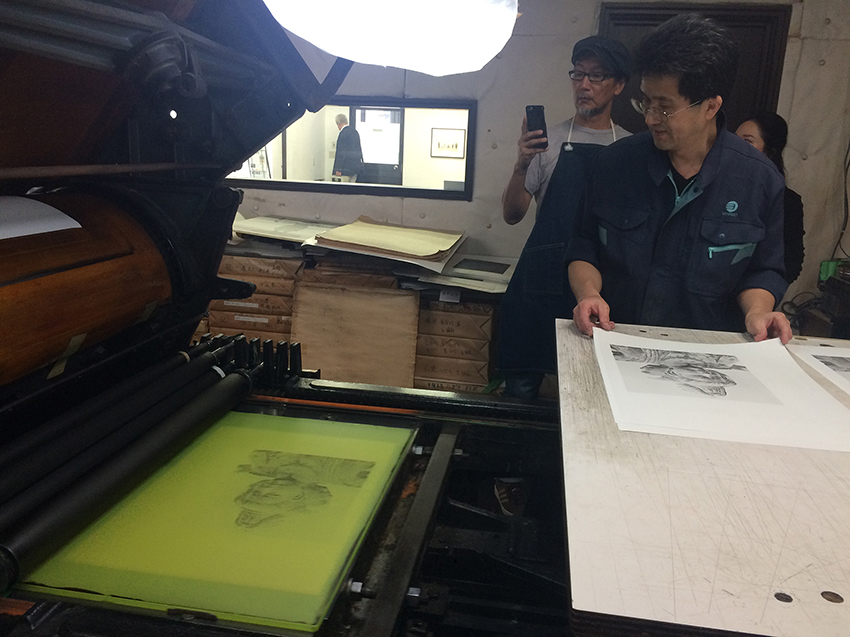

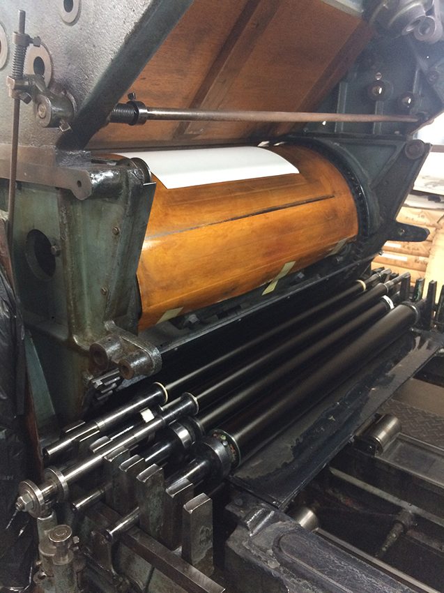

Here are a few more. They do have some ultra large format cameras and in-house darkroom to take and develop photos, but they also use digital negs (as they did for the workshop I was in). After wetting and inking the emulsion it goes through the press, with two people working it - one person on one side to ink, the other person to pull the prints off the press. The last 2 photos show my own negative/matrix with a dry-roller (to remove excess moisture) - they've been using the same style dry roller for over 100 years. The other photo is a collection of images from the same neg using different papers and ink. Trying to match the original (a lith print) required using varying mixes of black and brown inks added separately, one on top of the other (brown over black if I remember correctly).
