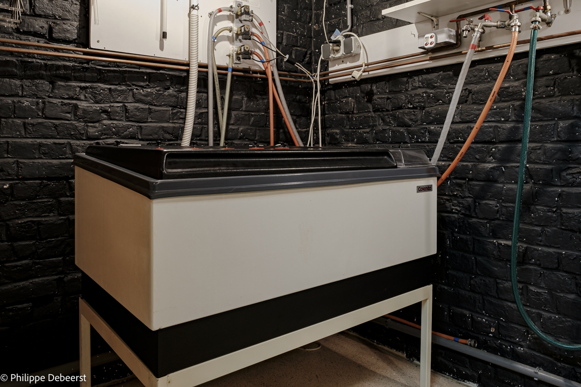

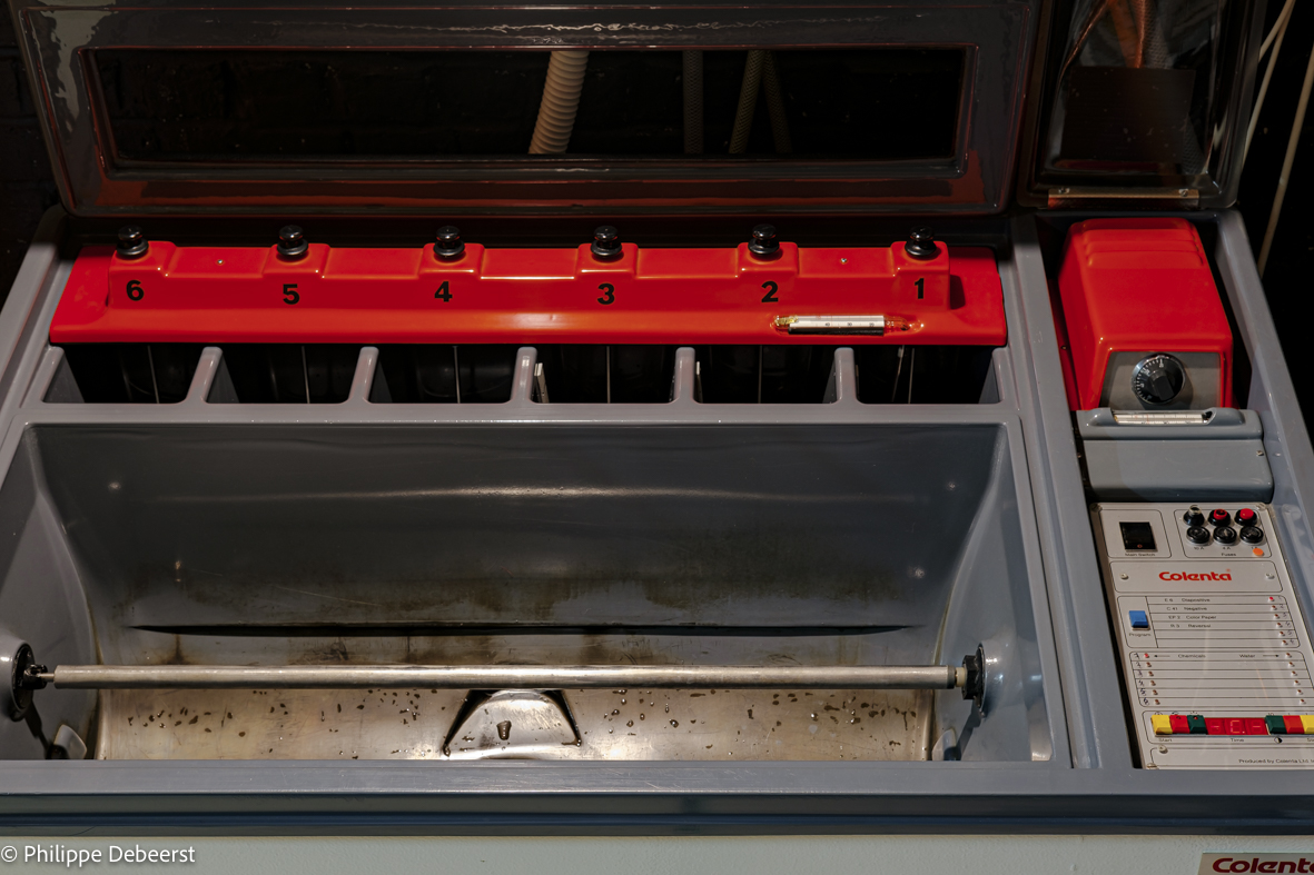

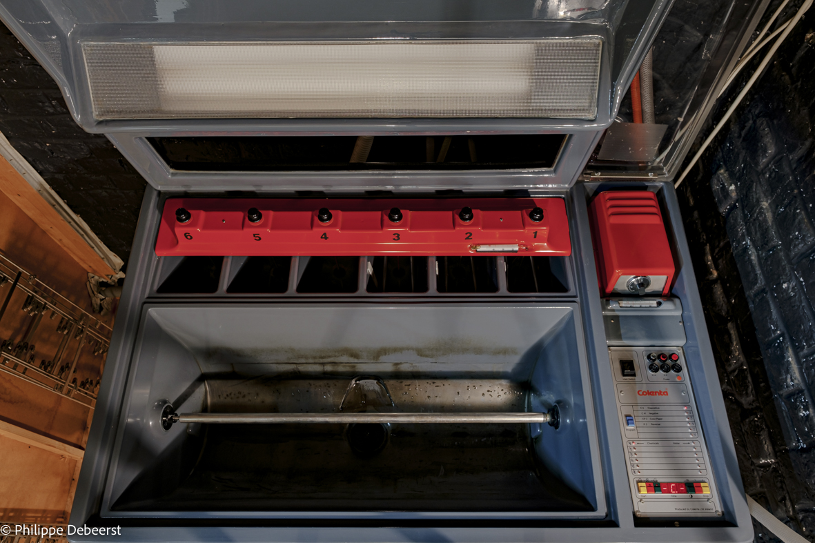

For sale: a well looked after COLENTA AT 60 DEVELOPING MACHINE.
See the pictures for more comprehensive information, but here a short description of the set.
A you can see, it has been well looked after as it was an important part of my bread and butter, and it is still in working order…
I tested the Colenta by have it run a complete process several times, although only with water, but the timing and temperature were spot on, this is of paramout importance for a processing machine!
In the photo’s you can still see the waterspots of the testing.

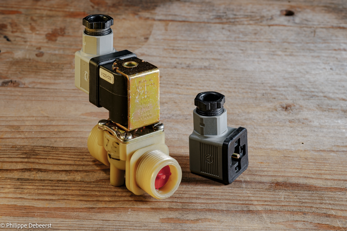

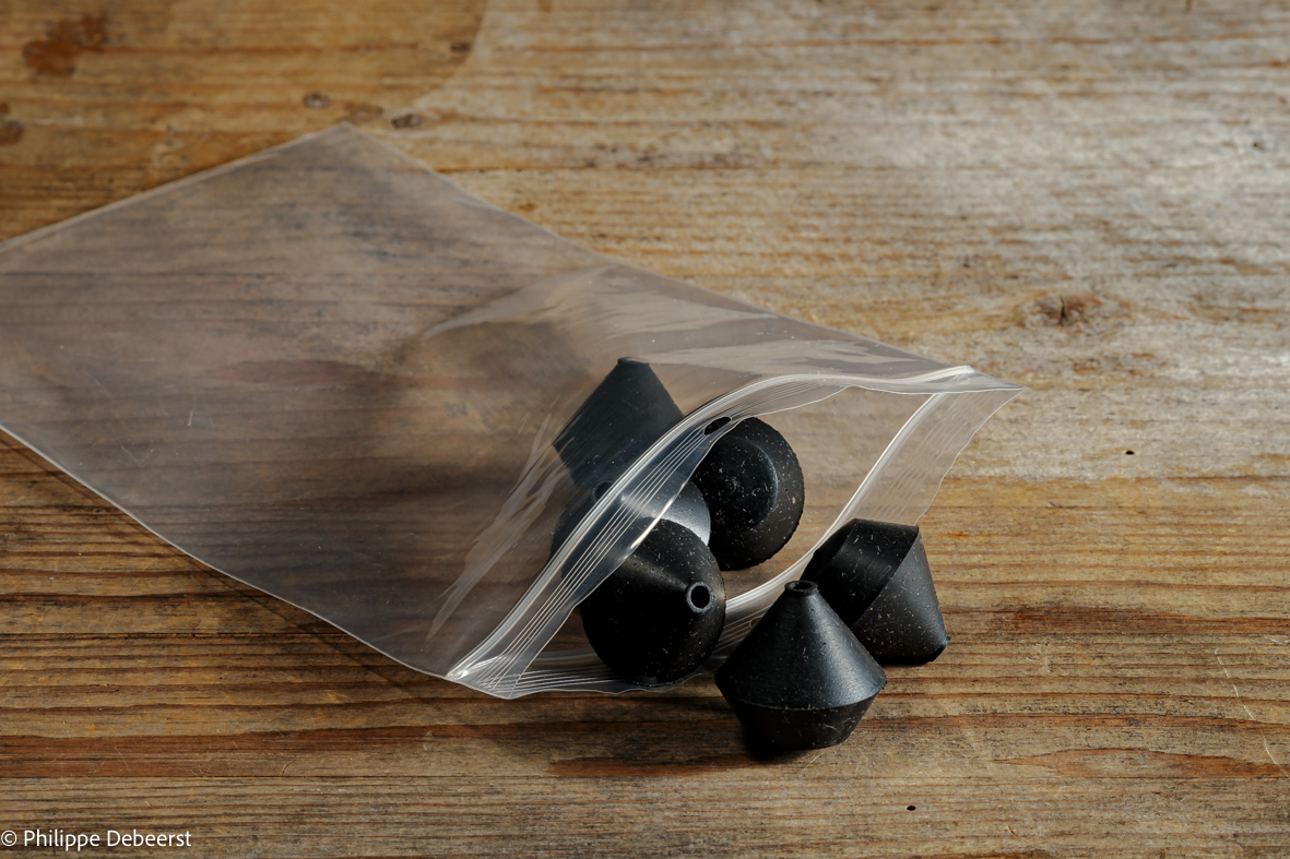

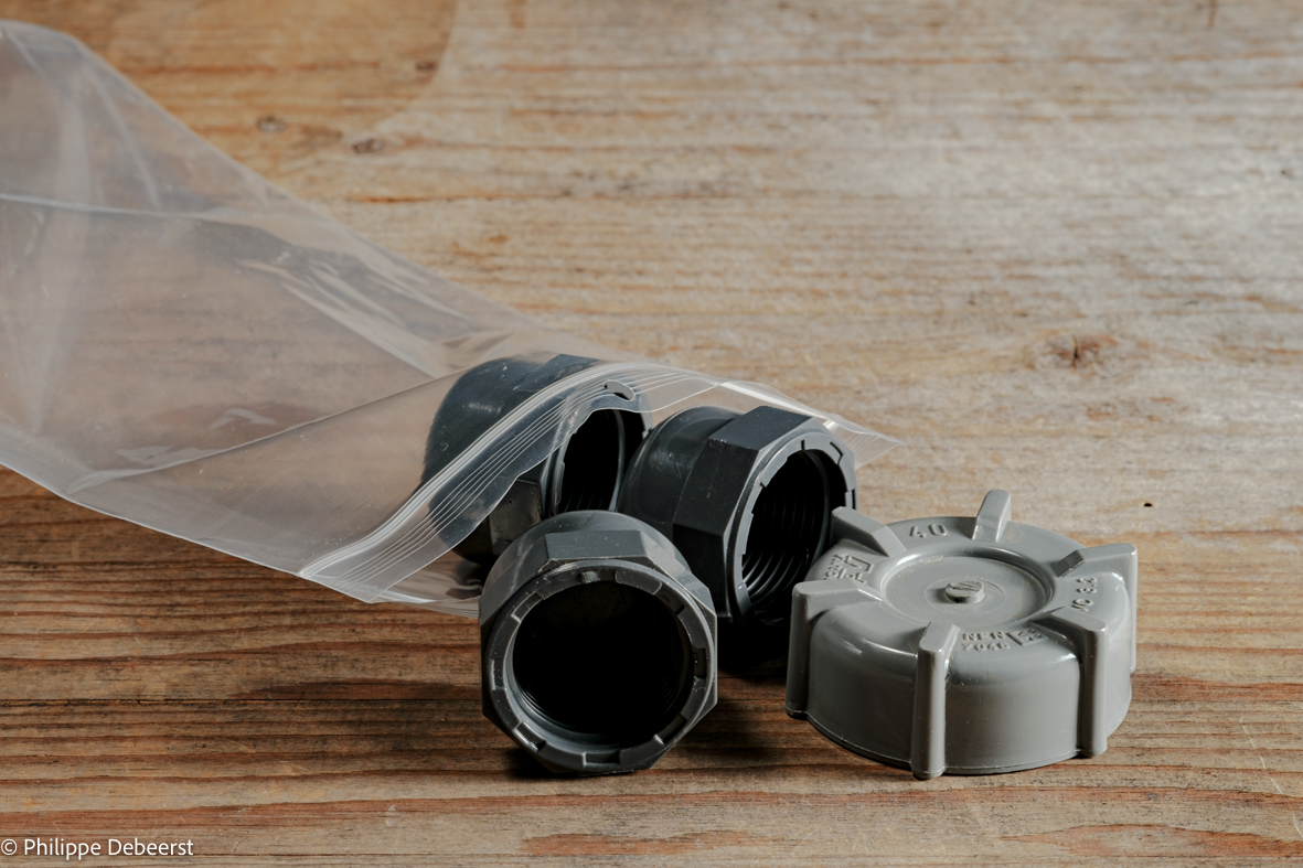

There are a few spare parts, amongst them, a whole set of rubber stops as a replacement for the ones in the product tanks, and one good working spare electromagnetic valve.
All the rubbers are still flexible, thus not hardened nor brittle!

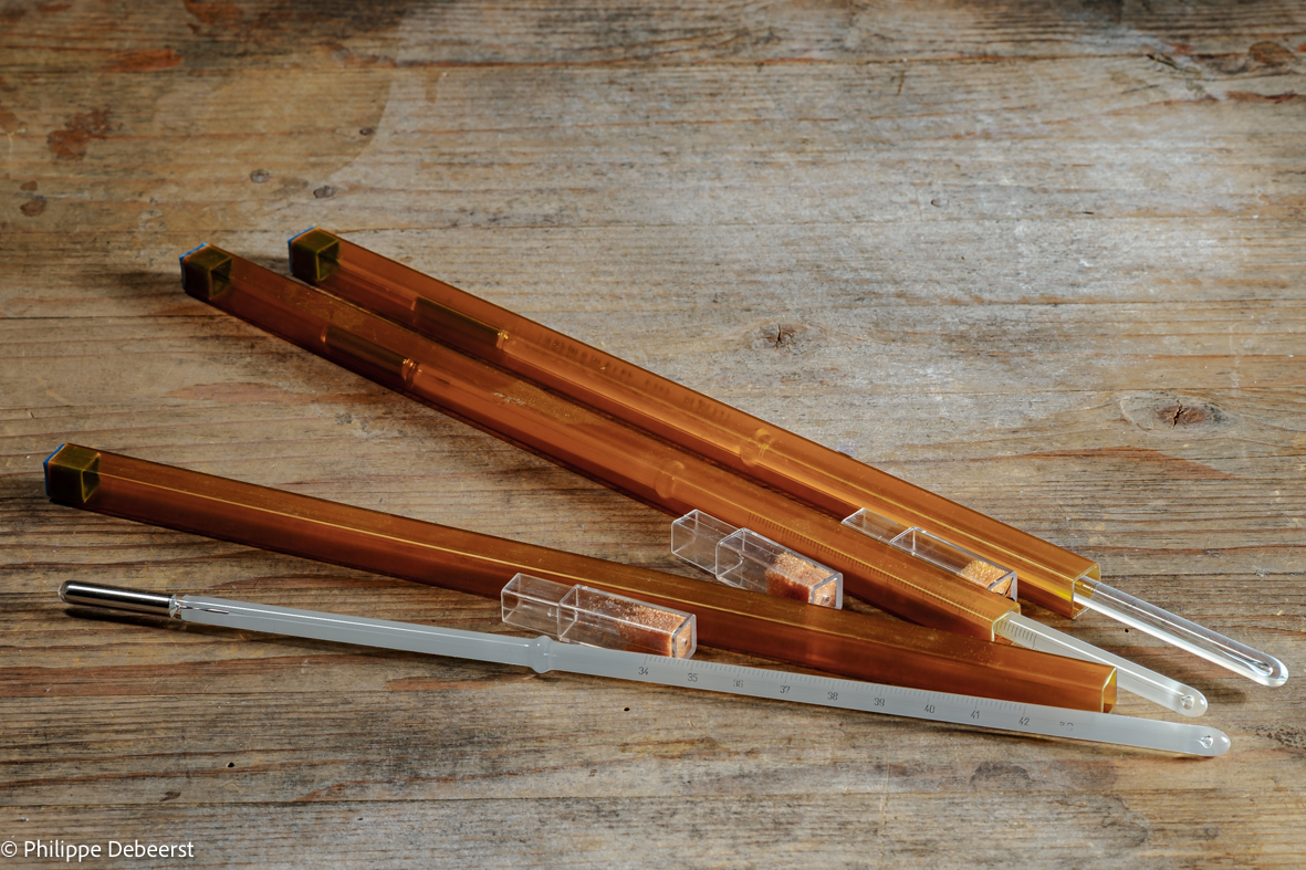

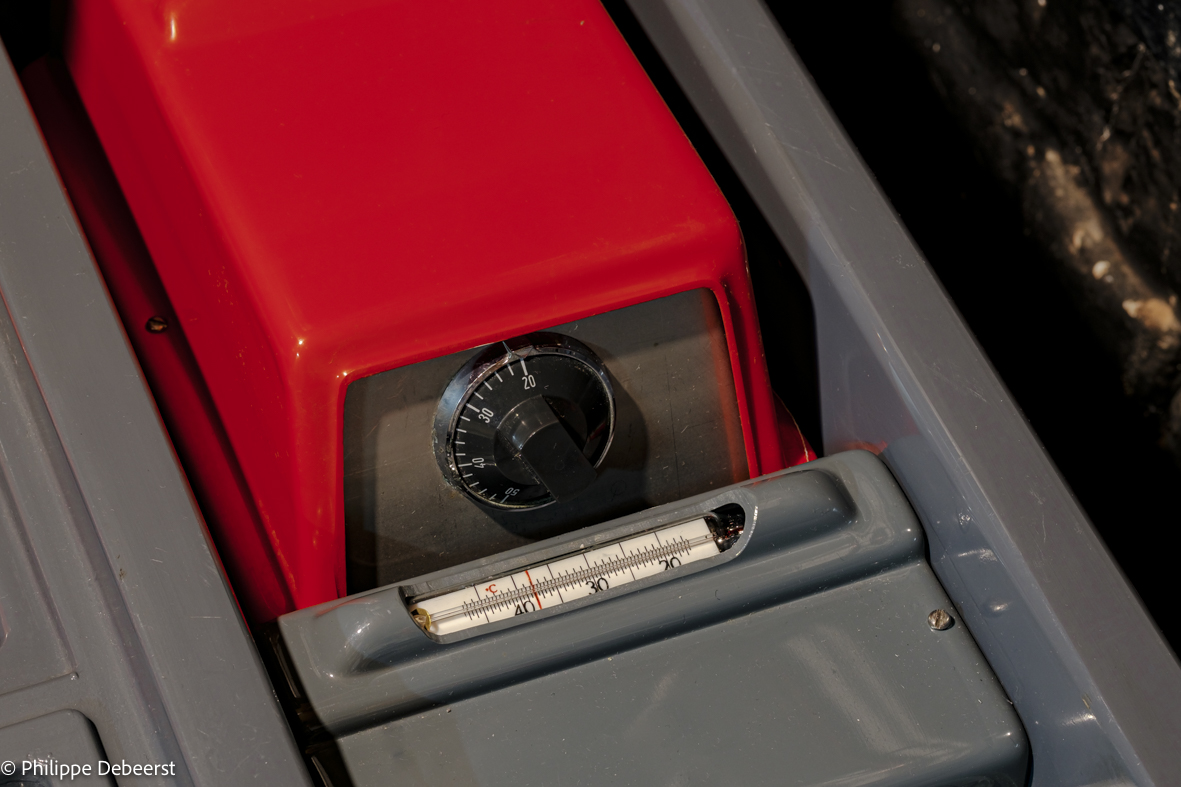

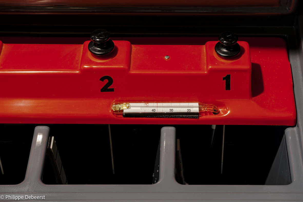

I add tree specially made thermometers, two precisely measuring between 34°C and 42°C, to be hang in the two developer tanks, these ware very useful for the original E-6 process.
The third one is to be used precisely at lower temperatures for B&W.

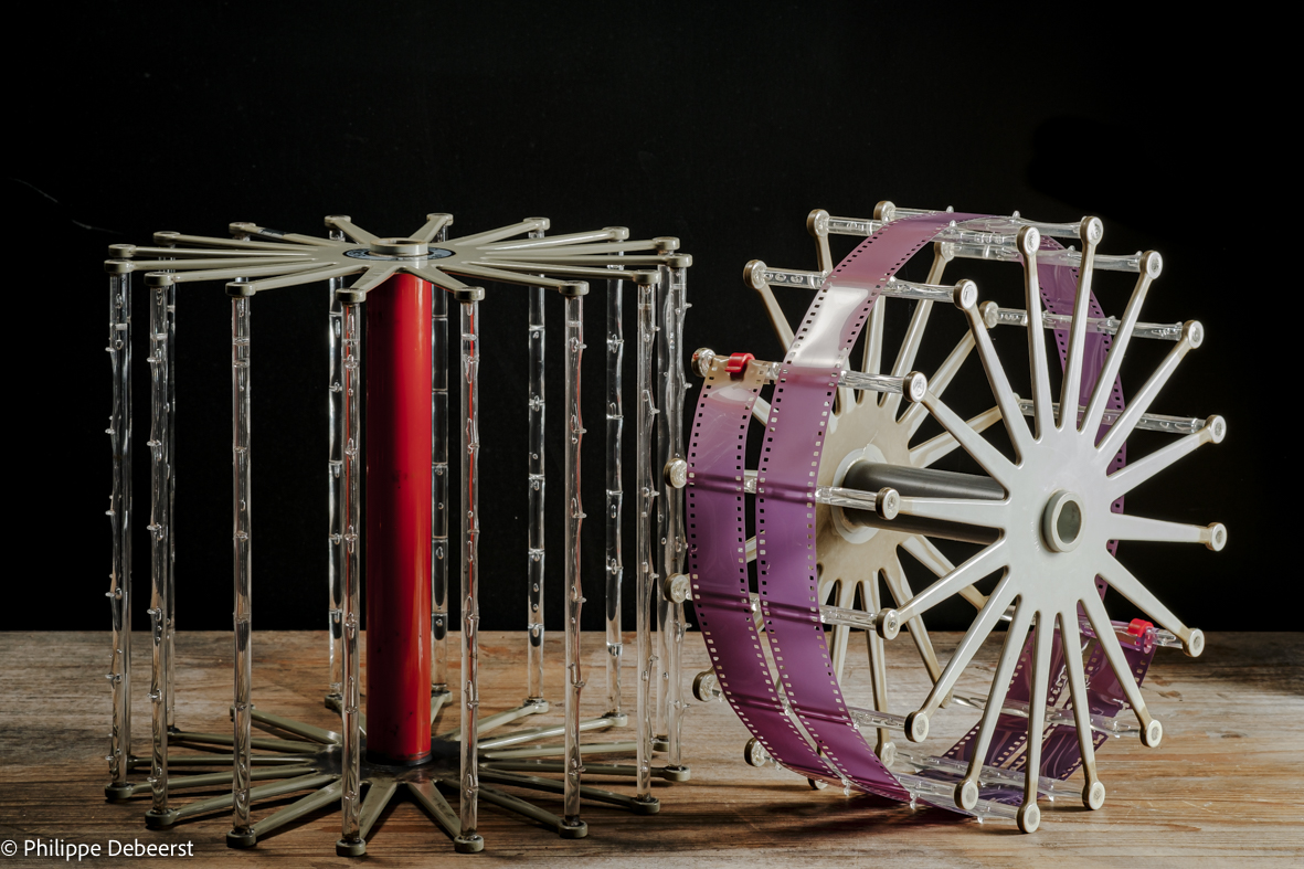

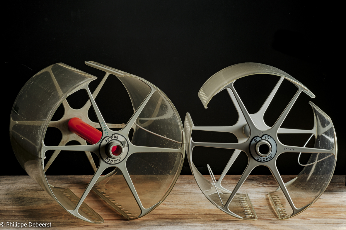

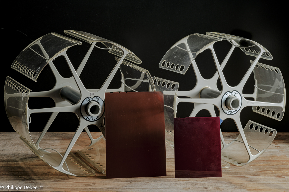

There are a whole lot of film reels for a wide array of film formats, ranging from 35mm film over 120 roll-film till 4”x5”, 13x18cm, 18x24cm, 8”x10” and 24x30cm sheet film.
I mounted some film on them to show the real dimensions.

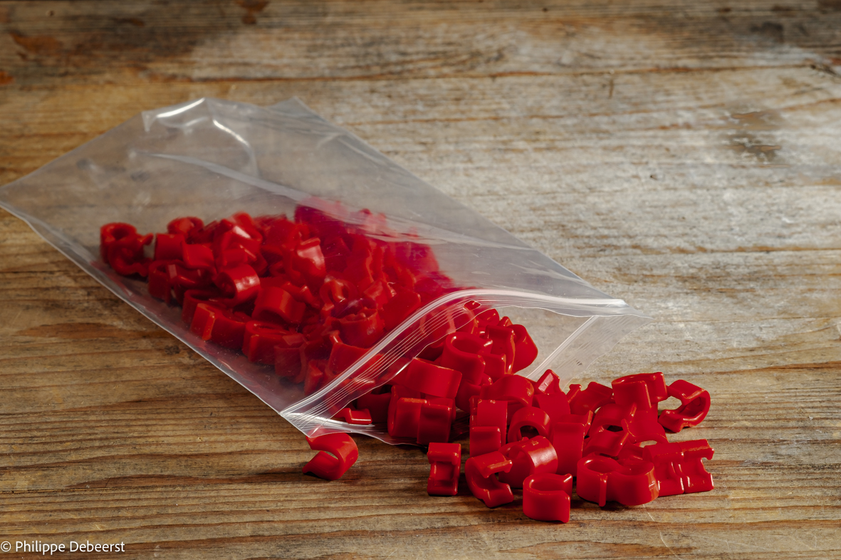

A whole lot of the famous ‘red clips’ to attach the film are present too.

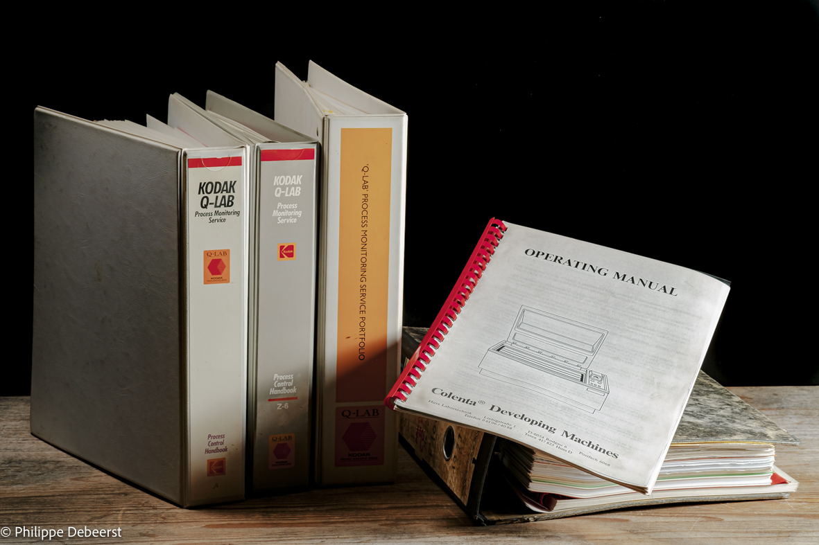

All the needed documentation, user manual, wiring diagram, connection diagram, some personal notes and more are present.
Everything is present for a good takeoff…
As you can see it’s a whole load and it as only to be sold in the EEC.
Price for the undivided lot: € 2 500,- excl. shipping.
REDUCED PRICE: € 1 500.- (PayPal) plus shipping
I will do shipping myself in a radius of 85km and will be free, for longer distances can be negotiated.

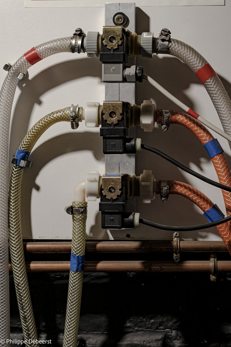

View attachment 297907 I want € 2500,- for the lot, undivided.
I forgot the list of the different reels, here it is:
List with all the different reels, sizes and numbers:
Reels for 120 rollfilms:
- reels to mount two roll films: 2 pcs
- reels to mount four roll films: 4 pcs
Reels for 35mm/36exp. film:
- reels to mount one film: 4 pcs
- reels to mount two films: 6 pcs
Reels for 4”x5” sheet film:
- to mount 6 sheets: 6 pcs
Reels for 13x18cm sheet film:
- to mount 6 sheets: 3 pcs
Reels for 8”x10” sheet film:
- to mount 3 sheets: 5 pcs
Reels for 18x24cm scheet film (= DIN version of the 8”x10” sheet):
- to mount 3 sheets: 2 pcs
Reels for 24x30cm sheet film:
- to mount 2 sheets: 2 pcs

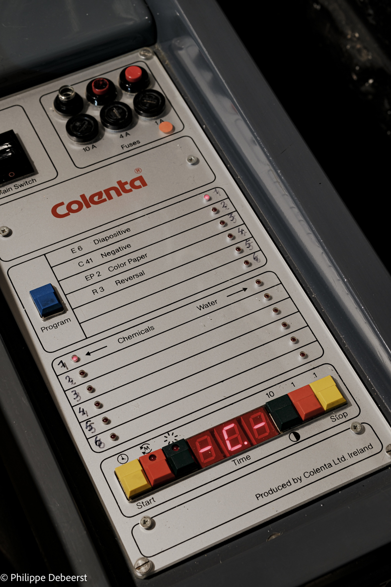

THIS IS THE OUTMOST FLEXIBLE DEVELOPING MACHINE EVER BUILT, IT CAN PROCESS ALL THE DEVELOPING METHODS YOU WANT, SIMPLY PROGRAM THE MICROPROCESSOR!
