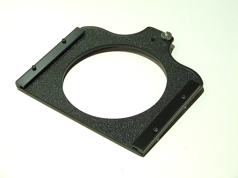

With lamp behavior like that, split grade printing was nearly impossible to refine. However, a simple Ilford MG filter holder solved the problem, eliminating the need for two exposures.
That is a very nice filterholder. Is this DIY or are these availabe. Never seen it before.
