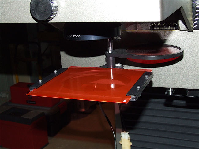

The thermostat heater in my 1414 kept the housing about 39C. It did get hotter when the lamp was on and dropped 1/2 stop output after 5 minutes of continuous lamp ON time.
With lamp behavior like that, split grade printing was nearly impossible to refine. However, a simple Ilford MG filter holder solved the problem, eliminating the need for two exposures.

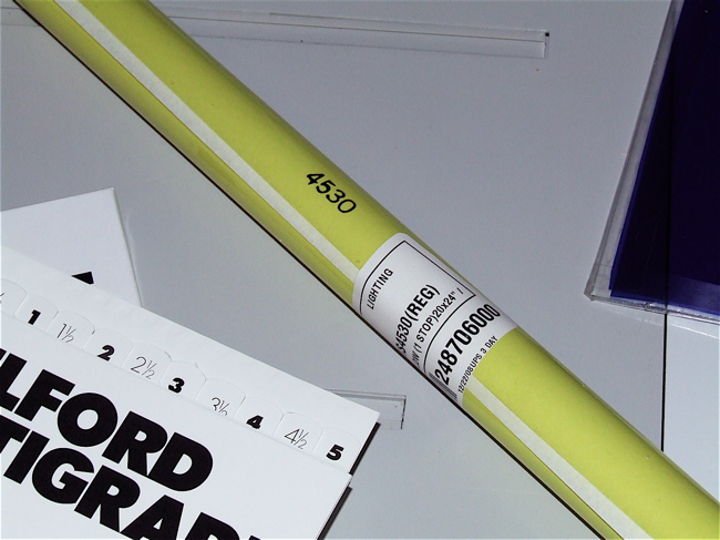

I haven't done split grading with a cold light head before, but I've heard the bluish light is not fully compatible with VC paper. Isn't VC paper's sensitivity made for tungsten 3200°K light? Maybe you should switch over to a tungsten bulb head?
Depending on the cold light lamp type, the Ilford filter set may lump the contrast range toward the high contrast end (that is #3 not much different from #5). This can be somewhat remedied by a Yellow filter.

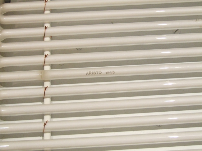

In terms of split grade, two-exposure printing. I got a range of ISO(R) from 45 to 190. Emphasis on the blue end of the spectrum requires a certain precision in determining the blue exposure time. That is, small changes in blue exposure can have big effects. It also follows, that small changes in cold light output during the blue exposure, can have very noticeable effects when comparing test prints to final prints (where is the 'knocking head on wall' emoticon...)
